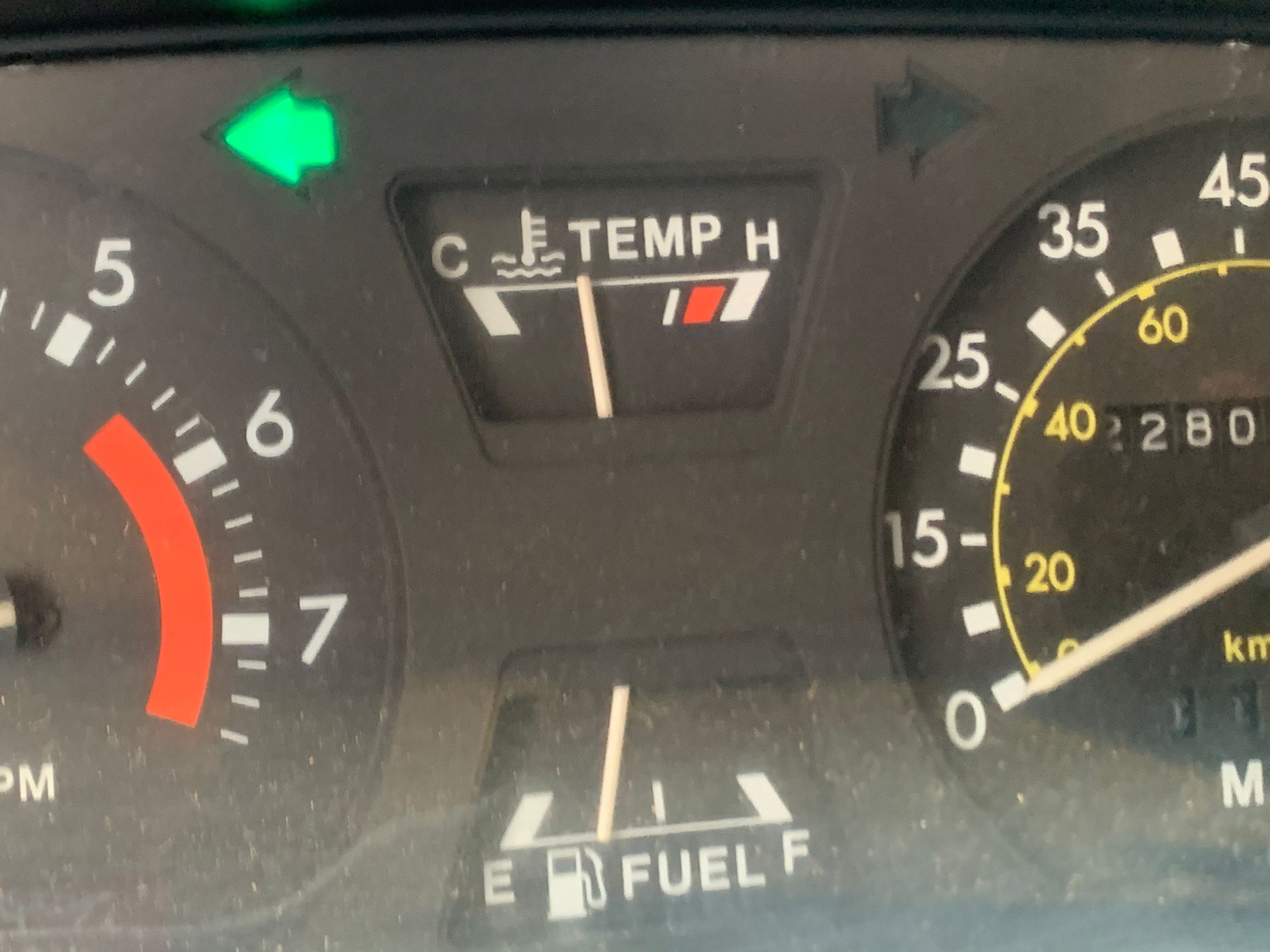

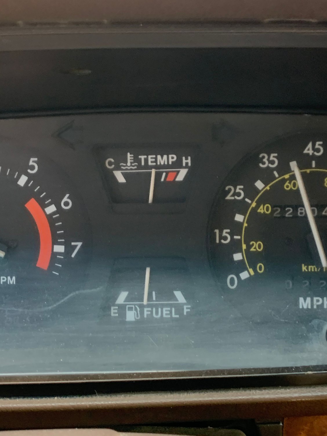

Gauge
what it showed today on freeway.
city driving
