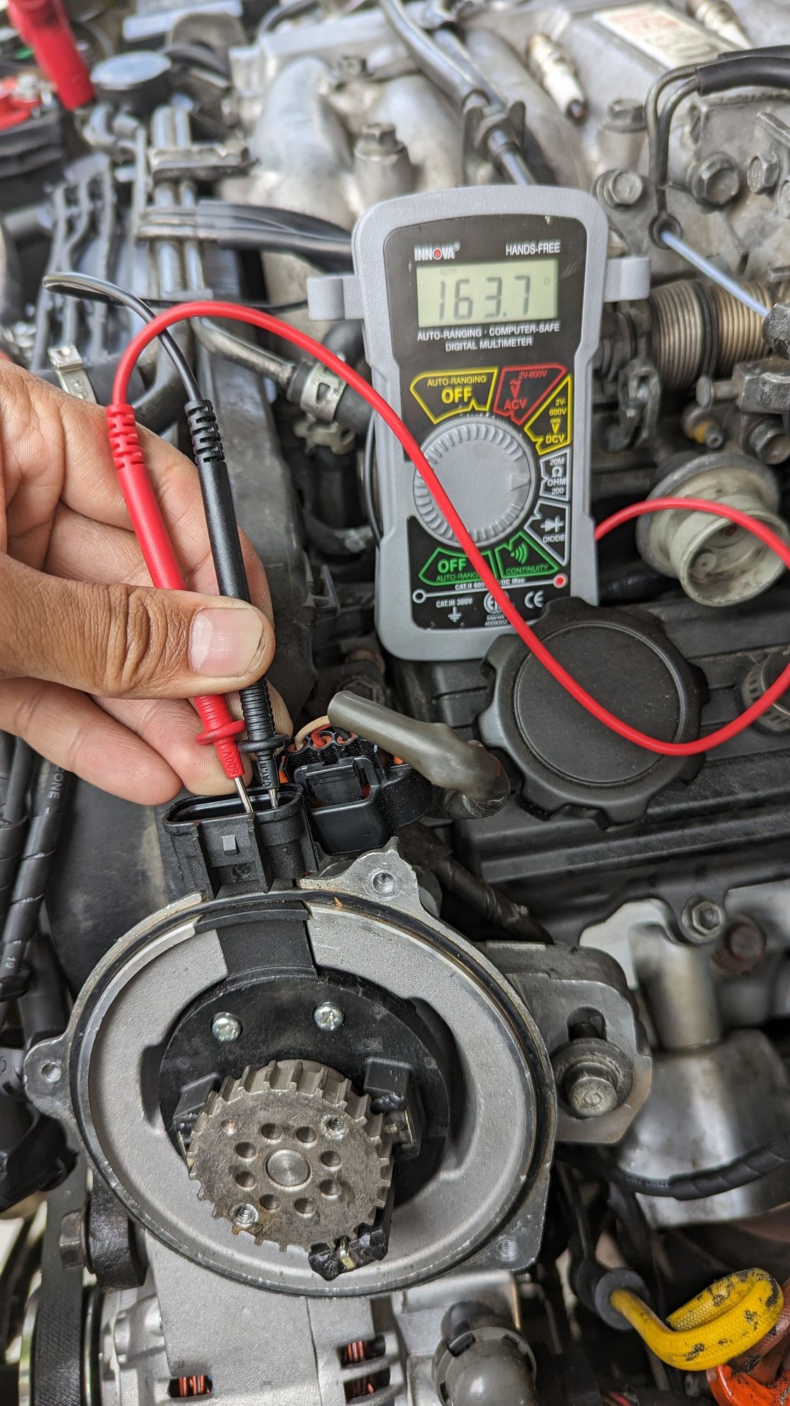

As the title says, 2nd gen 4runner 3VZE engine. (I will be attaching photos so you guys can verify I did the checks right. I need all the help I can get.)

Next thing, went back to the distributor, checked cap and rotor and gear. All good, just some normal wear, nothing out of the ordinary. Checked the specs in respect to the FSM. ONLY THING, air gap, less than .2mm! All resistances checked out though so I'll consider that okay.

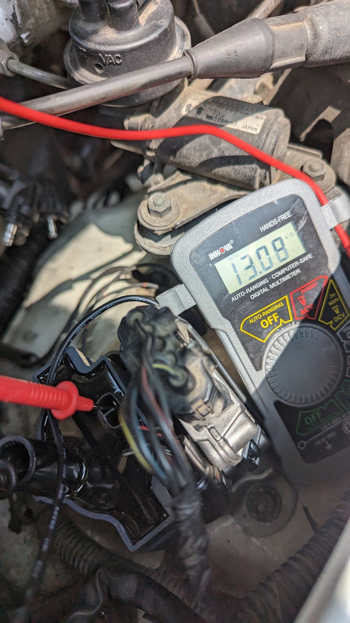

Next, Checked Coil to Dizzy wire, within spec. (5.7k ohms) Still basically brand new so I'm not surprised.
Next, I checked the Coil, again, within spec.

Next, I checked the IGF and IGT wires going from the Igniter to the ECM. 1ohm or less on both wires. I DID FIND continuity going from IGF going to the ECM but only when plugged into the ECM and when the key is in the ON position!!!
Otherwise, when I unplugged it from the ECM there was NO continuity and good Ohm for both wires!!

Distributor to Coil wire.
Distributor Checks
Distributor Checks
Distributor Checks
Coil checks
Coil Checks
