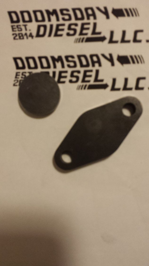

Next is my EGR delete. You can reuse stock hardware for this part. The exhaust manifold plug is welded on. Preheat is required to prevent cracking here. This kit is $20.

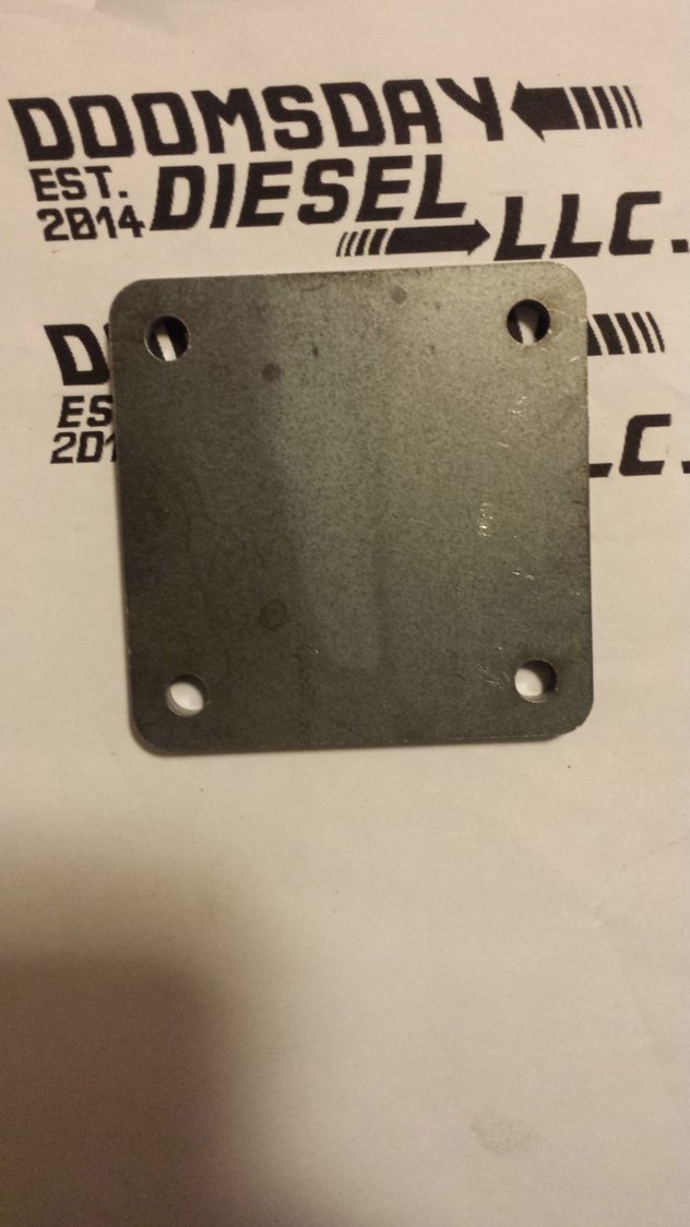

Next up is my hydraulic pump block off plate for all you TD wagon owners. This kit will come with hardware. You have your choice of using a stock gasket or RTV to seal it, but I won't include that. This kit is also $20.

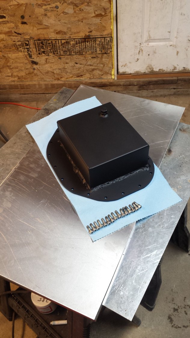

And last but not least, my custom oil pan. Constructed with a 14ga tig welded pan, which is mig welded to a 1/4" flange, this pan is sure to hold up on the trail, and serve a long life without leaking thanks to the warp-proof flange. The stock Mercedes drain bolt can be reused thanks to the proper nut being welded to the pan. This will also allow you to get all the oil out of the pan without removing it. Slight modification of the crankcase is required. The pan comes with new stainless hardware to prevent galvanic corrosion. You provide the gasket. Pans are $150.

I just wanted to post some updated pictures of my oil pan and hydraulic pump block-off plate, as well as.....

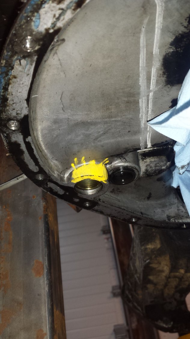

Oil Pan Installation Instructions
I thought I'd post instructions here for those who want hi-res pics.
When you go install your new oil pan, you must first clearance the drain port for the turbo, or it will be sealed off and chaos will ensue. To match or go past the volume of the turbo feed line, you should grind out an area of at least 1" x .25". Feel free to take more out, but use this as a minimum to avoid oil back pressure in the turbo.
I simply used a paint marker to mark the area I wanted to take out, then plugged the motor up tight with towels to avoid getting contaminants in it. I used an angle grinder to make my mod. A dremmel would give to much more control. Just don't nick the oil pan sealing surface!
I then used a can of brake parts cleaner to get the remnant grinding dust out of the crank case. After installing the pan, I poured 2 gallons of diesel into the crankcase. You won't believe the crud that you'll get out of your engines. I let mine sit over night to help break down the carbon. This is similar to sea foamimg your oil prior to an oil change, but much more effective, and much cheaper with fuel prices right now. Years later, I will read this post and cry as I pump $7 diesel...
That's it! That's the only mod required for this pan. Don't over-do it when torquing the pan bolts. It's not hard to strip the aluminium crankcase threads!!

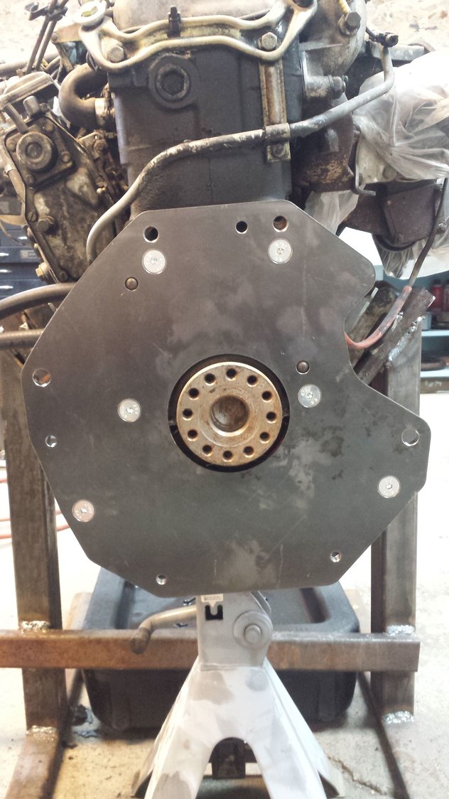

I've made and tested 2 adapter plates for the OM617 to R150F. I am now making a large production run of them, anticipated to be done and ready for shipment by Friday the 19th. This kit includes a steel adapter plate, steel pilot bearing adapter, and an Oilite bushing, as well as all necessary hardware, a starter spacer, and of course instructions and my full support. I am also including my own flywheel bolts and new dowel pins, as I have found the dowel pins in the V6 nearly impossible to remove without ruining them. This kit costs $460 + shipping.
For $590 you can upgrade to receive a brand new flywheel with the Mercedes pattern machined, ready to bolt on.

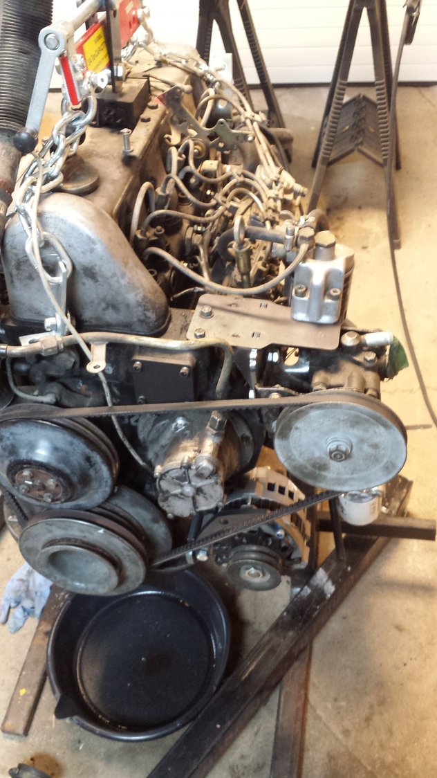

Power Steering Adapter Bracket
Power steering adapters for 22R/22RE power steering pumps and Trail Gear pumps are now avilable for $75. Include mounting hardware. Belt part numbers to come soon. Tensioning must be performed by A/C compressor or alternator.
Bracket has weld nuts for ease of installation. Contains mounting spot for fuel filter, as well as oil dipstick isolator.
