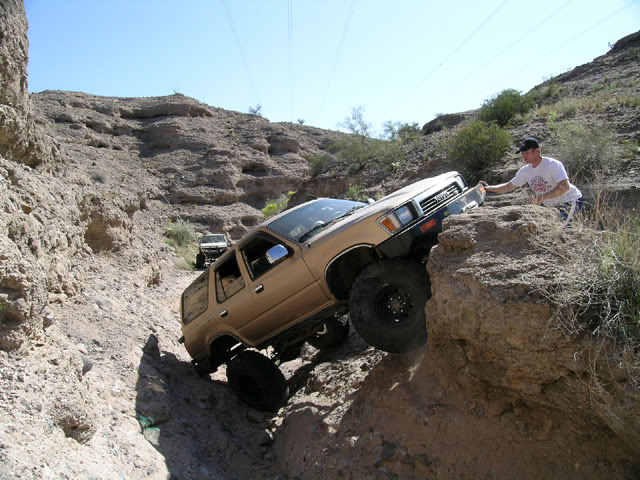

This is one example of an obstacle where I go "uberlow". It would have been very difficult if not near impossible to clean it with the stock gearing and a 5spd. Would have to go through to quick. You can see the dust coming off the front PS tire. That's because the line is to tight to turn, and you have to bump and slip past that knob. "Uberlow" let's me mess around, get things just right and comfortably crawl out even lifting a wheel.
Not trying to brag, plenty of guys here wheel stuff at this level and much harder. Just putting up an example of when "uberlow" really works for me and the types of obstacles you should be looking at tackling before investing in duals (or SAS for that matter
