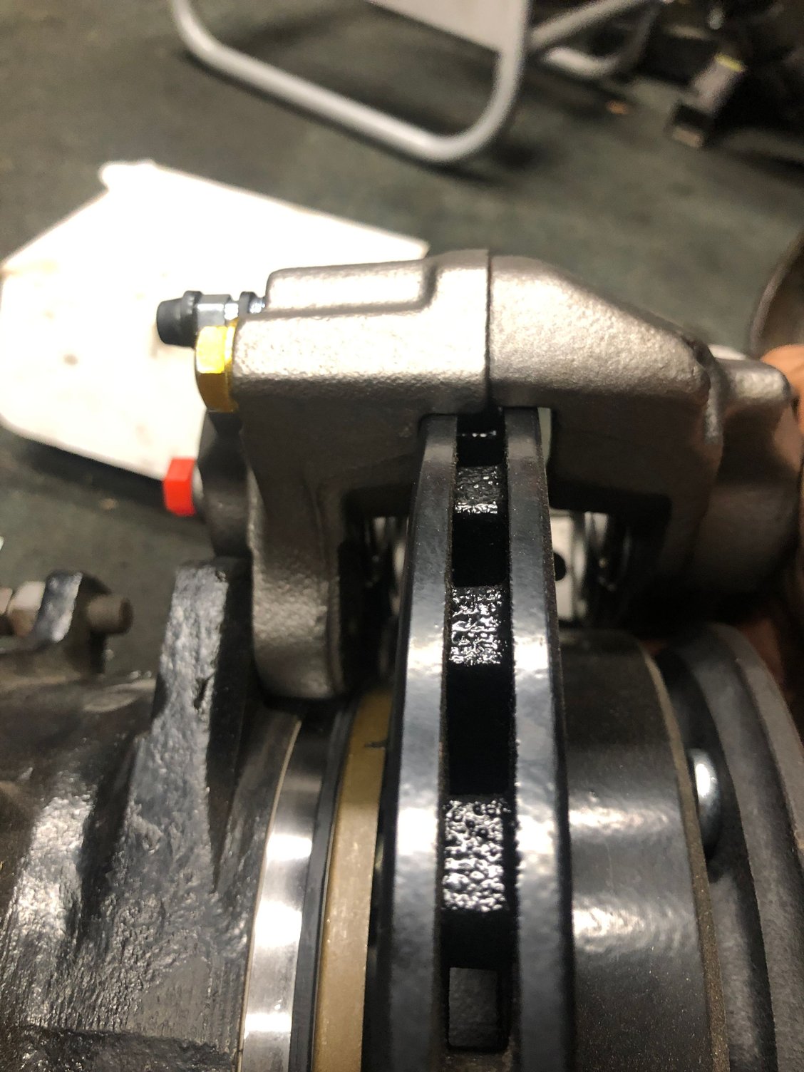

Ok I'm sure I'm missing something stupid. There's no clearance between rotors and caliper. No one mentions having to clearance inside of caliper or machine down mounting ear. Am I doing this wrong and should be using Tacoma rotors?
80 p/u solid front axle
fj rotors redrilled
ifs hubs
v6 ifs calipers

Are they rubbing??
FJ rotors, what year?
I’ve been running -80 series rotors for years clears just not much extra room.

I don't remember what year but they were 80 series rotors I'm pretty sure. It clears but it's super tight like maybe .005 clearance. I think I'm just gonna machine like .060 of the caliper ears so it centers the caliper better

Something looks off with setup. Been a couple 5 yrs since I last rebuilt mine. But something between wheel hub and rotor.
