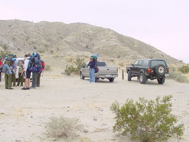

Coilovers aren't entirely nessecary...
Old Feb 16, 2007 | 07:50 AM
deathrunner's Avatar
Joined: Apr 2004
Posts: 2,969
From: San Diego CA
True, you can run stock torsions and get full flex, but then you lose high speed travel.
I found it extremely difficult to fully compress a tire with torsion bars. Even in your photo, the stuffed tire isn't able to rest on the bump stop. ANd it looks like the passenger tire is at full droop.
Lawrence Welk, right? Is that place still gated off?
Old Feb 16, 2007 | 09:25 PM
tenfourtyeight's Avatar
Joined: Dec 2003
Posts: 602
From: Vista, Ca
The torsions on my truck are 30mm Downey. Fully capable high speed, and crawling. Since that picture the truck has gotten 2.0 fox shocks and bumps in the front. Still just as capable crawling.
I also prefer torsions because they don't place the stress on your engine cage and front frame area, or those pesky ball joints.
Oh yeah, your old shackles are on my truck, Seth.
Yes, lawrence welk, not gated off if you go in the back way. I'll pm you my phone number, call me if you want to go out there with me and Austin some time soon to test out my 35's.
