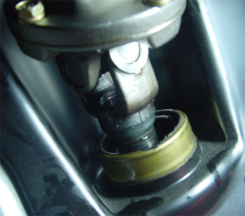

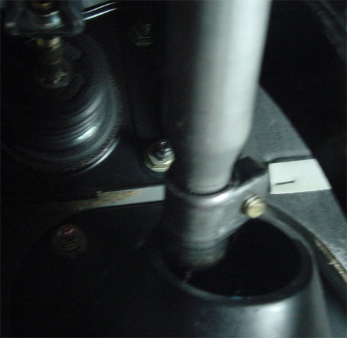

Thanks for the heads up Roger... I looked around the inside of the fender and it didn't seem like it was causing the problem. I checked inside the car under the steering wheel... Looks like the shaft is not centered with the hole... I loosened the top nut and pushed it out alittle... Now it is not as close as it was before. I think this may be the issue, as I would always hear the clunking after every bump or under acceleration.
Is this the same thing you are referring to? If so, how did you bend it? That sucker looks pretty tough. The pics are from after releasing the nut, so it's actually not as close as it was before.
Attached Thumbnails Steering wheel vibration after bodylift?-steeringshaft1.jpg   Steering wheel vibration after bodylift?-steeringshaft2.jpg   Steering wheel vibration after bodylift?-steeringshaft3.jpg

No, that is the passthru plate in the firewall most likely. Yes, you may need to plower that, possibly remove the plate and enlarge the holes if need be. But if it does not make noise, you are set.

I used a flathead screwdriver and managed to put a few little dings on the inside portion of the gold ring and lowered the upper portion of the top shaft under the steering wheel by just a mm and tightened everything back up. I also made a slight halfmoon cut on the plastic cover piece that covers it up. Took it for a quick drive and the clunking is gone!
Thanks bro.

Sounds like a fix. You always expect a few of those sorts of adjustments after the lift. I didn't have to touch my pass-thru plate with a 3" lift on my '85, but a buddy did in an '89 pickup with a 2" lift. I think it all depends on how that part was installed at the factory. If it was off-center to start with, the lift may make the shaft hit, but if it was centered or the shaft was above center, then it'll be fine.
