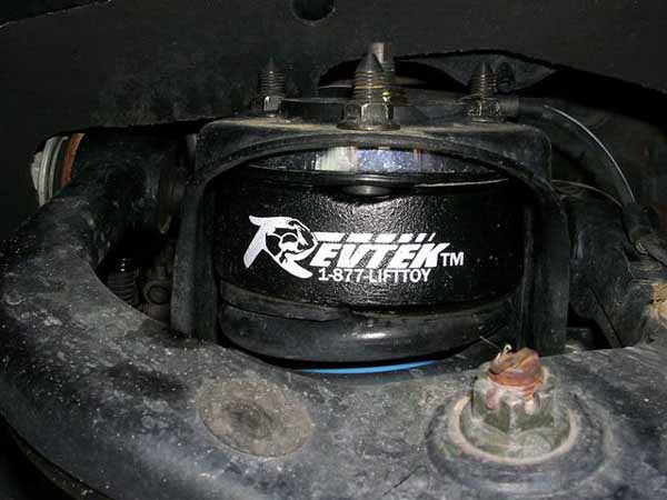

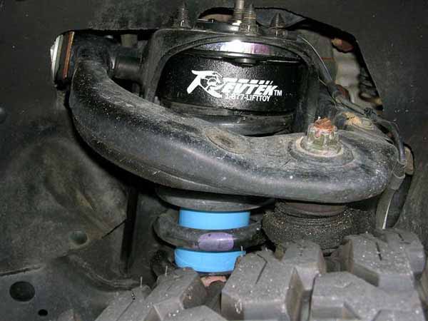

Here are some pictures of the coil spacers. All of them in full size are located here:
http://community.webshots.com/user/03trdblack

Another one:

It looks like the spacers are set right. Does it make the noise if you push up and down on the bumper?

well, as far as i can see from the pictures, everything looks in order ...
double check to make sure the lower strut mount is seated correctly ... make sure the top three nuts on the housing are tight ... double check all the balljoints and tie rods to make sure the nuts there are tight ...

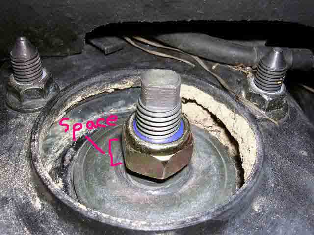

I figured out what the noise was! On top of the strut, there was a rubber grommet that the mechanics didn't put back on (since I replaced the front struts with Bilsteins). The washer moves around freely and the strut doesn't have that cushion from that rubber grommet. We are going to get that grommet back on and see if that solves everything.

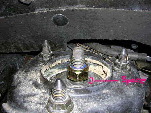

Here are some pictures of the top of the strut. As you can see, there is a space between the nut and the washer (as indicated by the colored lines).

One more:

that's interesting ... are you sure the nut doesn't tighten down any farther??? and are you sure that the spring is not compressed at all? i can't imagine what would be allowing that space ... because when the spring is decompressed completely, there is a lot of pressure/force there, and that nut keeps everything together ...
that damper rod should allow the nut to be tightened enough that there is no space between it and the top plate ...

I agree, but we tried our best to tighten that nut tighter, it wouldn't budge anymore. It was down as far as it could go. I think we are going to take the entire thing apart and see once and for all what the deal is.

probably a good idea, just to be safe. good luck! maybe the nut needs some grease/oil or something. as far as i understand, there is usually enough pressure between the top bolt and the strut top plate to keep things tight and quiet...
