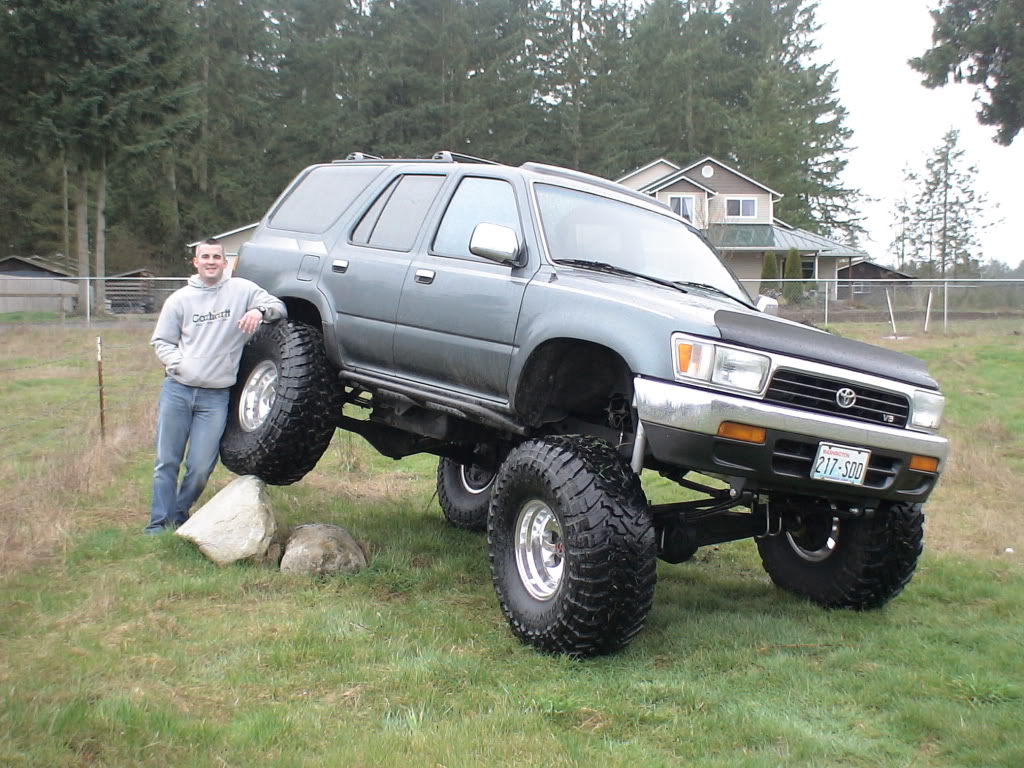

Do the triangular design to take advantage of the travel.
Like this

Hey haha i just pulled osme random picture from google images and it happens to be running chev. 63's

I have a 2nd Gen 4runner with 63" chevys out of a 3/4 ton 4x4 4 leaf + overload. If you have a 4runner do not mount the shocks like / \ it will be very very unstable at hwy speeds. I almost lost it in mine on Sunday going around a easy left at about 100kms/hr with the shocks mounted like / \ you get very little absorbing of side to side movement. I am redoing mine now to make them vertical and hopefully get rid of this very scary problem.

Considering that the picture algranger posted (post #3) is of my truck, I feel I'm qualified to answer a few things.
First, I agree with Wheelingnoob. Mounting the shocks like that reduces their effectiveness on the road. If you need to mount them on an angle, it is better to mount them angled towards the front or the back of the truck, not towards the inside.
Two, 12" shocks are not enough for Chevy 63" springs. Here is a picture of me trying to stuff the corners to see how far the suspension can cycle.
As you can see, the 12" shocks in the rear are limiting the axle.
Three, buy good shocks. Those Rancho 5000s on the truck are junk. I like Bilstein 5150s. You get what you pay for.
