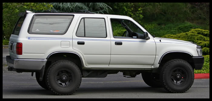

Yeah, it's not much higher at all. Mine measures just over .5" taller in the rear. You don't NEED to crank your Tbars.
And the LC coils are about 3.5" of lift, I think.
Before and after:
Now, w/32's:

Now, w/32's:
Size:  50.1 KB[/QUOTE]
Randomness, that looks sweet w/ the black stockers. Very nice.
Old Nov 10, 2005 | 08:59 PM
Randomness's Avatar
Joined: Aug 2004
Posts: 1,385
From: Sammamish, WA
Thanks dude! Cheap and easy
