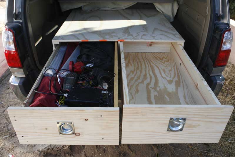

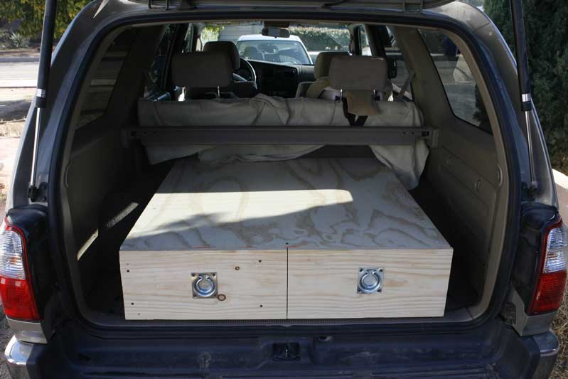

Been working on mine a bit, very simple and not nearly as nice as Corey's (those are beaustiful BTW), but it works and was cheap to build. Have to finish it still, but trying to decide between painting, carpet or herculining.
Basic dimensions are 39 x 39-inches, 9-inches tall. Two drawers, one for recovery gear/tools and the other for camera gear (work stuff) and foul-weather clothing/blankets etc ..
I plan to organize it better when time allows (was going to do some today, but, alas, it is raining out.)
