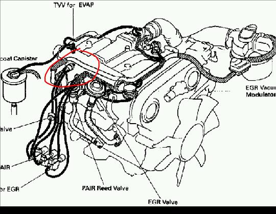

Not sure if I'm in the right thread, sorry if I'm not. Anyways, my husband recently did a gasket repair on our 94 4runner 3.0 4x4. While working on it, he accidentally broke a hose on the left side. Can anyone help naming this piece? I'll include a picture.Also we need a timing belt tensioner hydraulic part. Any suggestions for a website for fast shipping and fairly cheap?

I found diagram with the number for that part. It's 23266, anyone know how I can find the name with the number?

Not the best pic but I think this is the part your looking for FILTER, GAS, NO.1 90917-11027 this is for a 95 yours could be a different number name would be the same Name:  IMAG0684_zps09d7892d.jpg

^^ thank you that definitely helps! What is that website??

TOYODIY.COM you half to register for an account to see diagrams it's free though
