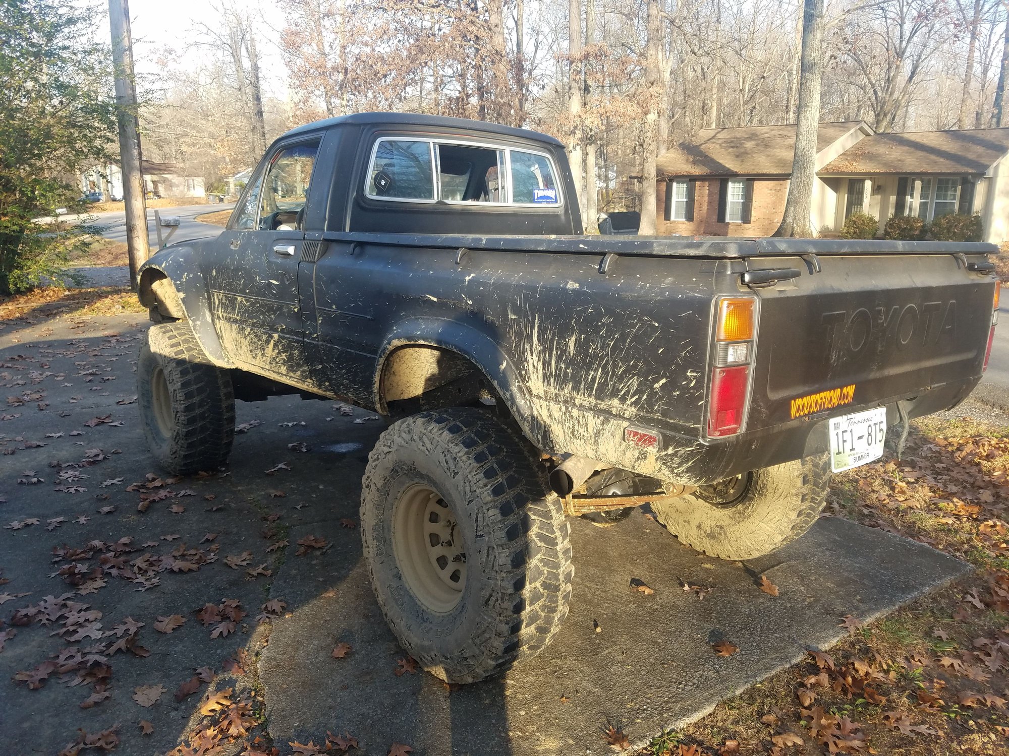

Hey guys, I have a 1980 pickup with what measures out to around 4.5-5" of lift and 35's, with a v8 swap, which I'm sure is way heavier than the stock engine was. I can tell that one of the previous owners cut off the front hangers for the rear leaves and welded some on further forward to run longer springs (maybe Chevy 63's?), and it looks to have newer springs in front, possibly some replacement stock rears. It looks to have stock shackles.
My issue with this truck (especially after 20 years of wheeling jeeps with maybe 3" lifts and 32's) is that it always feels like it wants to flop in off camber situations, and often floats a rear tire when going downhill in really uneven terrain (deep V's and boulders).
I see guys wheeling yotas that are way taller, and with much bigger tires all the time. Should i just get used to this feeling, or is there something I can do to help it?
I'd really like to get some stability sorted out since this will be my primary off-road machine now. I traded a '97 wrangler on 32's for this truck.
I have a rear locker, but haven't put one in the front yet.
It has a later model v6 rear axle under it, and 1' wheel spacers in front to match track width.
Any ideas? I don't really want to lower it because I like my current approach and departure angles.

Do your flexy springs make the truck feel less tippy off-road? I'm wondering if I should put and angle finder or clinometer on the dash to remind myself how much further the truck can tip without danger of rolling on over. I've had the truck way over (accidentally before a rear locker and fuel injection, just kinda how it ended up) and it didn't tip. But it sure felt like it was gonna, lol.
I have side-flopped jeeps a time or two, both in XJ Cherokees and a TJ Wrangler, but never even felt close in my Wagoneers, even with 7" of lift and 37's.
The XJ's and TJ were between 3" of lift and 4.5", (I've had several Cherokees of varying levels of bigness, lol)
I dunno, Maybe after 5 years of daily driving and wheeling a mostly stock TJ with a small lift, 32's, and lockers at both ends, I just developed an illusion of what stability feels like.
For the last year, I've been DD'ing a stock 2017 Tacoma, and it feels as stable as the days when I did my offroading in a clapped out Honda civic, even going over Black Bear Pass in Colorado this summer.
Maybe the problem is me, and not so much the truck. The thing seems to flex pretty well, although it does float a rear tire in strange downhill sections where a front tire ends up 2 feet deep in a v-notch.

It didn't roll in either of these photos, but as you can see, it floated the front tire a bit.

An inclinometer of some sort is probably a good idea. I’ve got an app for phone. Kinda put things in perspective. Helped me realize feel vrs reality. Places I thought was really sketch really weren’t as bad as they felt. Lot less work and money and gives actual feed back not “feel”
The imbankment in pic looks close to 30* which is close to max i’ll Push mine. Flex looks pretty good. Might get a little more by removing a spring.
