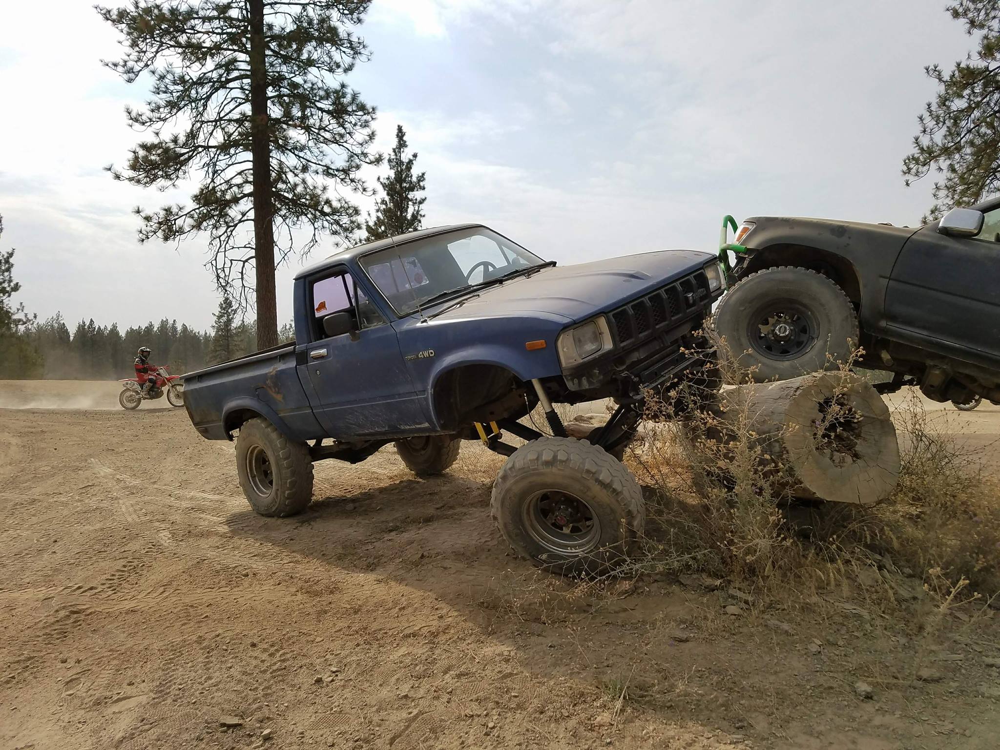

more flex?
first off im running RUF and chevy 63s, high steer arm hits the leaf spring and around that time i can lift up the rear tire.
ive got 12" travel shocks all the around as well. any idea?

what steering arm are you running?
what the trail gear kit gave me. so stock pitman arm drop? i think.

does it it both springs or just the driver's side?
if it's just the D/S spring you might consider a flat pitman arm if you have the clearance
passenger side only im assuming. thats the only time ive gotten out and seen it hitting
