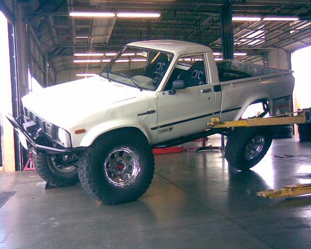

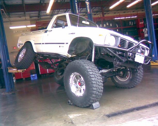

Old Oct 7, 2009 | 08:28 AM
mjos's Avatar
Joined: Jun 2006
Posts: 5
Some pics
Here are some shots before I trimmed the front and rear fenders. Since trimming them, I get about 2 more inches of tire stuff and more downtravel on the other side.
It's like a different truck on the trail now. No more carrying tires in the rear and getting all tippy anymore. I just need to adjust my rear pinion angle a bit now and I'll be all set.
Attached Thumbnails Marlin 5" rear leafs not flexing-image050-800x600-.jpg   Marlin 5" rear leafs not flexing-image051-800x600-.jpg

Use to the lift to pick up the front tire. In your pics, you're flexing your front suspension more than the rear.
