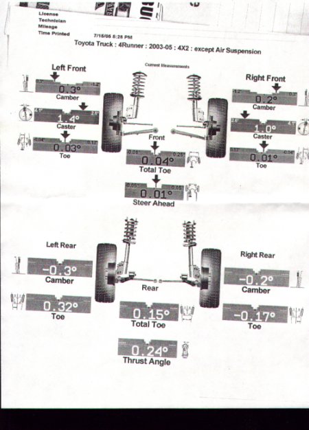

Old Jul 15, 2005 | 08:29 PM
  #56
r0cky's Avatar
Banned
Joined: Oct 2003
Posts: 5,365
From: Texas
The first dealership made a big deal out of it when I first installed the Revtek kit. Then they said they couldn't get it, and went ahead and charged me $400+ for it - giving it back even worse out of alignment than before.
The second dealership (Plano) was great, and was able to get it almost to spec. ... I think it has a lot to do with where you take it.
Old Jul 15, 2005 | 08:57 PM
  #57
Yosmany's Avatar
Joined: Jul 2003
Posts: 205
From: N. Virgina
Here is the print out from the alignment if it helps or if anyine has feed back. Thanks.
