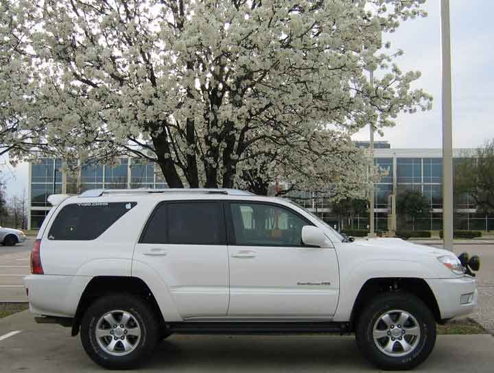

After spending some miles with the Hoe's, I wonder why guys mess with spacer lifts in front. The handling is so much better than stock, while offering me the extra ground clearance I need when off-road.

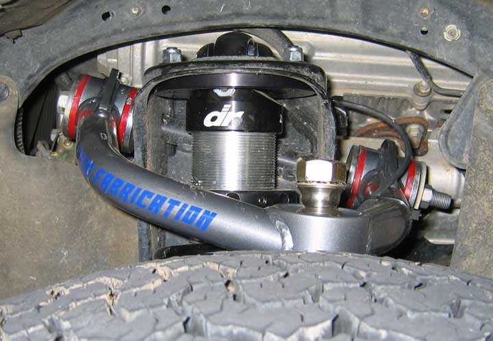

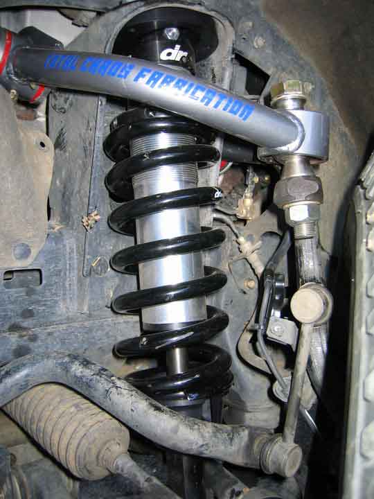

OK here are 3 new photos which I don't think I have posted elsewhere. At least I just finished Photoshopping them for this list.

lookin' good, RL! who did the drilling to fit the larger bolt for the upper arms?

Mike's Off Road did. I just picked-up all the spare parts today. The Xreas lines are about as long as the 4Runner. Then there is the collection of Revtek and NE parts too. I'll save the Revtek lifted front struts in case I should ever want to rebuild the Donahoes.

Is that mark on the bottom 2 coils the swaybar rubbing or just a mark of dirt?

I saw the same hing and went for a look. There is no rubbing. I'll have a closer when I change my oil tomorrow. However, the Donahoes fit perfect. If there is a scratch it is from the installation.

Have you tested the flex on the front wiht the Hoes and TC arms yet? Your front suspension looks like the best yet!!! WOuld love to see some pics in action, especially flexing the front

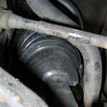

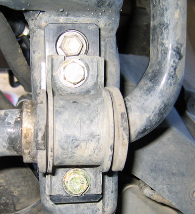

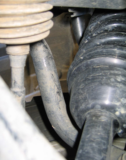

Me too. However, I'm spending more time motorcycling right now. When it gets hot, I'll be in the woods with the 4Runner. I have some new photos I took while changing oil. Should post them soon. I had a close look at the relationship of the anti sway bar anf the Hoes. The sway bar was dropped with a plastic spacer, so the gap between the bar and the coil spring is about an inch minimum. To get you a flex shot I will take a couple at work. I have a gravel road with a ditch on either side. Should do fine.

How thick is that spacer on the swaybar?

The spacer looked to be a third to half of an inch.

Weekend Photos
It is hard to see the gap with these photos, but there is one.

Thanx. Nice to see how they moved the swaybar forward and down a bit to give just enough clearance for the coil-over. Pretty cool.
