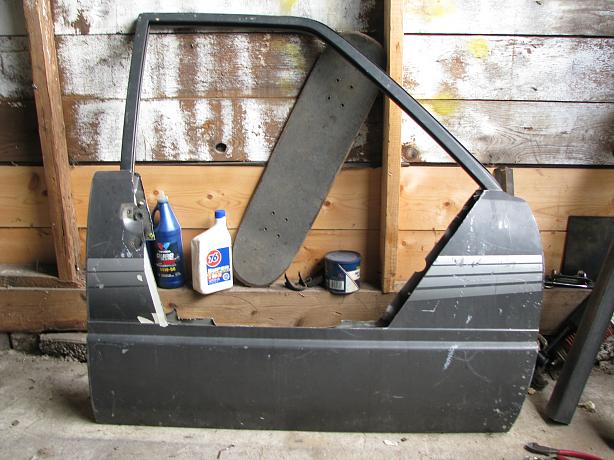

i did some trading the other day and came up with some 85 doors. i am making some half doors. i cut the shape that i want and mocked them up with the stock latches.
my question is. should i fill the door with wood or steel or both?????

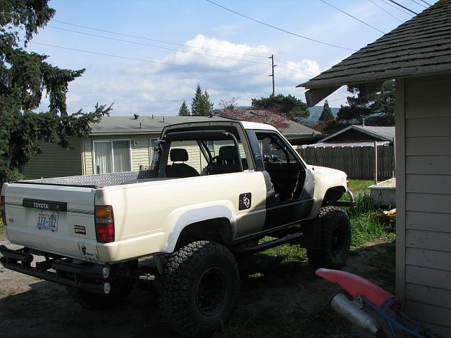

i had to run out to the garage this morn to grab some pics and do some door fitting, they are straight enough now so i can start fabbing!!!!!
i got a nice piece of diamond plate that matches the back area. on trade once again!!!! im gunna cut it up and make inside door panels!!! i might use it to cap the door but im not sure yet!

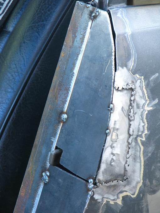

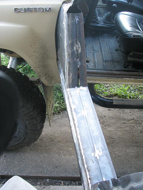

so i went down to my neigghbors house and picked out some steel. i decided on angle stock 2x2. i built up the lower section of door with a couple of 2x's and built up the front of the door to save the body line from cave in. so far so good i stood on the center of the door and it is solid as a rock.
next, i have to figure out how to finish off the latch but i'll keep you posted!!!!

here are a few more pics i need to figure out how my latch is gunna work. tomorrow is another day!

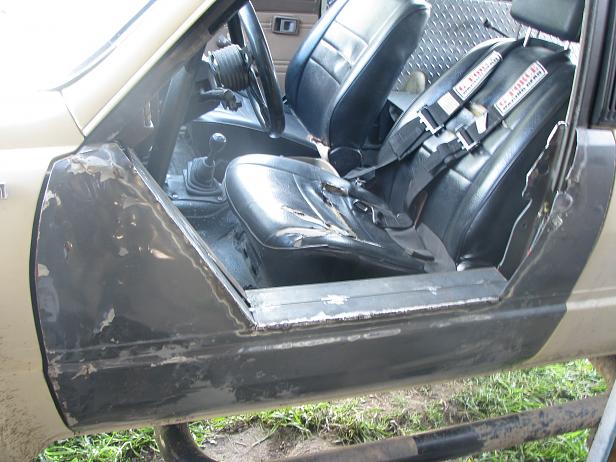

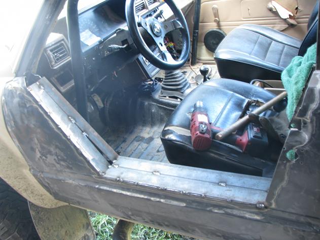

here are some pictures of the work i did today.
