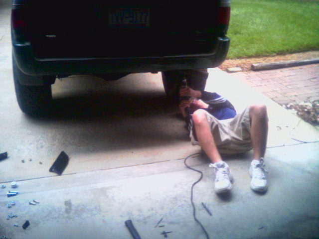

updates on the hitch install! we have had to put a hault on the install because of rain and the fact the 4runner wont fit in the garage with the roof rack...lots of pieces, dont think well have to use it all though
weve got one bracket on the left side, and were working on drilling the holes for the other bracket when the rain started

alright all finished up with the hitch...it looks a little goofy because of the body lift, but it will serve its purpose well! front tow hook should be completed in a few days, pics to come
