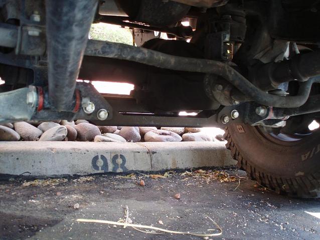

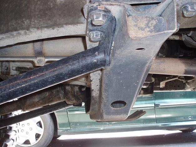

I have an 86 4x4 runner (4cyl). Trucks purpose is DD/trail, not going to be a full blown crawling rig any time in the next 5 years. It has a 4" procomp lift which sits very nice. This truck is a little backwards, it has lift and tires before armor/gears/locker, but I bought it this way.
Question 1: the procomp lift has a little dinky looking truss. Besides fabricating, does anyone produce one that would work?
Question 2: I was wanting to put a budbuilt crossmember on, but again, this lift has a part bolted up and resting against the stock crossmember. Obviously, a flat crossmember wouldn't be able to support this (I think).

So really, is this procomp lifted even partially decent for off-roading? Or is it more of a "looks" lift? It was already on the truck, so now I have to find ways to mod around it. I contacted Bud at Budbuilt, and he told me it would be fine, but I sent him an email back with a picture of the situation.
Also, how difficult would it be to remove this lift? (Granted, I don't have any of the stock suspension parts...)

Ok, first off, that Procomp Stage II kit is probably better than anything else on the market for our IFS trucks. If you want it for looks it works for that, if you want it for wheelin it works for that, if you want to jump sand dunes and clear 20 feet and survive...get a Total Chaos kit. Geez. That dinky looking truss is more that adequite for anything you'll probally do. Plus you can bolt your BudBuilt skid plate to it and brace the front end up even more. The BudBuilt transfer case skid plate will work just fine with the lift, I should know.
You could probably "reverse" lift and remove the drop bracket but there is a piece that was cut off and would have to put back together. Other than that, knock your self out. If you would like to see that lift in action search for Reiter Pit or Tahuya. I would definately get some gears for 33's or larger. Since, your not doing your "full blown crawling rig any time in the next 5 years" I think you'll be more that satisfied with what your truck will do with some tires and lockers to complement that lift.
