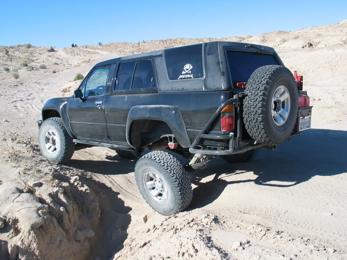

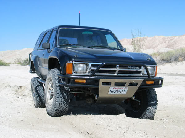

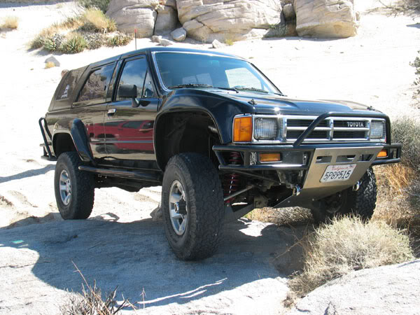

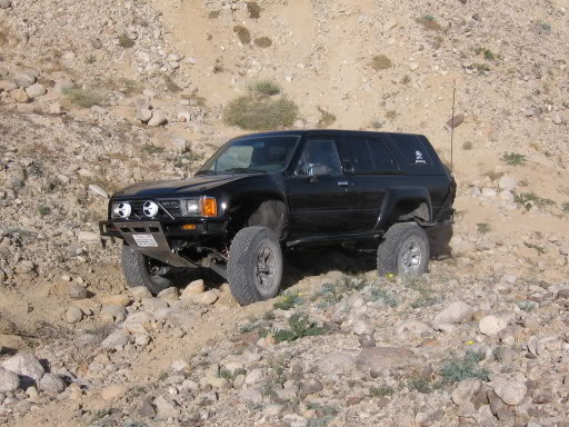

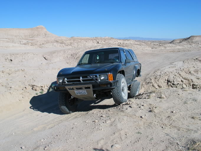

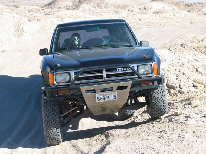

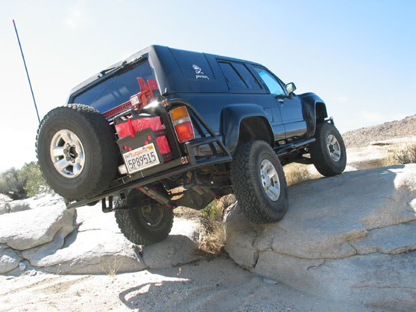

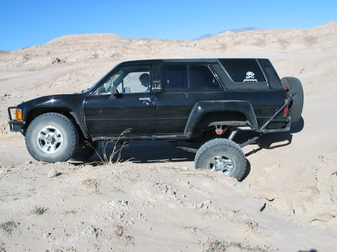

Alrighty, time for some poseur shots. The rig is nearing completion and I was able to take her on a test run. Still needs some tweaking, but all in all she is good.

Thanks guys. Like I said, it needs a little more work. I am working on aluminum panels for the interior. I had a local fabricator work off of someof my plans. He did good work, but left off an important attachment point. So we are gonna work to fix that. I am also going to be building a custom matress to fit in the rear. I'll post pics of the interior when theyt are done.
I know everyone syas a truck is never "done", but the plan here was to actually get it done (Not Get-r-done). My girlfriend wants to start saving for a house and with the prices here in california....I would never have accomplished any of this if I was making house payments.

What rear flares are those you are running? They look great and they really tie in with the Ivan glass up front. Our truck is done also, in fact it's rear suspension is very similar. Keep up the good work the truck looks killer.

It's the hanneman bolt on glass. I didn't think bolting on complete truck skins would get my desired look. PLus I didn't want to have to screw with relocating the gas filler.

This is the flare. It is actually made for the pickups and listed as so on thier site. I saw a 4runner with them (But just slapped on the sides), it gave me the idea.
It is a lot of work to do it right. I gotta say, protrux did mine the right way. There is alot of trimming going on under that flare. I was nervous at first, but they did a great job of sealing it from moisture and it came out looking nice.
The flares allow me to stuff the tires and not even come close to rubbing. I could probably fit 35's without rubbing, but my 22re and drivetrain aren't up to teh task.

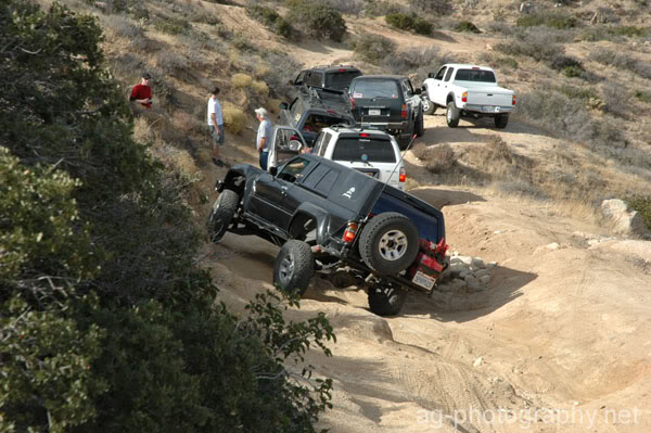

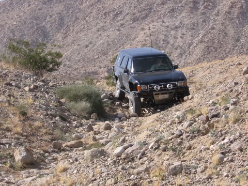

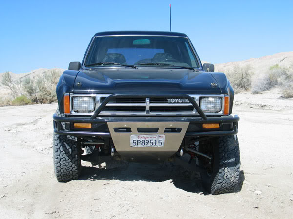

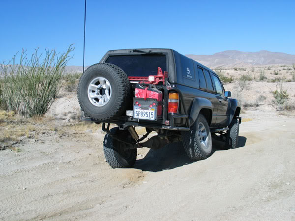

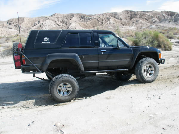

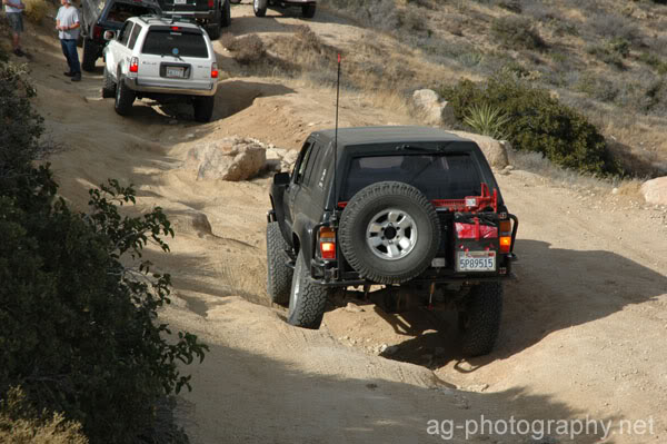

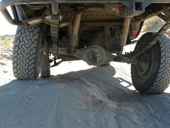

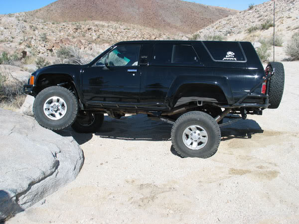

Here's an update on what is current with the deathrunner:
We ended up getting shorter shackles, relocating the shock hoop in the rear slightly, adding leafs, and changing the bumpstop mount. I am much happier with it now.
LOTS OF PICTURES:
