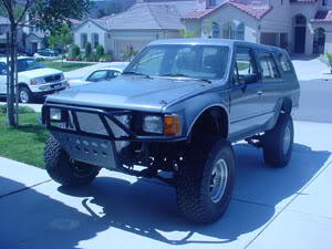

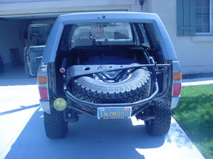

Here are a couple pics of his 'runner. It has the old ATS kit.

It looks good in the pictures, but better in person. When are you going to come in again to get the wipers and squirters finished?

Sweet. I now know what my Runner will look like with the Ivan Stewart kit. There seems to be 2 other build up of LT Runners. I will hopefuly get mine started at the beginning of '05.
