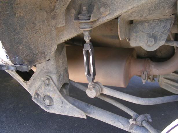

As long as you are going to use leafs it probably isnt too much work, just grind eevrything off the housing, mount perches and shock mounts and your done. that is what my buddy is doing. But if you have coils (90-95 4runners) just do the 3rd.
For sway bar dscoes. I had a system that I made that I LOVED. It used turn buckles. the only thing I would do differently is use a steel turn buckle. mine was Al (aluminum) and after a year te steel studs had worn down the Al turn buckle.
I had a thread but cant find it.

I don't get it 4rnr - how do they disconnect?
Old Feb 25, 2009 | 02:00 PM
4rnr's Avatar
Joined: Sep 2004
Posts: 1,515
From: Plainfield, IL
Its a turn buckle. So just rotate it and it disconnects. I guess you can also say they are adjustable.
Old Feb 25, 2009 | 02:11 PM
tc's Avatar
tc
Joined: Nov 2005
Posts: 8,875
From: Longmont, CO
Oh - got it, the factory end links are threaded into it...
Old Feb 25, 2009 | 02:19 PM
4rnr's Avatar
Joined: Sep 2004
Posts: 1,515
no, I butt welded the studs to the sway bar links. I put a nut on the end of each stud to give me some more material to weld with.
