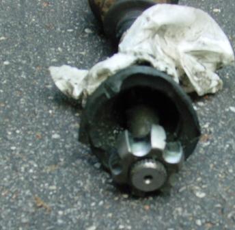

Hey guys, my axle popped out the other day when I was doing some crawling and I'm not sure whether or not its broken.

YES it is most certainly broken. More than likely from too much droop and it bound.
I had the same thing happen to me.

Yeah, thats what I figured. I just put on my lift the other week, and sure enough it broke while i was out there. I'm gonna run my autozone tomorrow and get a new one. I installed your diff. drop when I put the lift on, is there anything else I can do to prevent one from breaking in the future?

What lift did you use up front?
A front locker can help and hurt, but what happened to you looks exaclty like what happened to me in Moab on Rocker Knocker.
The wheels were fully turned to the left and the right front tire was drooped all the way down, it was too much with the wheels turned so hard and the outter CV just seperated, just like yours.
CV's that fail from impact typically explode the outter cup, I came up with the front limiting staps so I could set the droop where I wanted it.

I used the TRD tundra lift in the front and its not locked. What you described there is exactly what happened to me.

Yeah, I think you need the straps and you'll be set. Especially if you used the OME front shocks, those are considerably longer than the rest, but have the nice huge shaft and softer valveing.

There is such a thing as too much droop. A tire hanging there with no weight on it is not going to act like a drooped tire on a straight axle.
Run a front locker, keep your front travel within reason and don't get on the gas.
My axle from Moab:
Hunt's axle from Moab:
We both broke at the same place, no one else with IFS even tried it.
This is the reason along with the fact "I could", that I converted to the Dana 44. It broke too easily with that extra droop.
Binding breaks pull the tulip apart, get on the gas breaks typically blow the outter shell apart.
Know your travel and limit it within reason. They only build so_much_droop into these parts.
