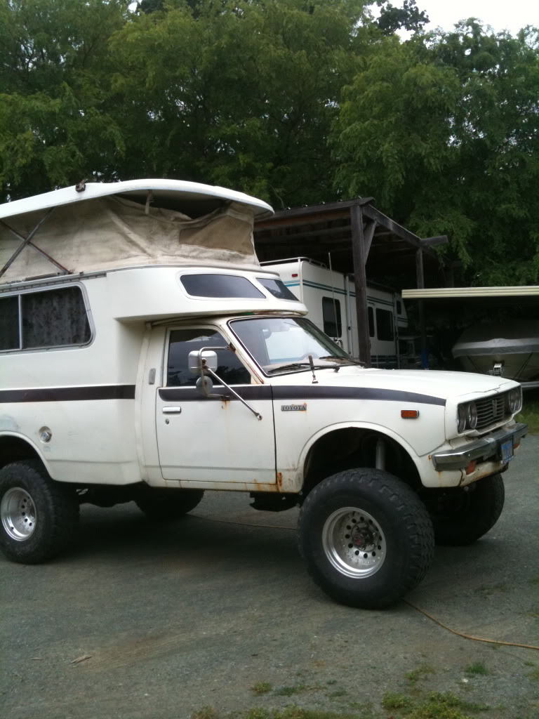

WOW!
Those things are ideal! I saw one in Santa Rosa. He had an 22r with a 38 Weber and Offenhouser intake. The guy is a genius with Yota's. After I saw his I wanted one so bad. He said the thing climbs steep grades in 4th gear at 60mph!
His was awesome!
