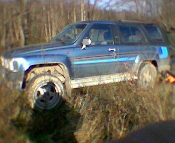

Here are some pics they are lousy quality because they are made with a mobile phone,but i ll put some better ones soon

Interesting rims,anybody seen something similar it says fittipaldi on them.
Sorry no hard core off road pics yet I just got this camera
Attached Thumbnails Cheap diff lock alternative- what do you think?-image011.jpg
