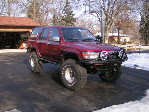

when I was IFS I had 35's on cranked t-bars, and some coil spacers (I would say 1.5-2" of lift.) I had to work the fire wall with a hammer a little but no fender trimming. I could have wheeled it but I used a set of 33" tsl bias ply's which measure 33.7" tall (as tall as some 35's) and I didnt rub with those and it was flexy, in the rear any way.
