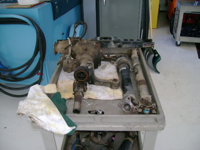

Pics I have taken of the parts.
Here are the front drivetrain components
Transfercase off of a 2000 tundra
Close up of the electronics that will have to be wired in.

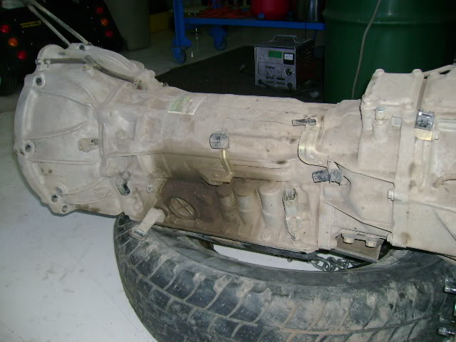

Side shot of the tranny and transfer case. All of these cannon plugs will plug right into the existing harness.

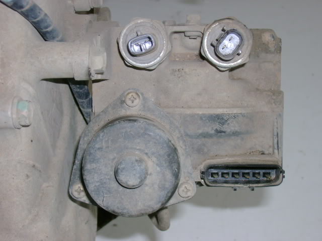

Front Diff. w/ ADD The ADD will also have to be wired in.
Front diff, fwd driveshaft, and (fwd section of the rear driveshaft which I have 2 of now so if anyone needs one let me know)
I wanted to document this really well so if you check out the photobuck page there are also alot of reference pics.

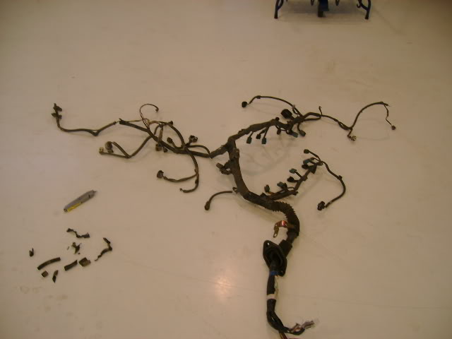

After alot of cutting and unweaving I managed to seperate the 4wd sections I needed from the rest.
Look at Caligula455's thread on his conversion he has a great picture of the wiring that needs to be added.

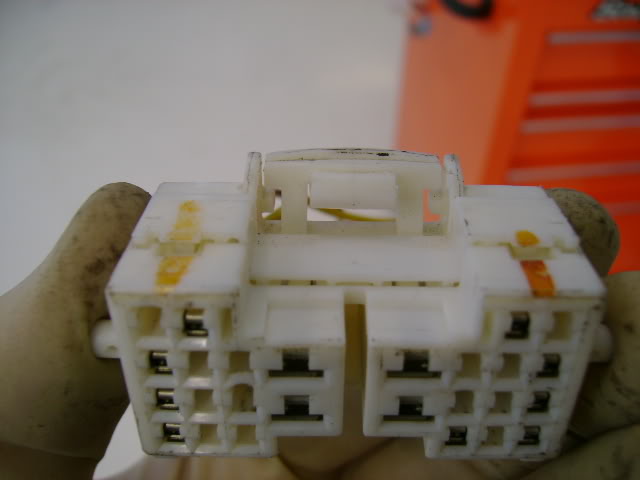

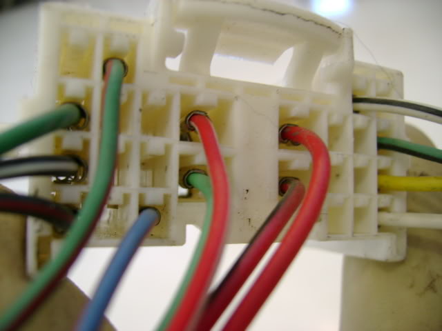

Here is the plug from under the dash with just the 4WD wiring still installed.

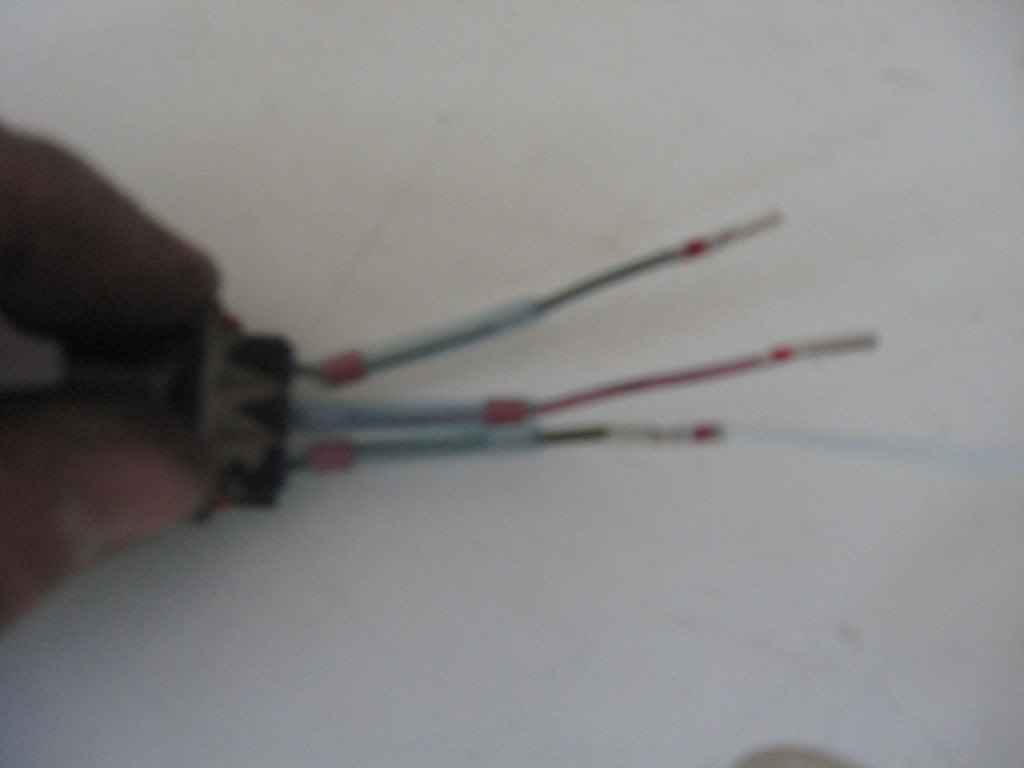

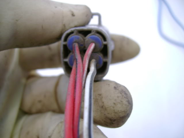

The wiring for the ADD stops at the back of the engine block right at the wiring harness in 2 seperate plugs. It must have another section that joins the 2. I dont have that section so I will have to make my own.
Here is what I am going to call ADD plug 1. All 4 of these wires go directly to the ADD and come from the dash plug.

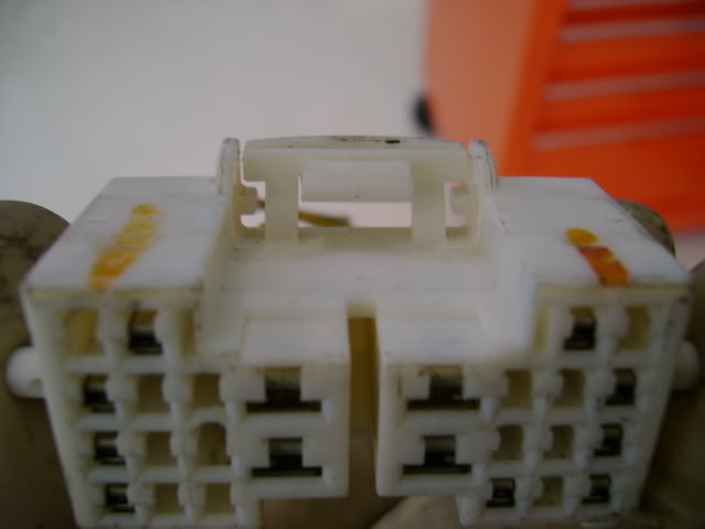

Here is where is gets interesting... This is ADD plug 2. Only the 2 green wires go to the ADD and come from the dash plug. The brown is a ground for the shielded wires (black and brown) But i dont know what those wires go to. Further investigation is required. The wiring diagram in the back of my Haynes manual is useless for this application.
the four big pins in the middle are what i need. if you can find four like that in any other connector and remove them that would be fantastic. i dont care what color or anything, just that they will fit into my connector.
i'll email you the wiring diagrams that cover that. there was a site where i bought a day's access and downloaded all of them which you may want to do also. be careful,the 2006 manual which you can find online is different.
the short answer is that all 6 conductors that leave the ADD go to that dash connector, they are split between EC1 and EC3 which are the four and six conductor connecors you show there. i just cut off everything past the ADD connector and spliced in wiring directly to the dash connector pins.

Wiring
I ran the wiring thru the firewall today.
This is the plug that the wiring needs to be run into. To remove and insert the leads you must open the trap door on the top of the plug.
Here is the top of the plug with the door closed.

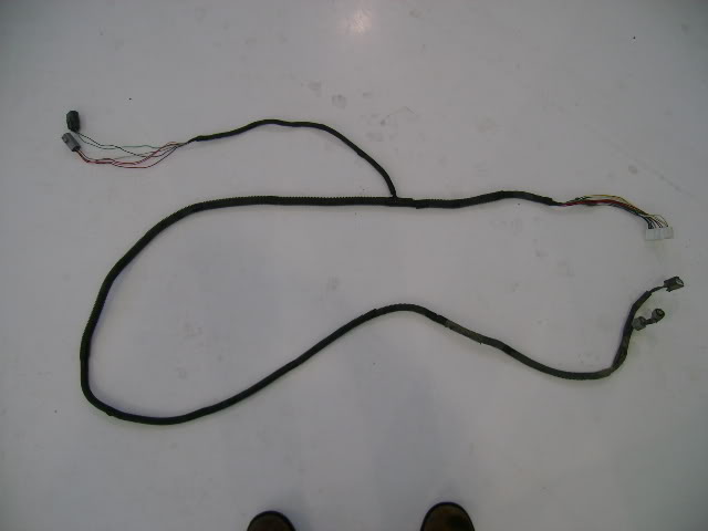

Here is the complete wiring harness for the 4WD system.

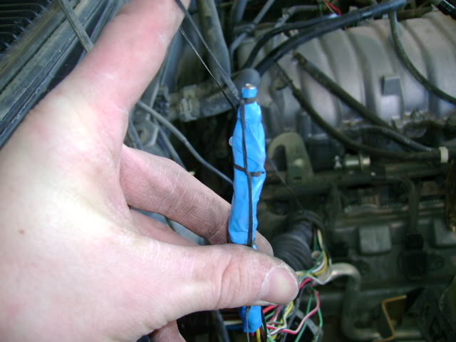

I used a small section of stiff wire and some string to thread the wiring thru the harness. Make sure to stagger and tape up the inserts to make the bundle as small as possible.
Use the wire to start the string thru the harness
Then tie the string to the wire like this. I tie the string back about 4 in then make a few logging loops to make sure the wiring follows the string. This also helps distribute the force if you have to pull hard.

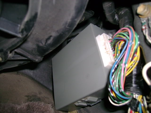

Here is the install of the 4wd computer and buttons
The Bezel is held in with 5 screws. 2 abovel the vents (you have to move the vents out of the way to remove them), and 3 behind the climate control knobs. Then just pull, unplug and replace. Its that simple!
Then remove the passengers kick panel and plug the 4WD computer into the plug that is just back there hangin out.

just out of curiosity, did you have to change the instrument cluster, or were the indicators already installed from factory? I take it the wiring to the cluster was already in place haha
Old Jan 22, 2009 | 01:15 PM
Jwbenninger's Avatar
Joined: Jan 2009
Posts: 23
From: Aspen CO
I did not have to change the cluster, just plug in the 4WD ecu, and viola!!

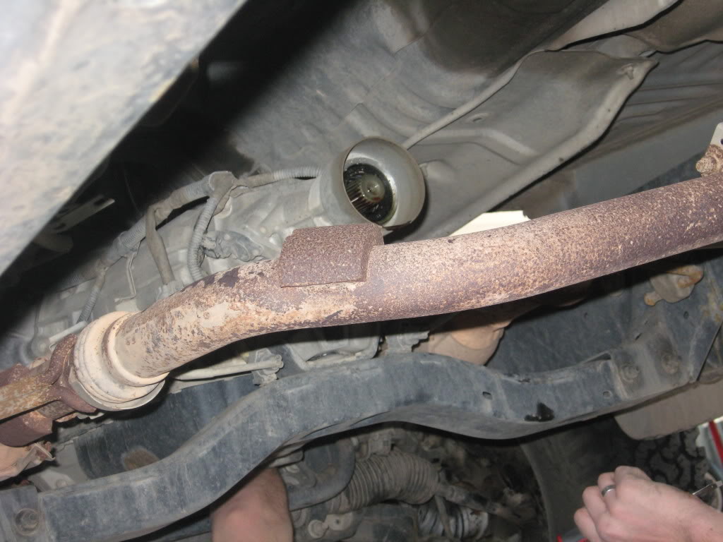

After installing the new tranny and transfer case you have to lengthen one plug because the 2wd Tranny has the sensor at the back of the tranny and the 4wd tranny has it on the transfercase on the opposite side. So cut it off, again stagger your cuts, and add some wire..DONE, all the other wiring for the tranny is the same and the wiring I added, since it was from a stock wiring harness fit great. BTW make sure not to damage to small plastic clips that hold your O2 sensor wiring to the cross member, you will need those clips to re-route the wiring along the transfercase. Mine still had the stock brackets and the plastic clips snapped right in.

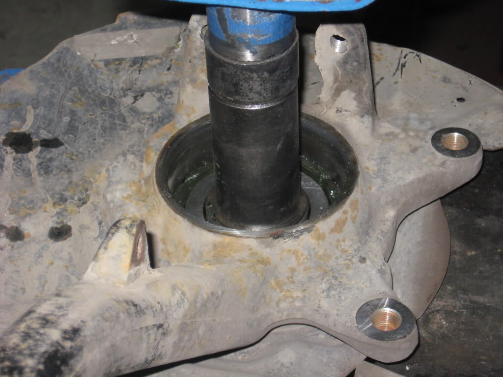

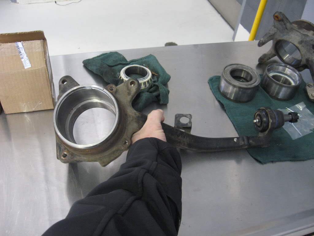

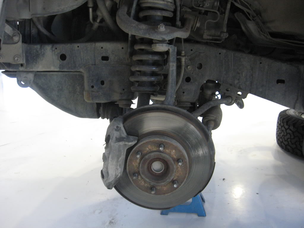

Now for the fun stuff, I put new bearing into my truck when I did the front end because I needed to swap over the break backing plates and I couldnt figure out a way to remove the hubs and save the bearings. My truck has alot of miles on it so I i figured it was worth it. But just as a side note those bearings are expensive about 150 buck a peice and you only get 1 shot to install them so if you dont know what your doing have a shop do it.
Here is the control arm with no bearing in it.

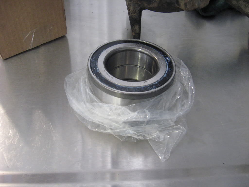

New bearing
4WD hub

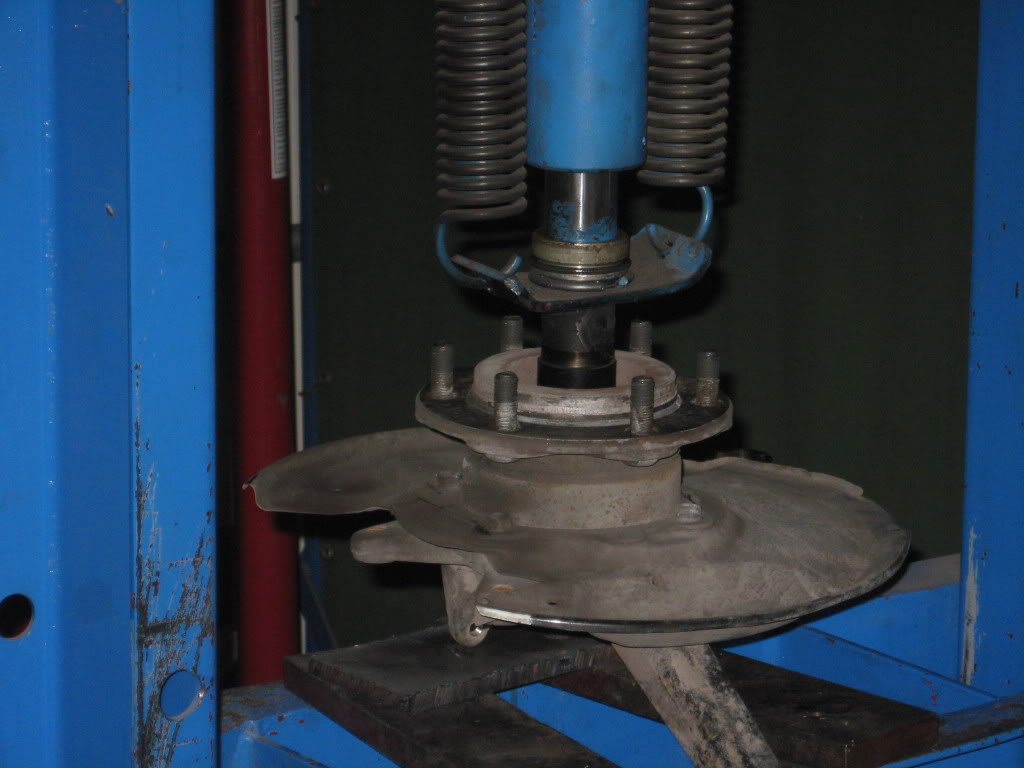

Shop press
Pressing out the hub

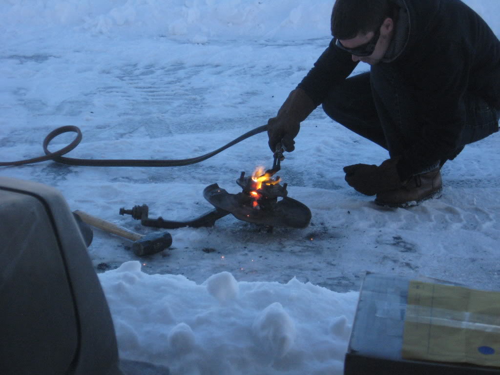

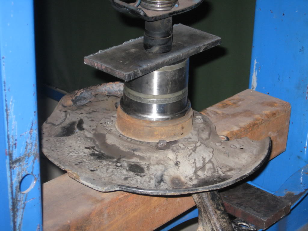

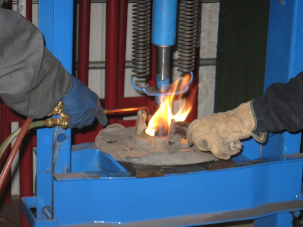

Hub being stubborn
Getting my backing plates off of the 2wd control arm.... hub wouldnt come out so I cut them off with a torch.

Pressing in the new bearing after I installed the backing plates on the 4wd control arms....NOTE the old bearings worked great to press in the new ones.
Pressing the 4wd hubs into the new bearings.
Ok now that the control arms are built up I installed the front diff. This was VERY simple because it all just bolted right up the the frame. Installed the front CV shafts and front control arms.
2wd control arms before tear down

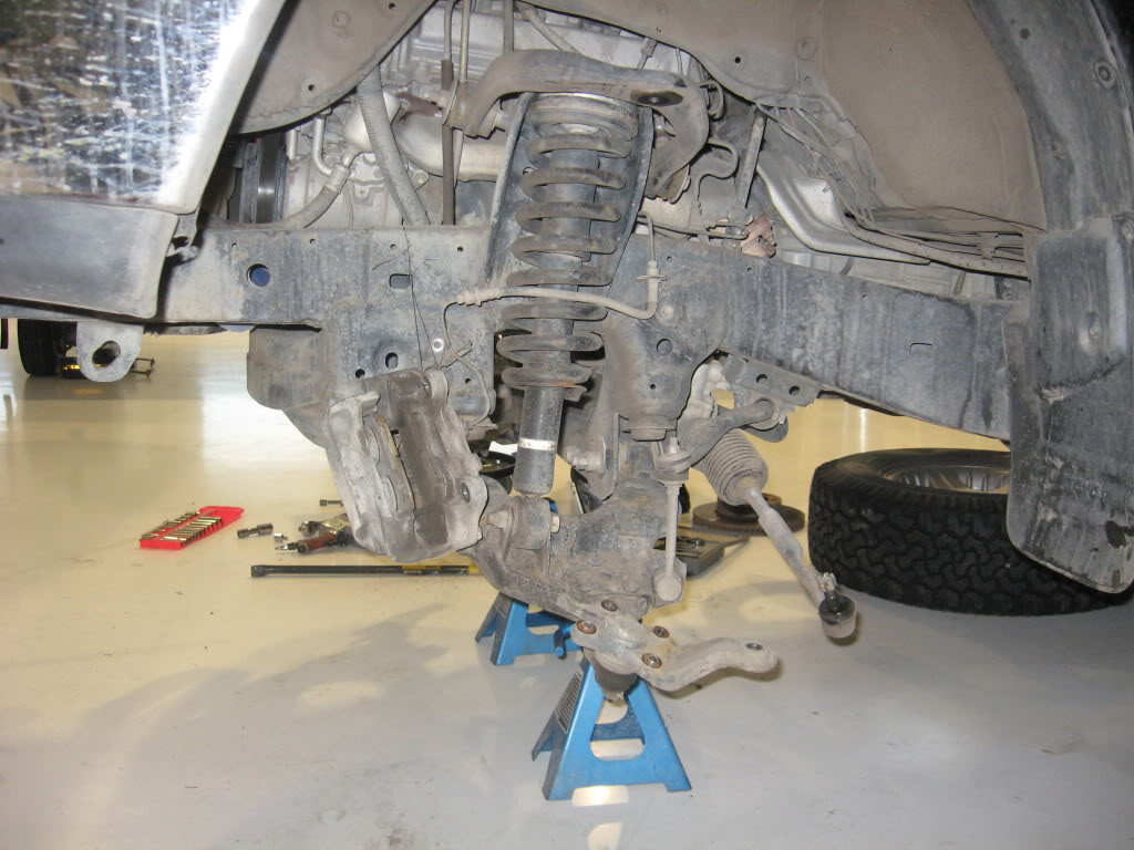

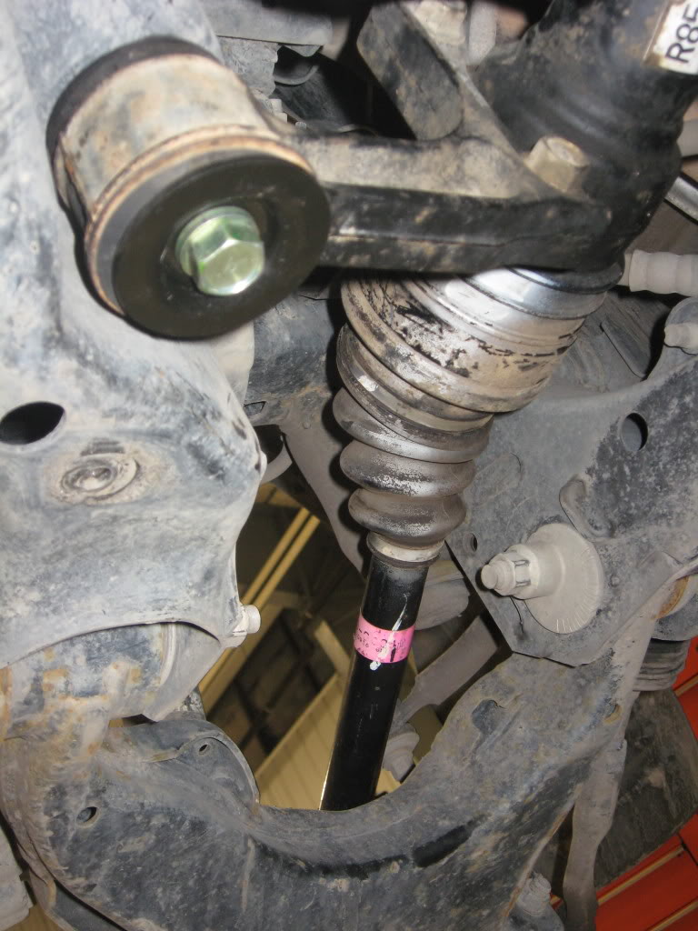

Torn down front end
Front Diff slides right in
Then the CV shafts
Then just bolt up the lower ball joint to the 4wd control arms. Slide the cv shaft into the hub, hand tighten nut it will hold it in the hub, then bolt on the upper ball joint. Torque every thing to specs, and install the brake caliper and tires and all the other stuff you took apart to get the control arm off. I put the tires back on here for safety reasons.
FRONT END DONE
now the tranny.
Removeing the 2wd tranny CAKE, easy as any other tranny I ever took off.
Installing the 4wd tranny not so much. As it turns out the 2wd tranny will drop right out with out removing the exhaust y pipe. The 4wd tranny however will not go back in......easily. As I have said before my truck has around 100000 miles on it, so if you have every worked with an old rusty exhaust you know that if you try and remove it you will break something... But do yourself a favor and just take it off. Trying to get the tranny and transfer case up to where it needed to be was almost impossible with the exhaust in the way. It took 2 floor jacks and 3 people the better part of 3 hours to get it done and we almost dropped it a few times... NOT WORTH IT. This would have been the easiest project except for that. But after the carnage was over it all went back together perfectly.

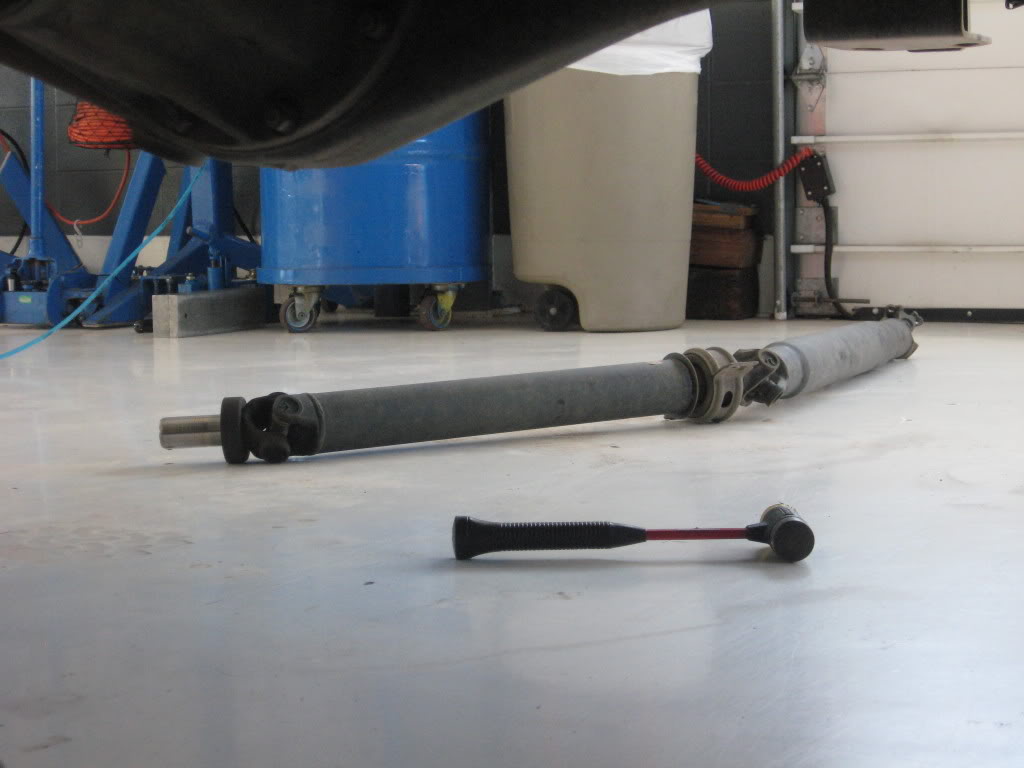

Step 1 remove 2wd driveshaft

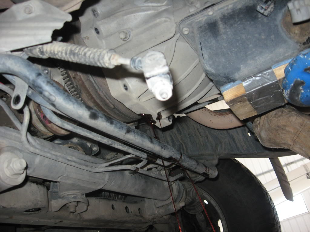

Then cross member, make sure to support the tranny
Bell housing bolts, torque converter bolts, draining the fluid, and a few other mount botls and you are ready to drop it out
Redneck tranny jack, and alot of grunting, swearing, thinking and more swearing and presto the 4wd tranny falls right in. Start all bolts loosly then torque to specs.
And i found out after spinning the front diff and the rear diff, that the gear ratio in the front end matched my stock one from the rear so no need to swap ring and pinion!!! Gotta love the YOTA!!
Now install the 4wd cross member and tranny mount, slap in the front and rear driveshafts. again start everythign loose and then torque.
Now fill or top off all the fluids.
