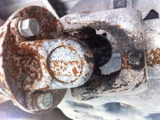

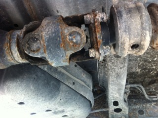

The clunk is the driveshaft, grease the crap out of it and it goes away. My t100 does same thing, 2 pc driveshaft I think is the issue.

Thanks guys, I did join tundra solutions and found out the clunk is the driveshaft - where the 2 driveshafts meet, is there a zirk fitting? I couldn't find one but i didnt get chance to clean good under there yet. I greased all the u joints, but the squeal/whine over 20 is still there. Ill have to look into the recall, probably not if FL for the unercarriage..It surprised me when I saw it.. nothing bad deterioration, just a lot of surface rust.

I put 5-6 pumps in there, but didn't want to go crazy.. where does that grease come out? is that the fitting for the 2 driveshaft linkage?

I figured there'd be some way to grease the mounting bracket that the front of the 2 rear shafts sits in: I thought maybe that hole in front of the 2 ujoints led to a zerk, but cannot find one upon spinning the shaft:
The rear ujoint and zerk on the sliding shaft
You can also get an idea of the surface rust under there...so rustoleum makes a paint that halts or kills the rust, and then spray over that with the black? Think I should spray the driveshaft, rear axle/diff, and everything pretty much metal under there?
