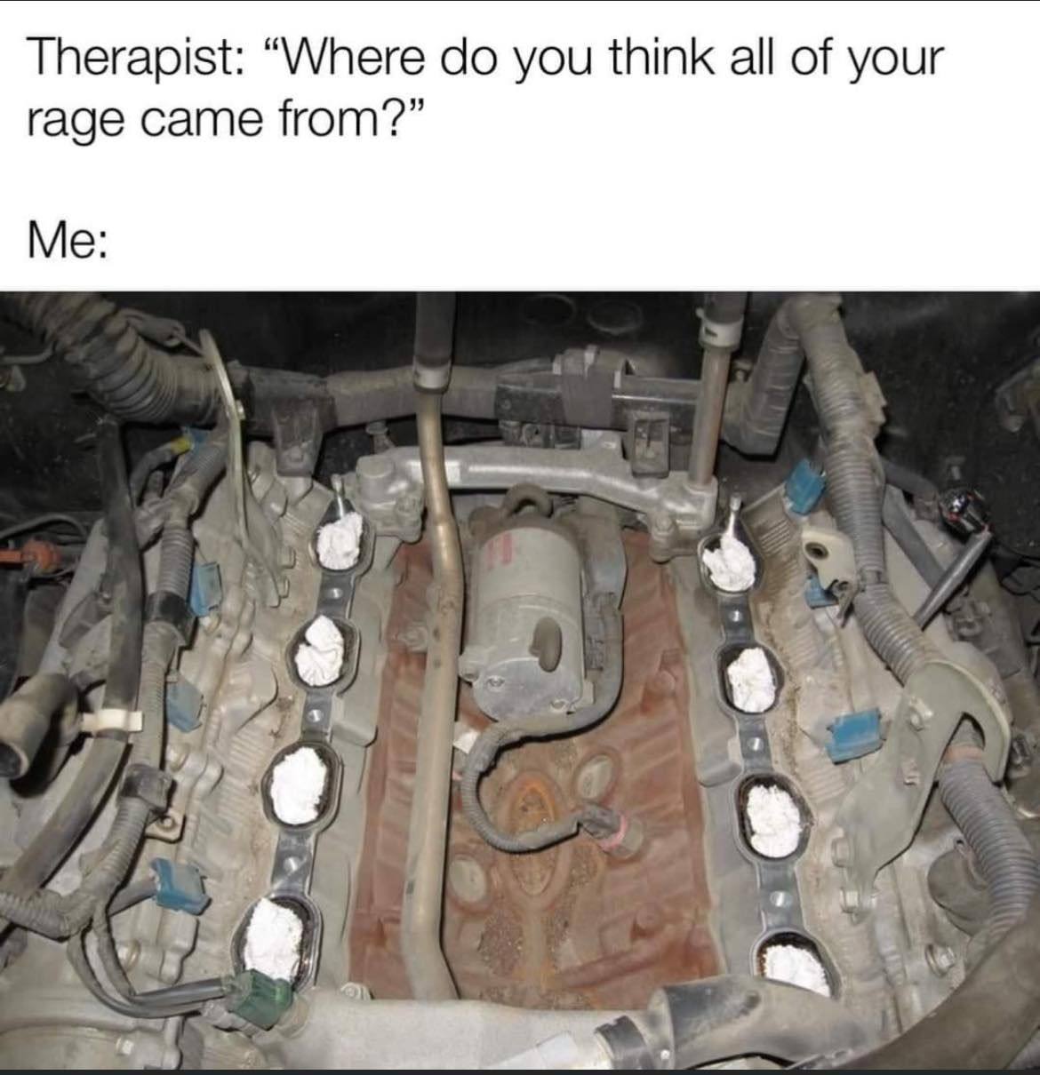

I've been seeing this meme regularly on FB and Irate4x4 for a couple of months at least. I did not make the meme, but I knew exactly what it was because I remembered taking similar pictures when I had to repair my startert.
I saw the meme posted again today and I thought that the paper towels in the intake runner looked like something I'd do, so I spent way too long today finding this old thread from 2007. Sure enough, it's my picture (from this thread) that they used for the meme. Look at the distictive shapes of the paper towel sticking out of the intake ports, they are exactly the same.
Can I get a cookie or something?
