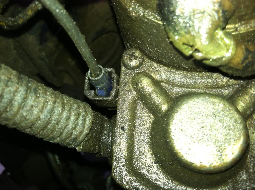

Is this the starter solenoid connector? Name:  null_zps9617f608.jpg
It's a brown female connector located under the intake manifold. If it is the solenoid connector where's the male part of it? I can't get my truck to start and I think this Is my problem. The starter acts like its getting no power at all. The only thing that happens when I turn the key is the starter relay clicks once and the fuel pump engages. I get no crank what's so ever. Can anyone help me?

Sure looks like it

The male side is on the starter

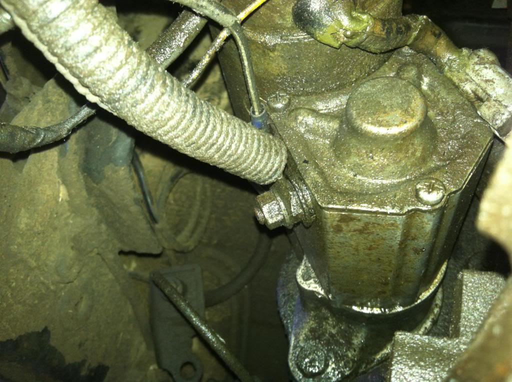

There should be a plug on the starter itself. It is by the cable that goes from the battery to the starter. If its a 22r or 22re then it should be like this.

I'm an idiot.... Thank you so much!!! Got it to crank just no start. thanks again guys!
