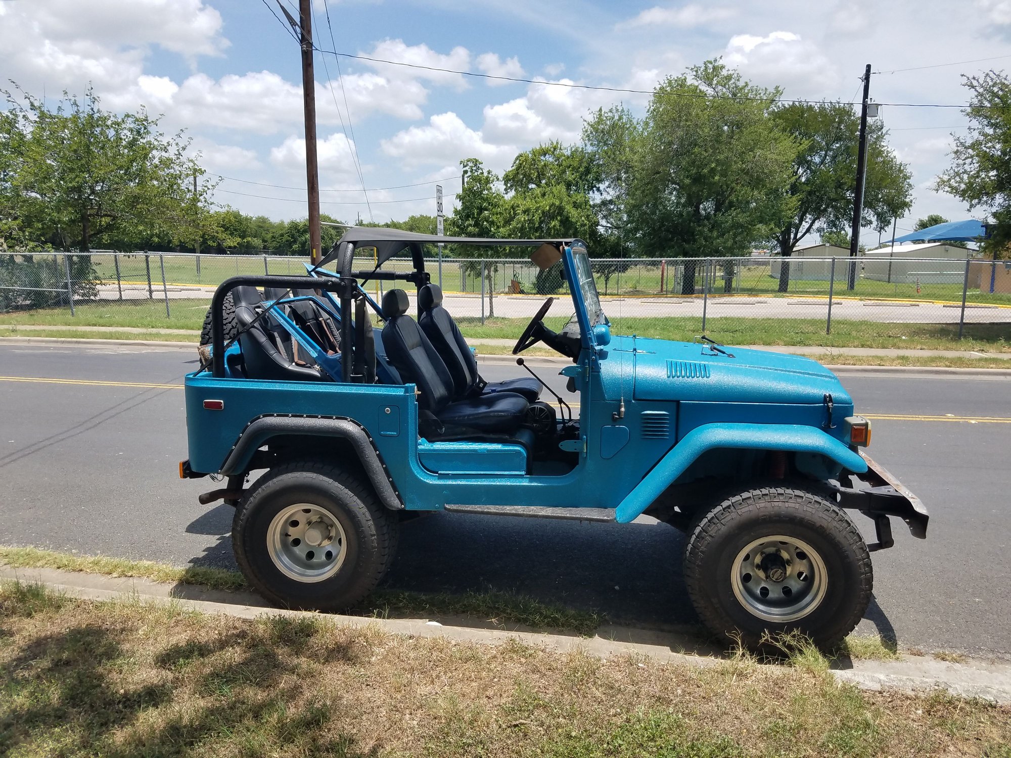

My wife bought me a '78 FJ she found in craigslist. Only 70k on the clock, it starts(with some gas pedal pumping on cold starts), stops, steers, and runs really well. I honestly couldn't be happier with it.

Best of luck with the build... but you tell us about a rare truck, yet not let us have the pleasure of seeing it? Pics or it didn't happen

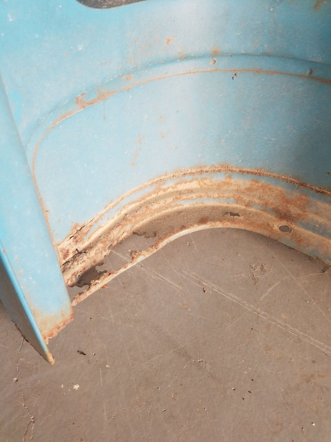

The frame is in great shape. It has some rust, but nothing a drill and steel brush won't take care of.

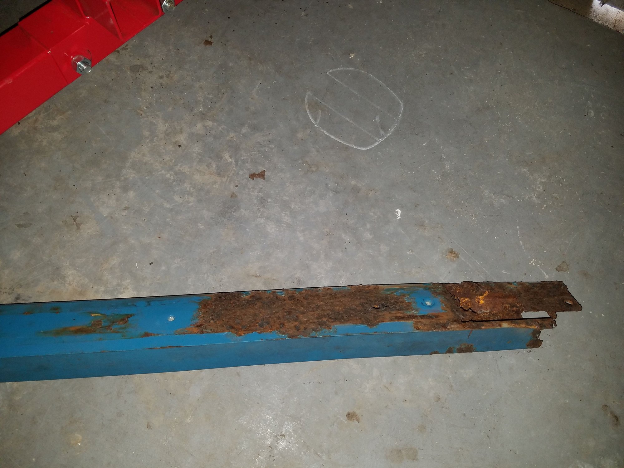

The hard top is a little more...complicated. the rear ends of the side panels are rusted through and will require some cutting and welding. That long piece is what's called the hard top support. It's like the top part of the door jam for the ambulance style doors.
It'll be some work, but all in all, it's pretty sweet.

THANK YOU! Lucky you.
She's beautiful and pretty clean! Yes, that part of the hardtop that rests against the body is where water gets trapped; hastens rust.
