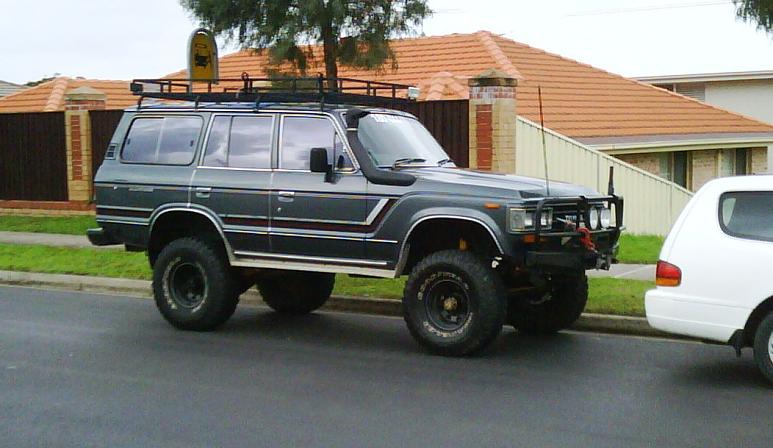

Depending on your expertise, SOA is the way to go.
SOA will get you around 6" and allow you to fit bigger tyres (37's easily) which helps with your under-diff clearance as well as other things.
If your truck is straight, it will look awesome too!
Have a look at mine
