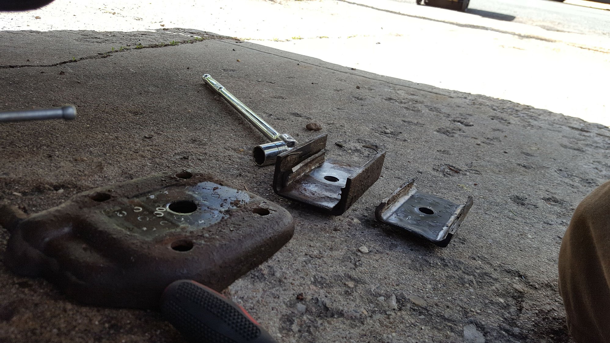

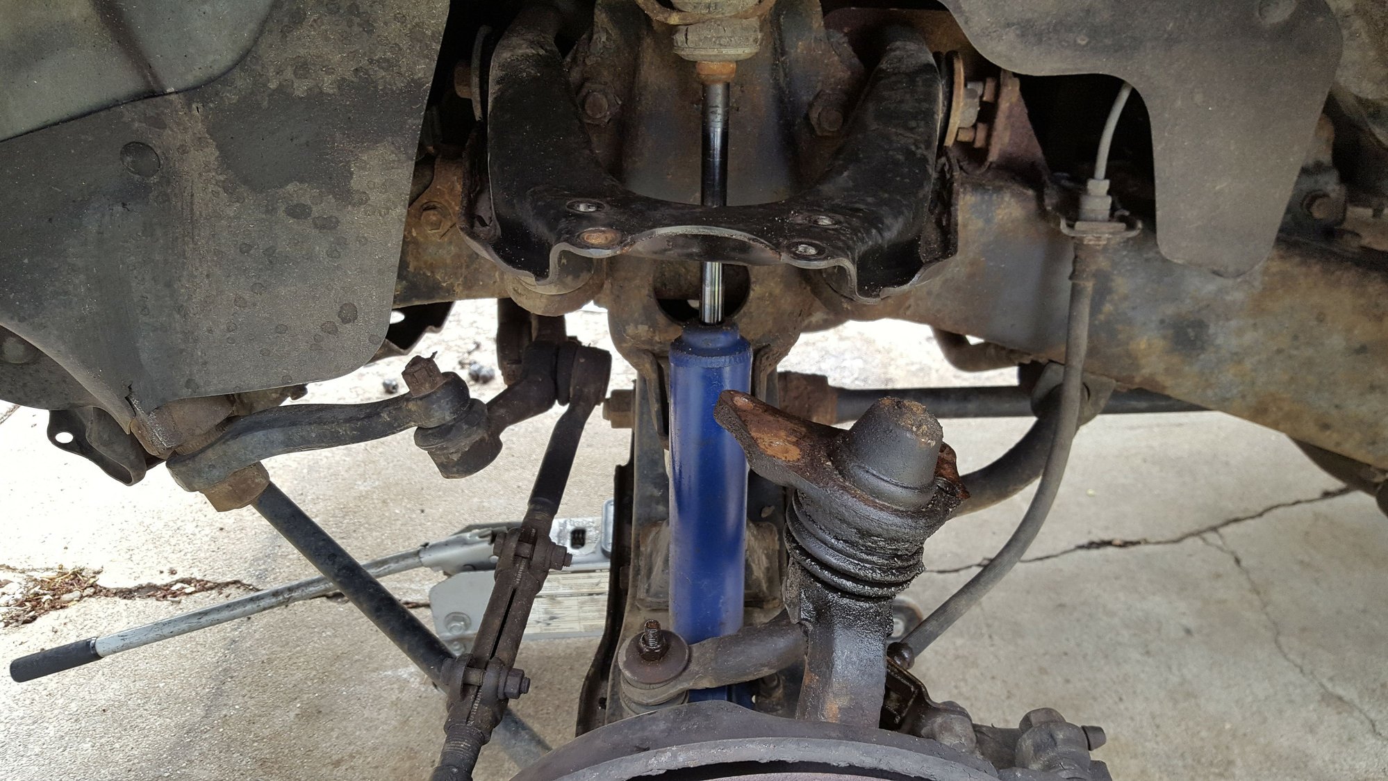

BJ Spacers:
There was some spring action when I unbolted the ball joint bolts.
I had to use some clamps and strategically placed jacks to get everything to line up when installing the new bj spacers. I got the upper control arm brackets too but I didn't realize I needed extra hardware to install them so this is how they currently sit, I'll get around to it eventually...
Basically just jack up the front end, and put a jack stand under the hub and unbolt. Not much to it.
Add a Leaf:
My biggest piece of advice is to go buy 10 bottles of PB Blaster (this is sarcasm, one is fine) and soak your U bolts as many times as possible before this. I cannot overstate how difficult I found removing them to be (let it be noted this truck was mainly driven in Missouri, rust belt) and without air tools you will need a breaker bar and patience. I am a pretty capable 21 yr old and this was the kind of thing where every time you turn the bolt you're giving it everything you've got until it comes off. Once you get them off, I recommend making a nice bath of PB blaster and just let those puppies soak while you finish the install. Going back on was 100x better after that, and using a scotch-brite pad to clean up the threads. Also you don't have to thread them on as far because you have made the leaf pack thicker.
Also don't forget to take your shock off the lower mount!
It doesn't hurt to take a brush/scotch-brite pad to any metal surfaces either.
This is what holds the spring pack together nicely, directly after the U bolt comes off. I was looking all over for a screw holding the two far pieces (left on top, right on bottom) but I just pried them apart with a flathead to expose the bolt.
Throw some c clamps on just so there are no surprises when taking apart the pack. When getting the springs to drop down, I just whacked it from the top with a hammer while the axle was jacked up, it clangs right down.
After you take the bolt out, you can spread the c clamps out to put on the add a leaf. The little nubs at the ends should keep it from falling apart without clamps.
Fun fact, the new bolt was about an inch longer than shown, and I had to cut it down twice, once to get it in, the gap was just shorter, and once after threading the nut. slowly clamp it together using the bolt to guide it and not by tightening the nut cause you'll strip it out. once you get it clamped tighten up the nut and reassemble. For me, my U bolts were just long enough that I could reuse the stock ones, but it was tight.
The difference is quite startling I would say! In a good way.
