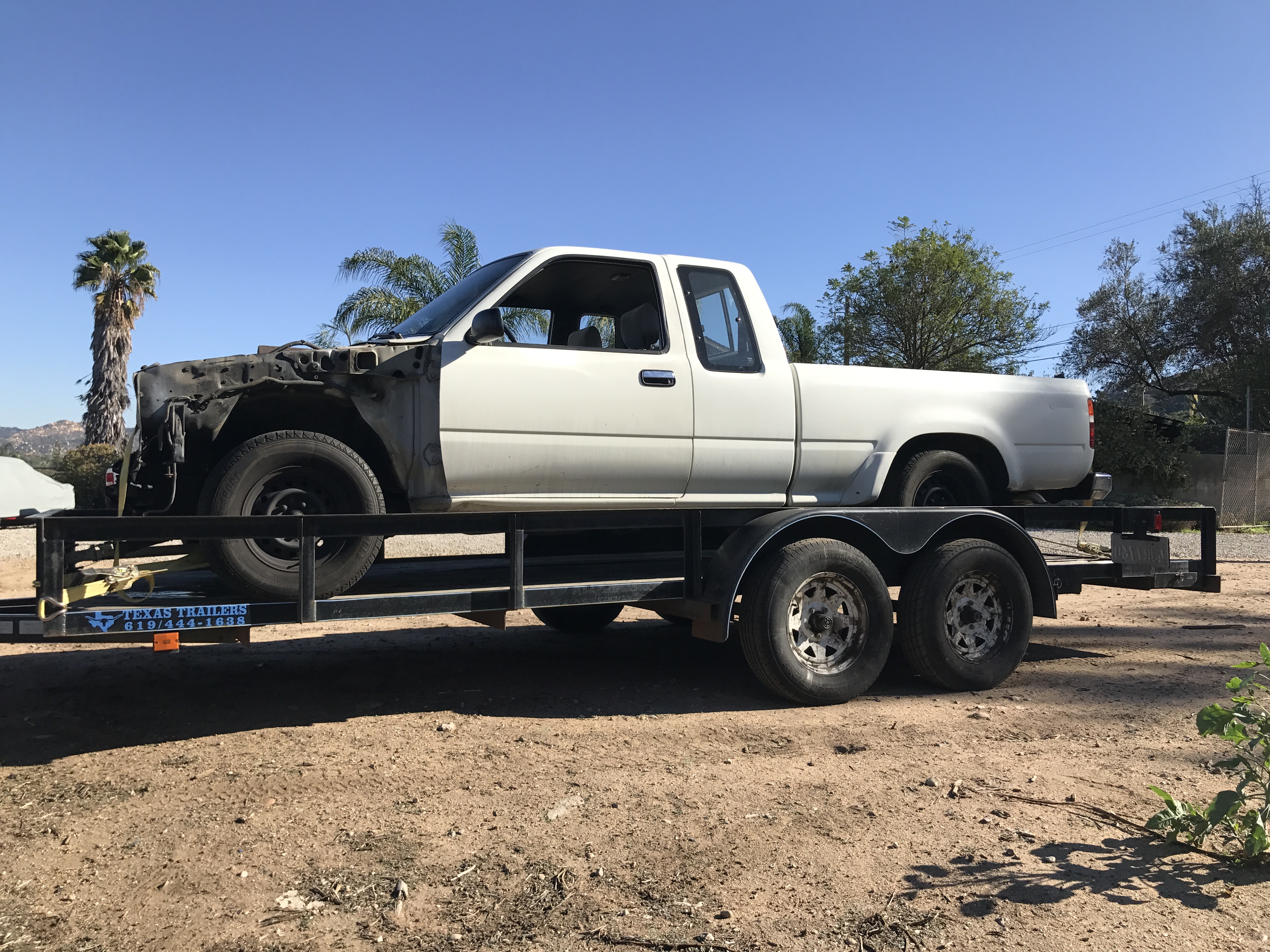

Been a while since I've had a Toyota. Definitely happy to be building one again! This was an unplanned build. I had a regular cab truck sitting in my yard for about a year that I planned to just clean up and sell. As I was getting it ready to sell, I happened to come across two other pickups, and the snowball gained momentum quick! Truck one was a basket case that had sat in someones yard for a decade. It was equipped with a Fabtech 3" over long travel kit, and the old school Gold Line Hubs, I also plan on using the classic Outlaw 2 wheels, intake, and muffler that came it. I got the truck for dirt cheap, and lets just say everything I need from it will be "free" by the time it's stripped and re sold. Truck number 2 is a 94 extended cab 2wd pickup, with only 185,000 original miles. The timing chain was recently done and it was the guys daily driver. It's got AC, power steering and is overall really clean. The catch, is that the front end took a good hit, but only suffered cosmetic damage. 94 Prerunner Build-oafmwzr.jpg 94 Prerunner Build-i7qu1ss.jpg 94 Prerunner Build-notlksa.jpg 94 Prerunner Build-x162h6l.jpg

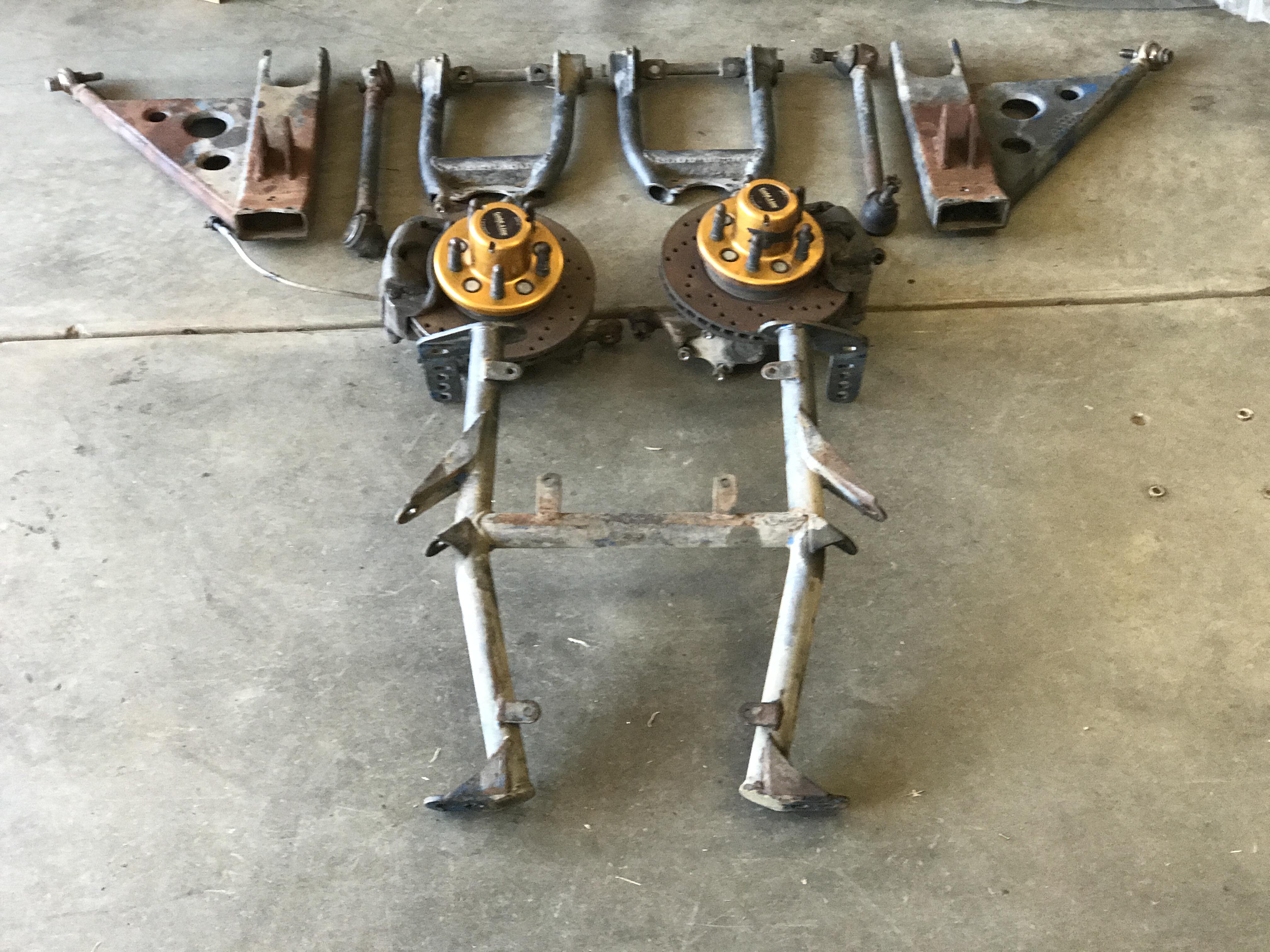

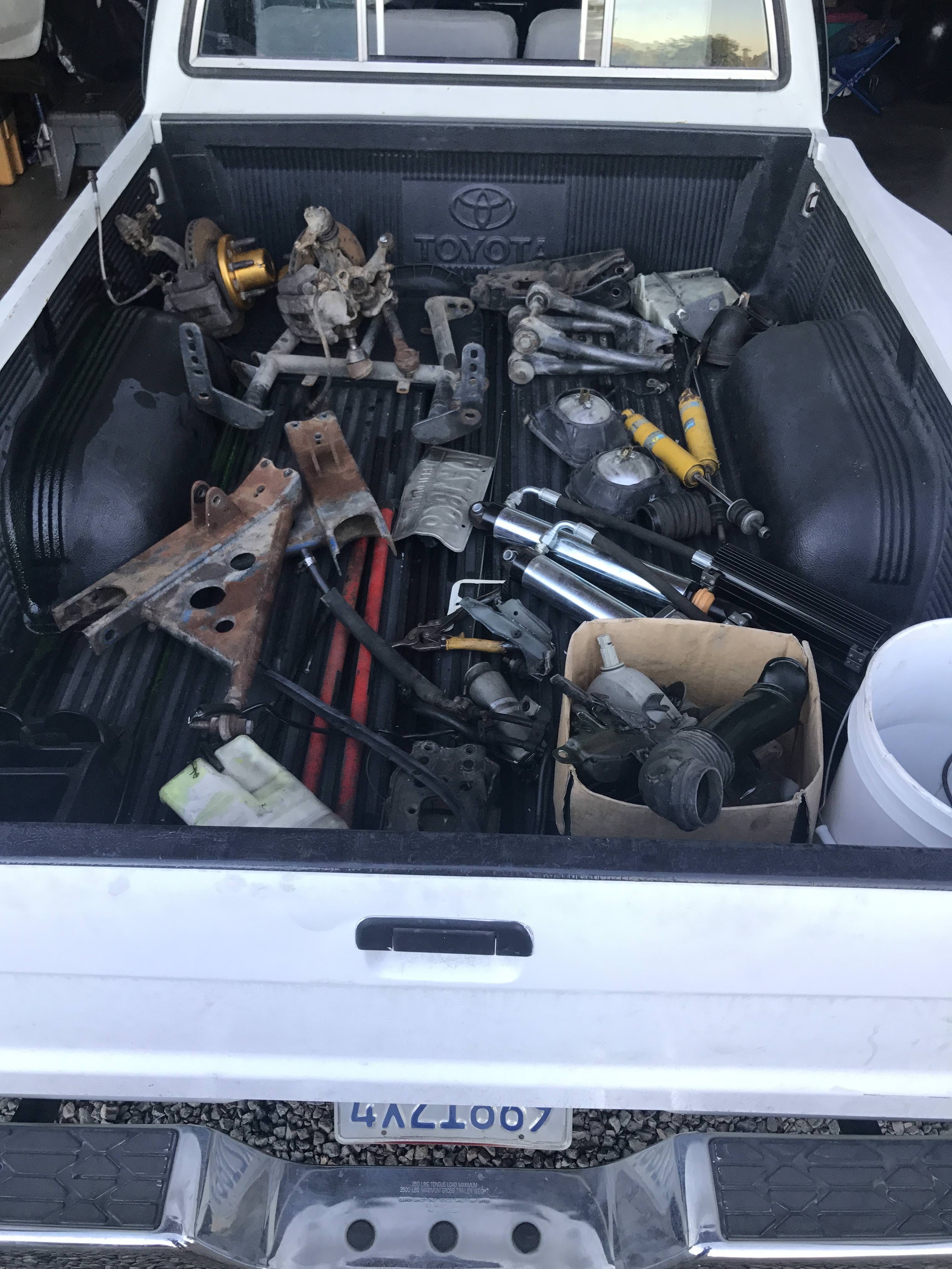

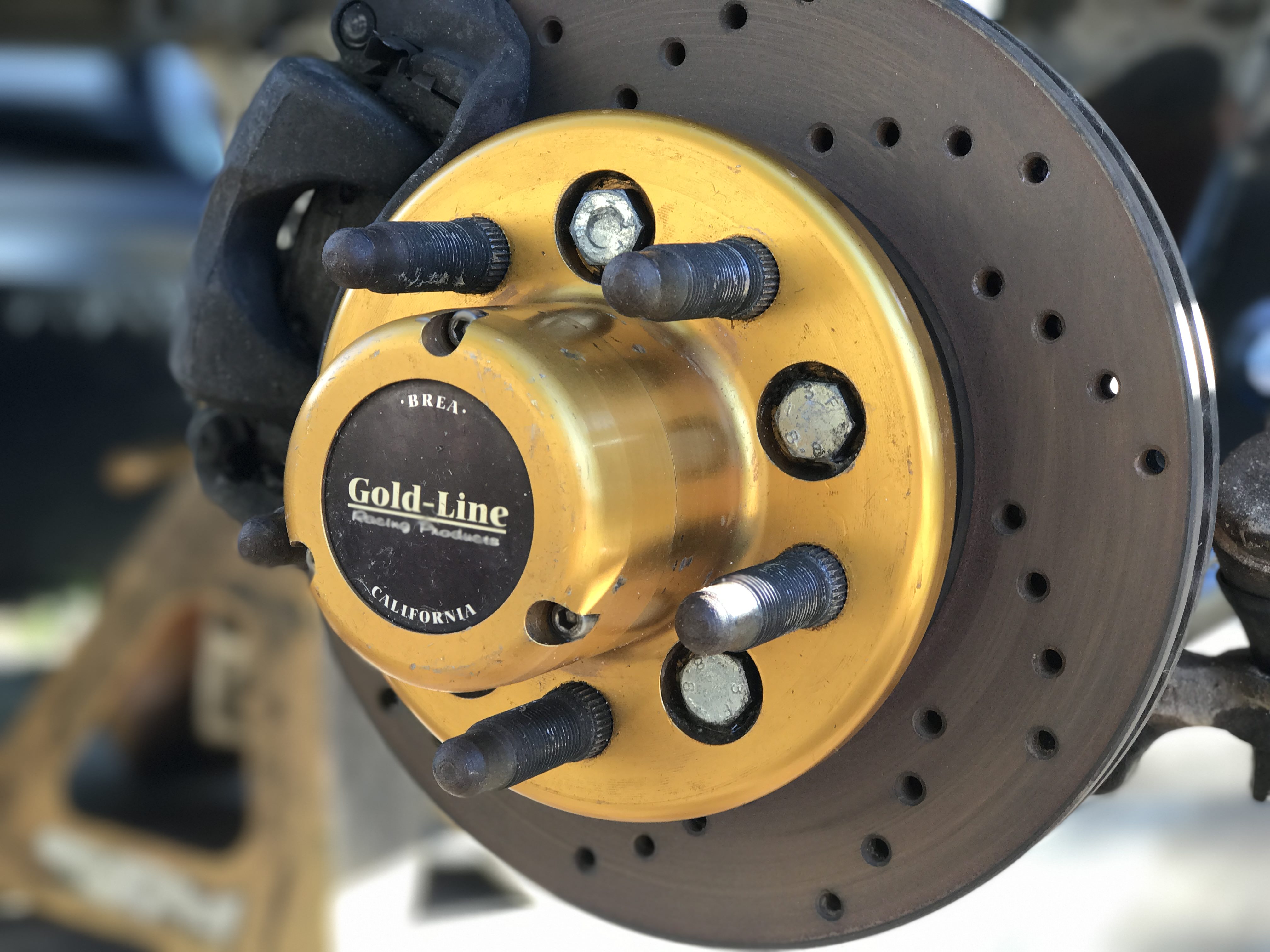

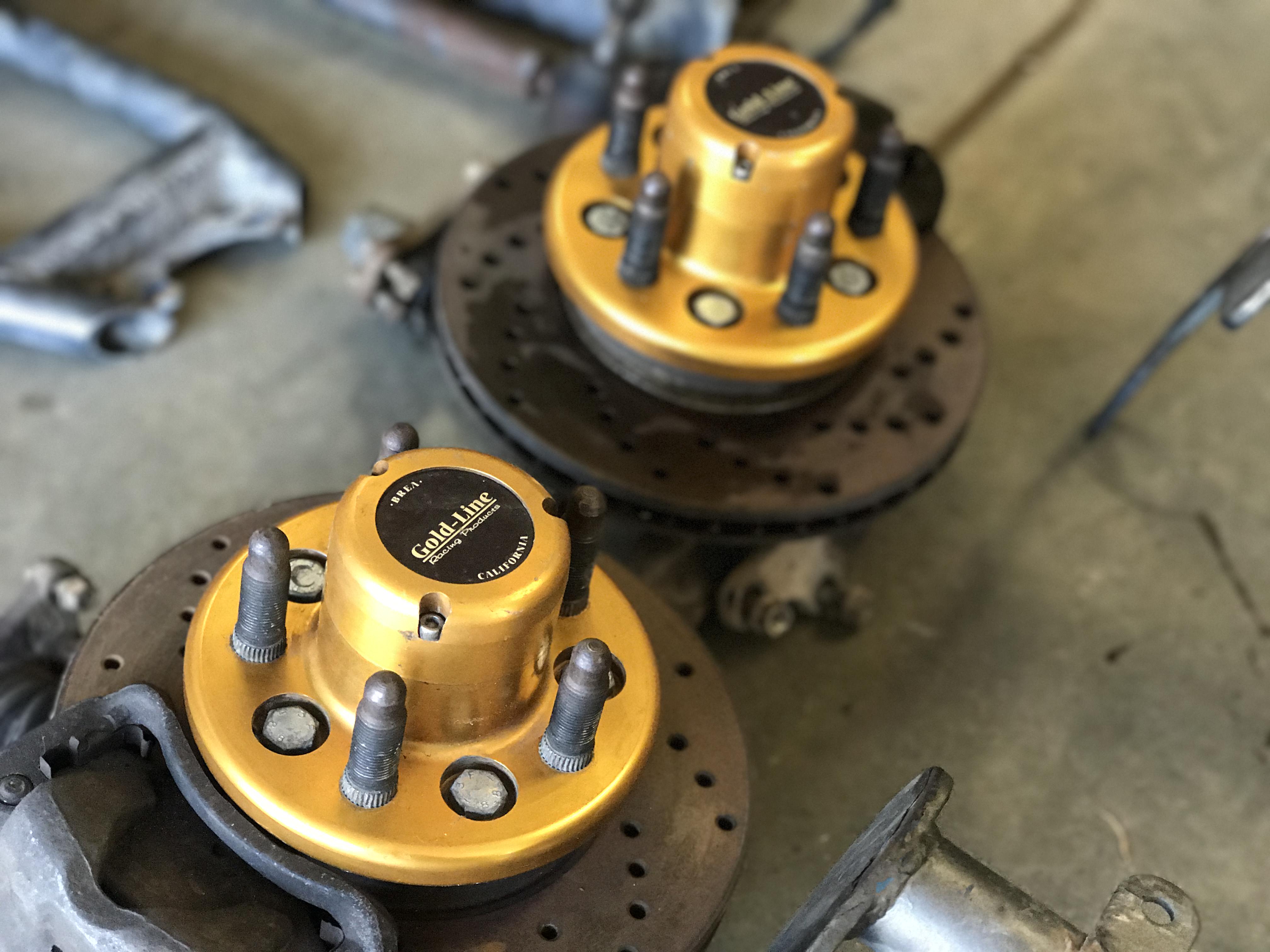

Got to love these Gold Line Hubs!!! 94 Prerunner Build-pptq5ly.jpg 94 Prerunner Build-7fnmnil.jpg And here's the complete kit, it definitely needs some clean up, and I will be plating a few areas to keep it alive. 94 Prerunner Build-slxphre.jpg And here is the parts pile. 94 Prerunner Build-83juqvq.jpg

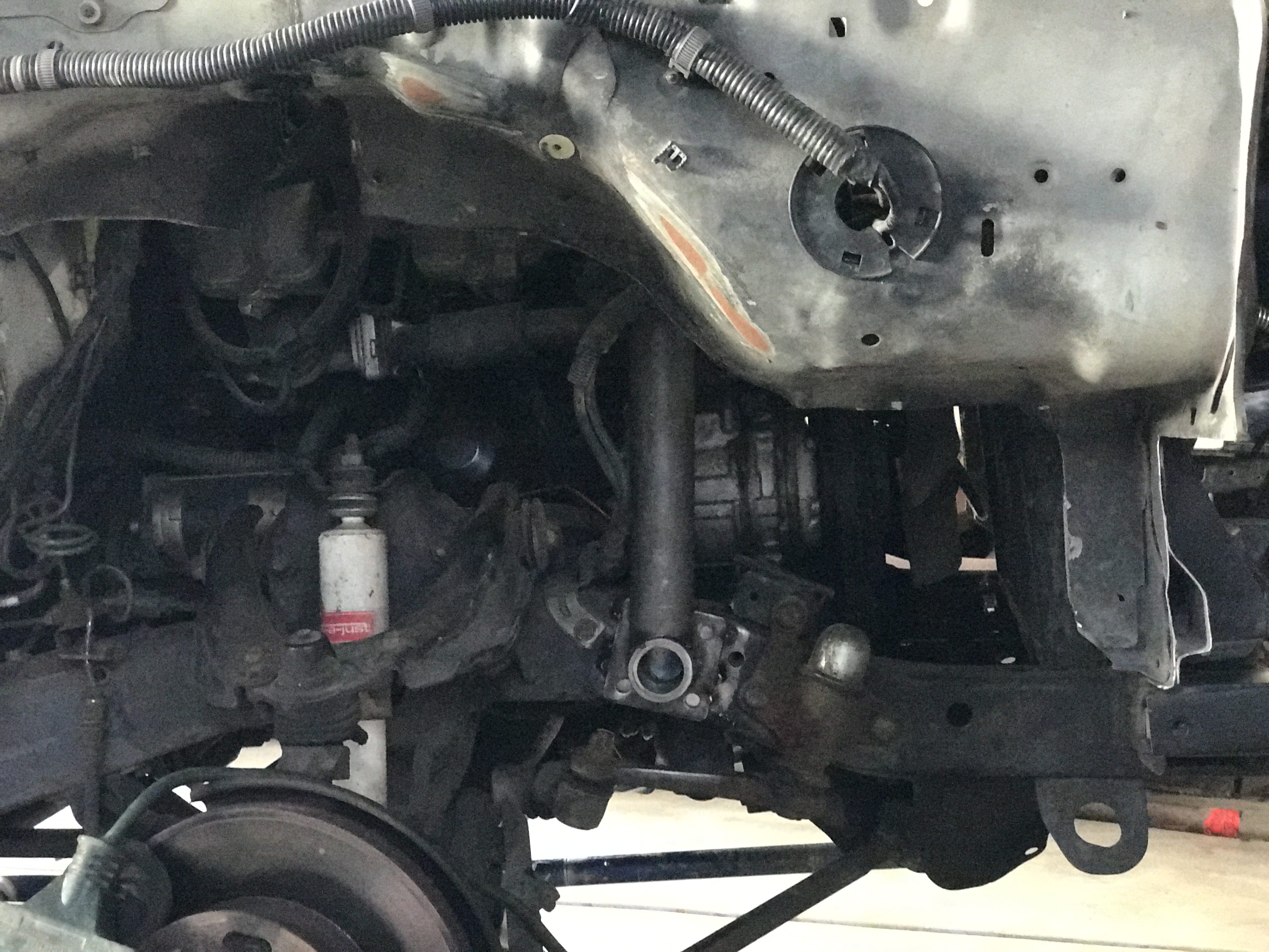

The front end had taken a fairly hard hit. It smashed the radiator into the clutch fan, and put a pretty solid buckle in the passenger side core support. I am crossing my fingers that the water pump is ok, and I can get away with just replacing the fan clutch assembly. I was lucky that all of the impact was above the frame rails, they measured consistently from side to side.

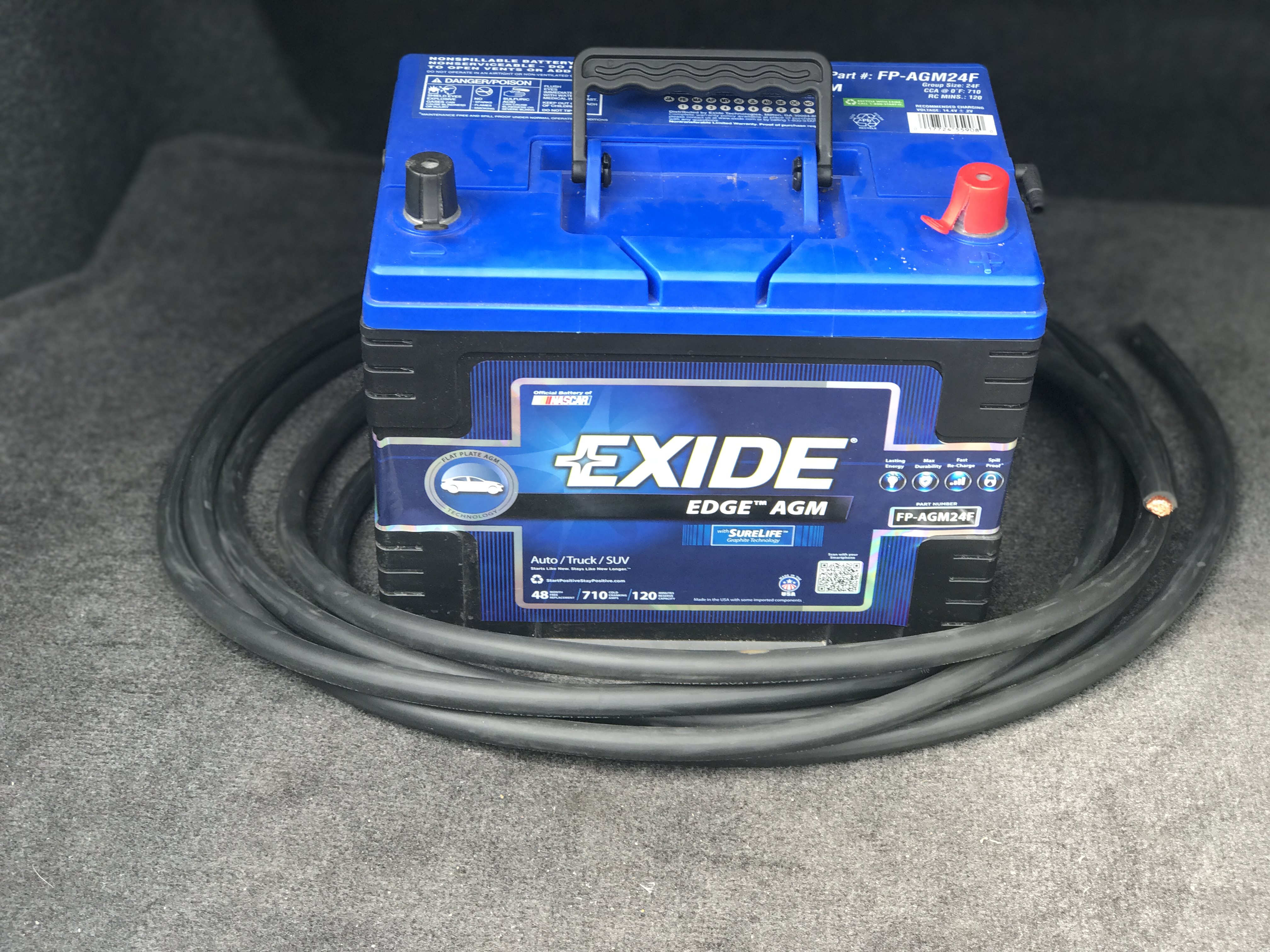

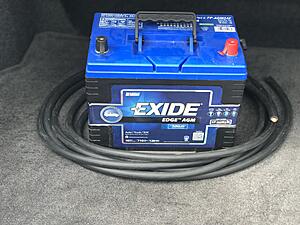

I'm pretty picky about batteries, & especially with this truck being an automatic. I plan to take it deep into Baja, 100+ miles from civilization. I'm not a fan of Optimas, & I think Odyssey's are over priced. I had a few other smaller sized options, but ended up with this group 24 Exide AGM. I wanted something bigger to keep the tunes going during soda breaks & I didn't need massive CCA's. These batteries have good reviews, and a good warranty, and it was only $150. I also picked up 20ft of 1/O wire to relocate it to the bed and into a metal storage box.

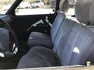

Cleaned up the interior. Overall, it's in great shape. With the battery hooked up I finally got a chance to check out the stereo. It came with a nice Pioneer with Bluetooth/USB and & Pioneer speakers mounted up in the extra cab. I'll definitely be doing a tablet mount mount soon.

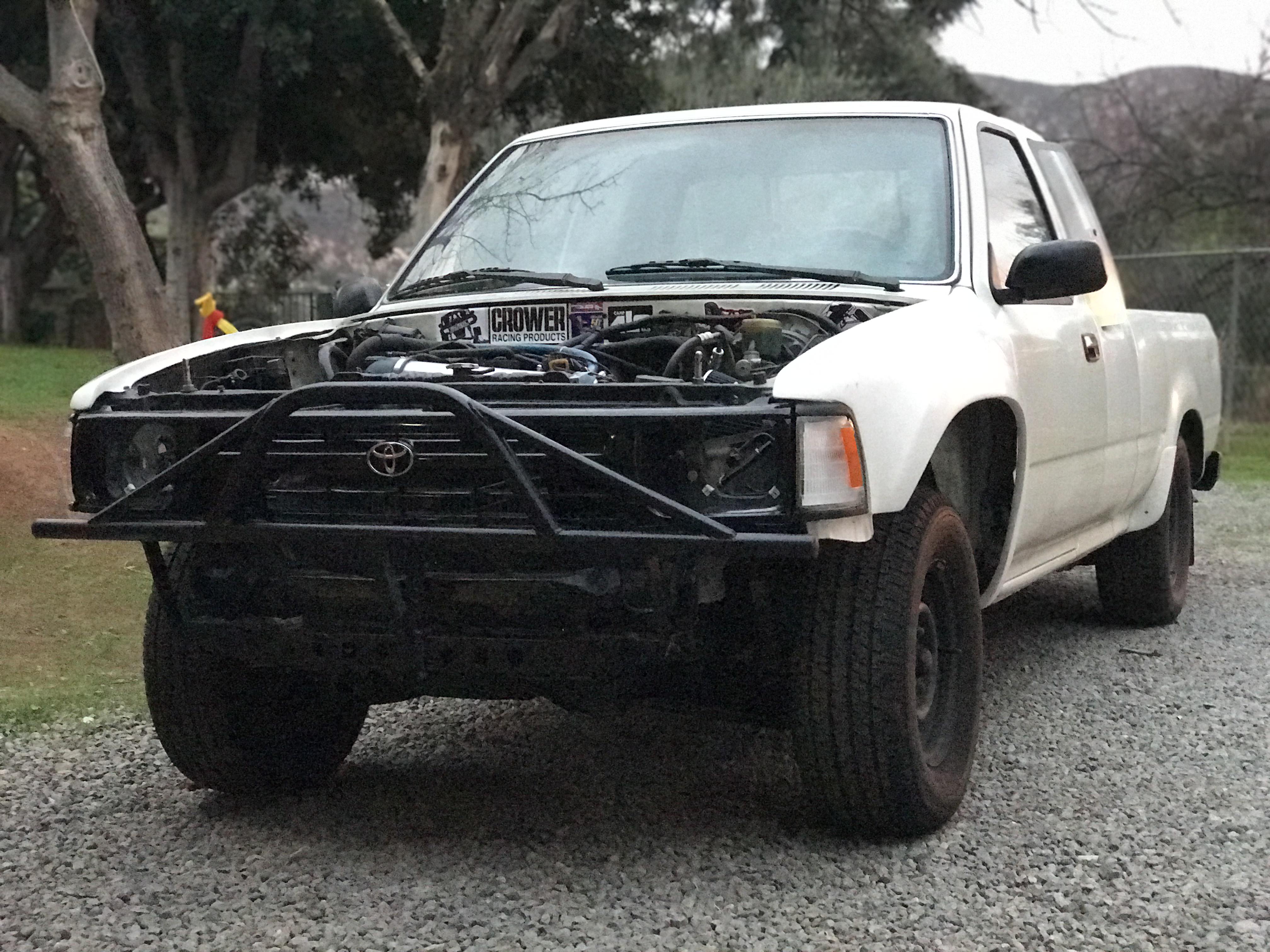

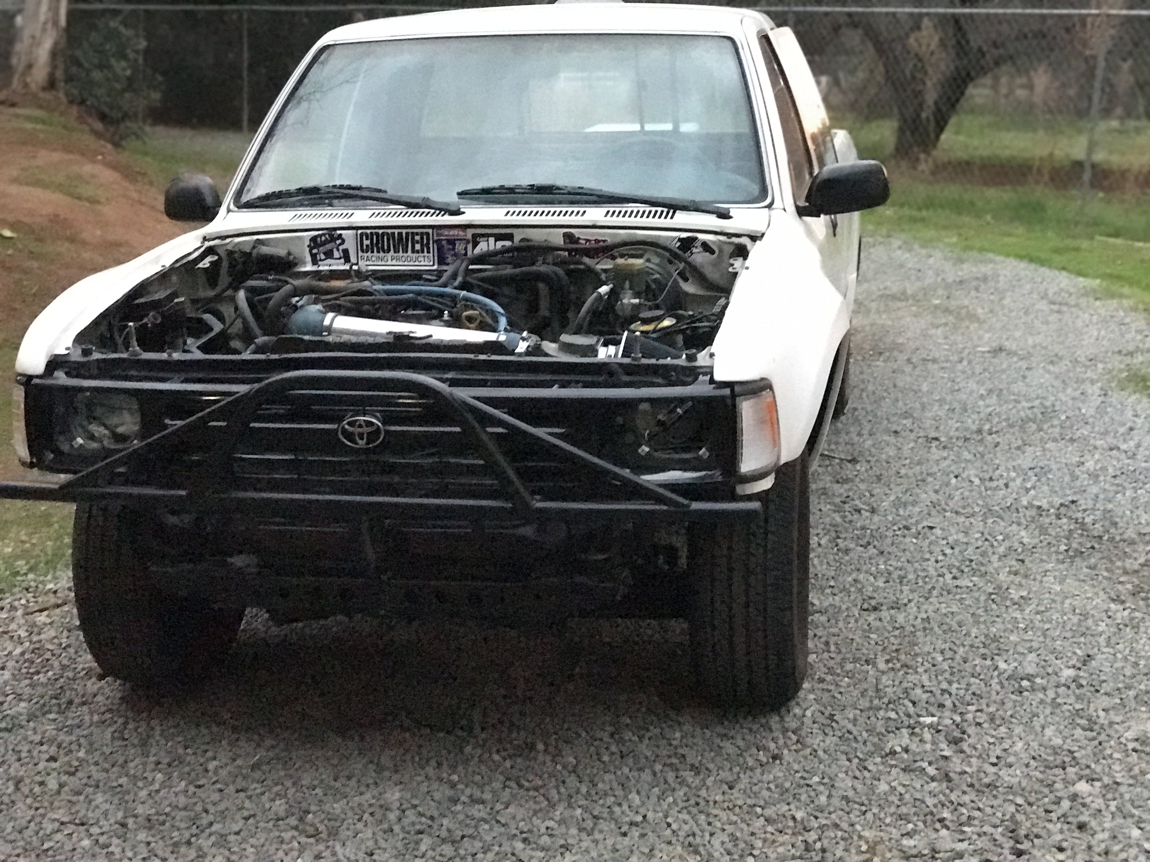

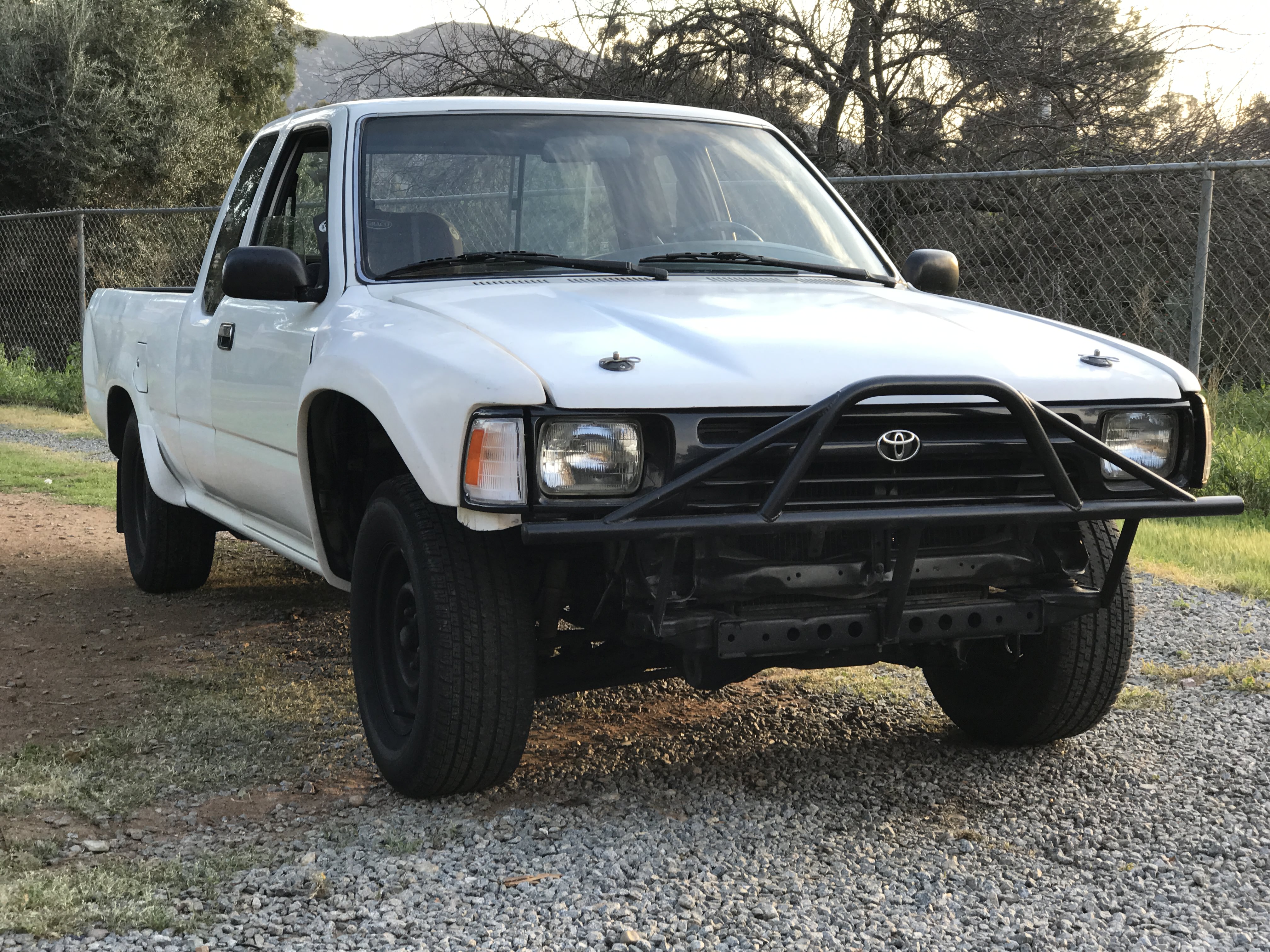

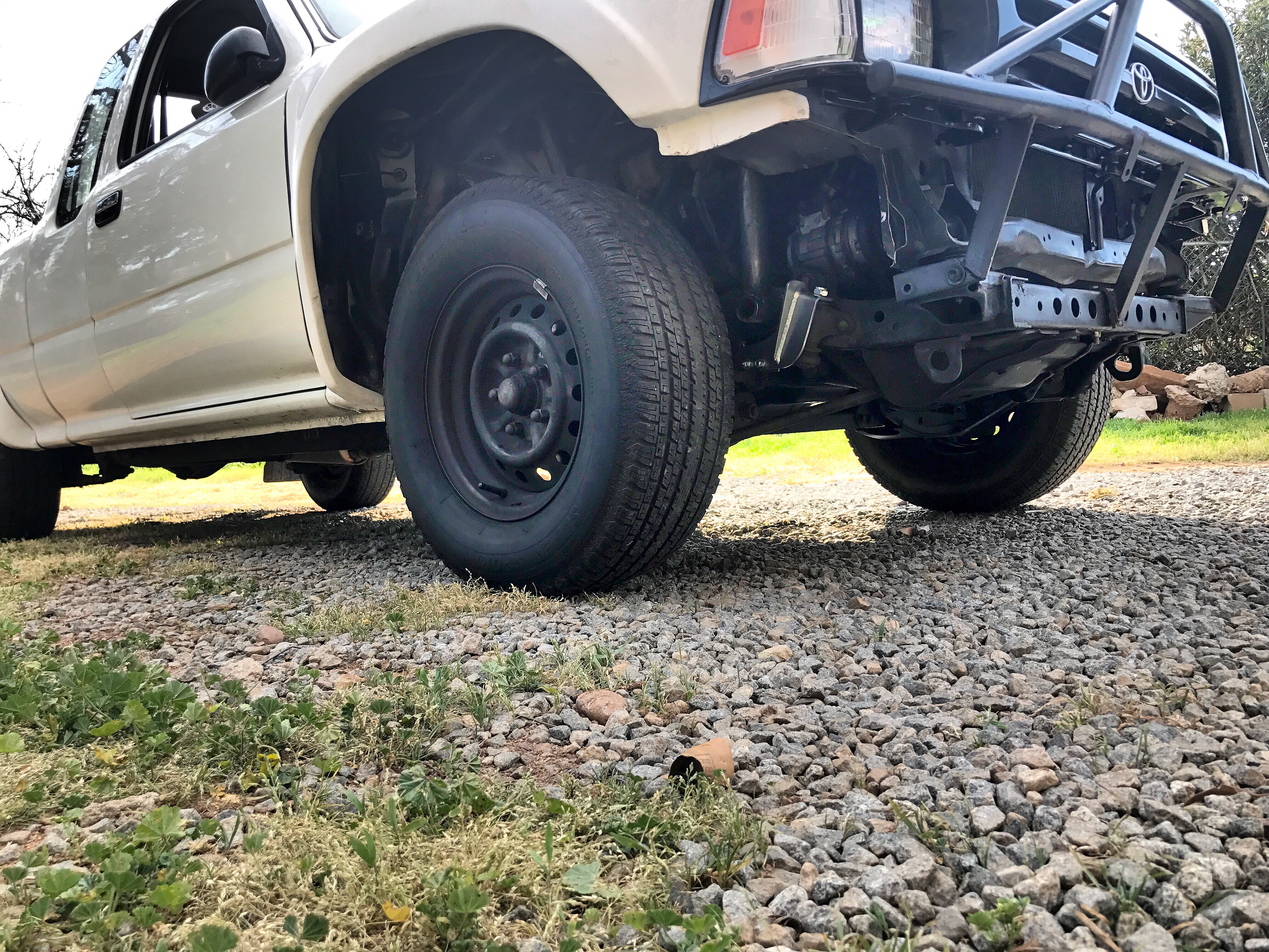

Truck is now running I still need to tie up some loose ends, but it fired right up on the first attempt. I was able to pull it out of the garage and bolt up the perfect era correct "push bar". Don't think I can call it a bumper quite yet. It'll keep me out of some light trouble, but it's definitely not doing any nerfing.

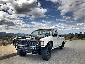

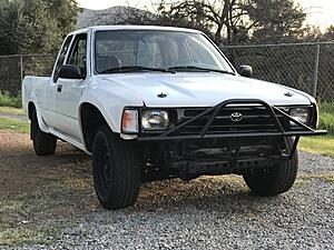

Riding dirty to get a few street miles. Definitely have an exhaust leak, but so far so good

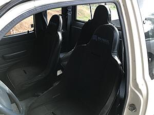

Definitely needed to make this a 3 seater. Seats are not mounted yet. The rear seat will go down a little and the front seats will come up a bit, it should even out pretty nice.

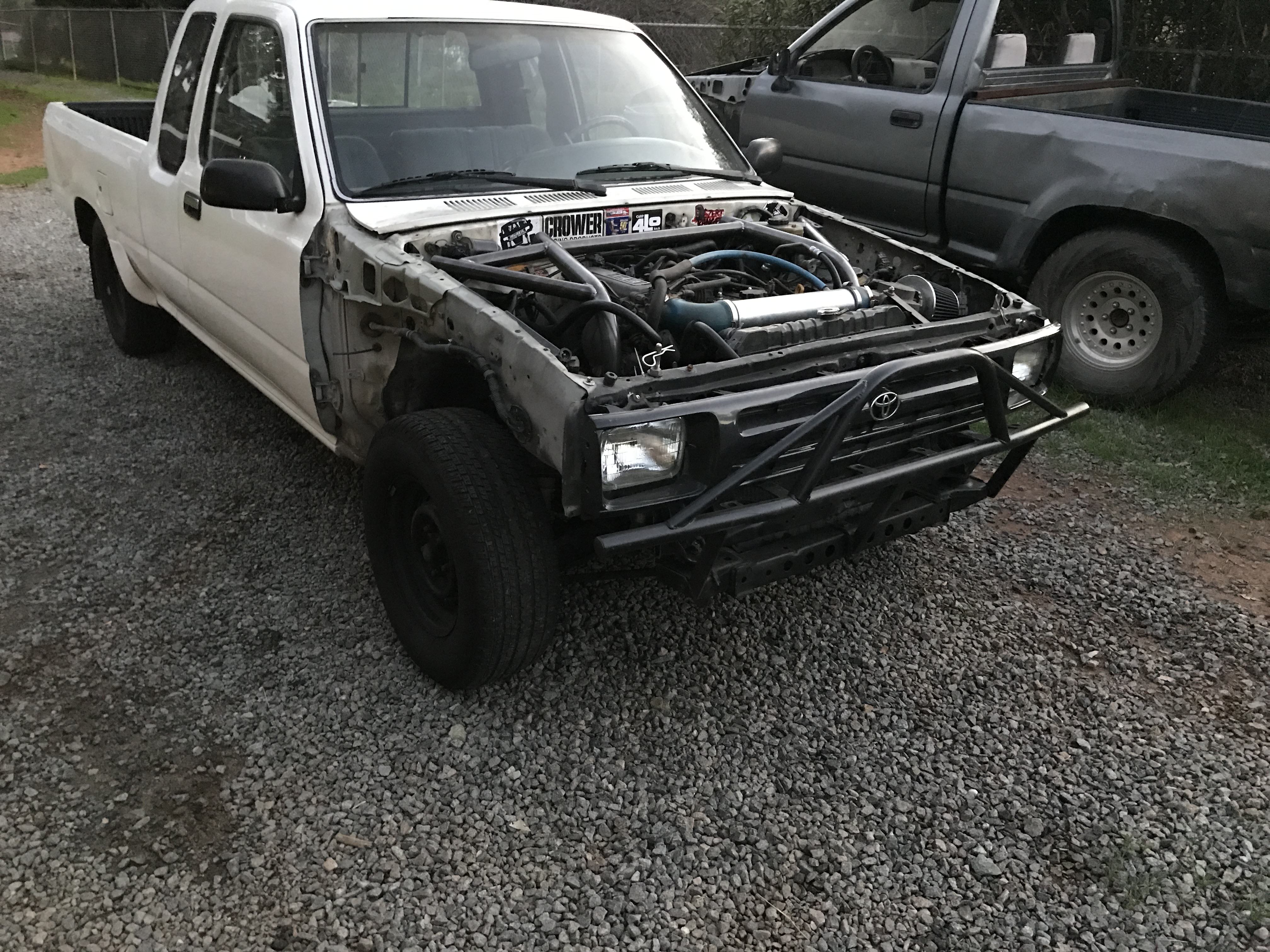

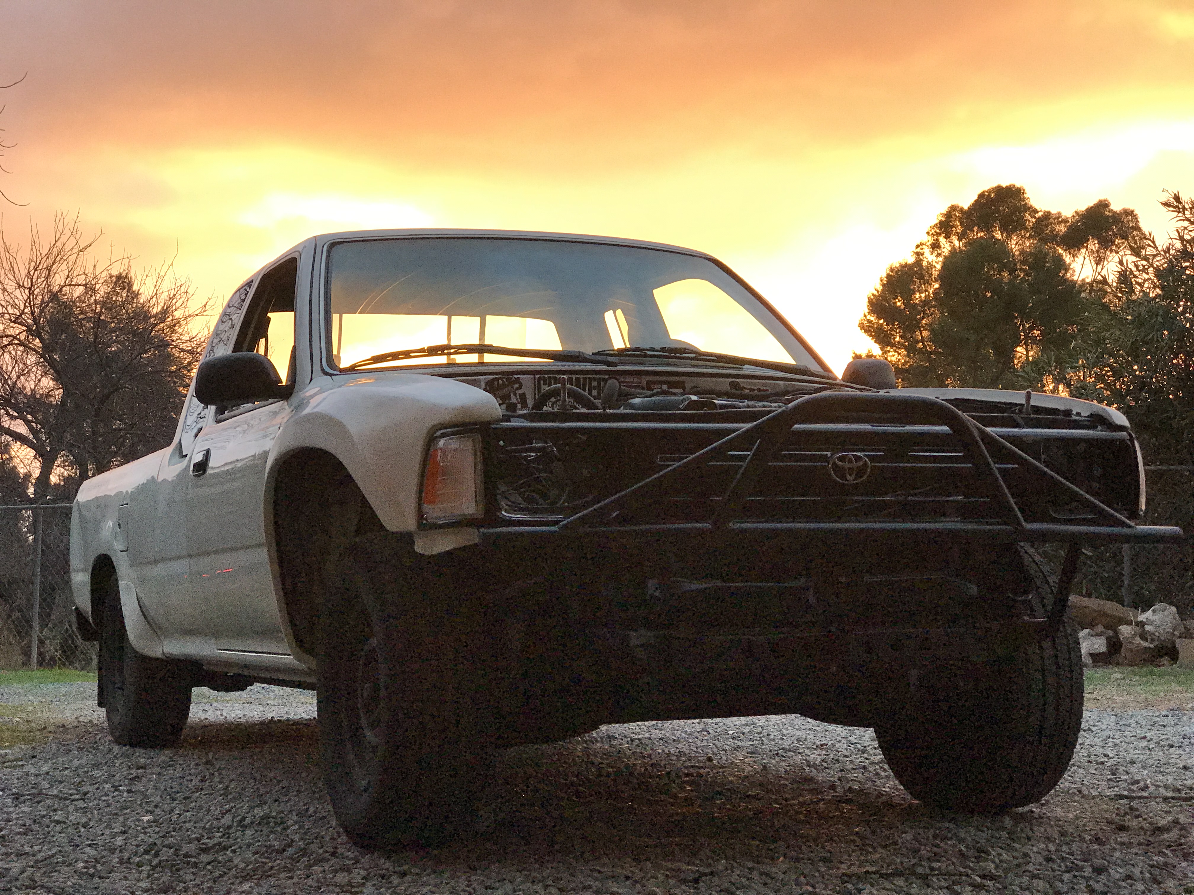

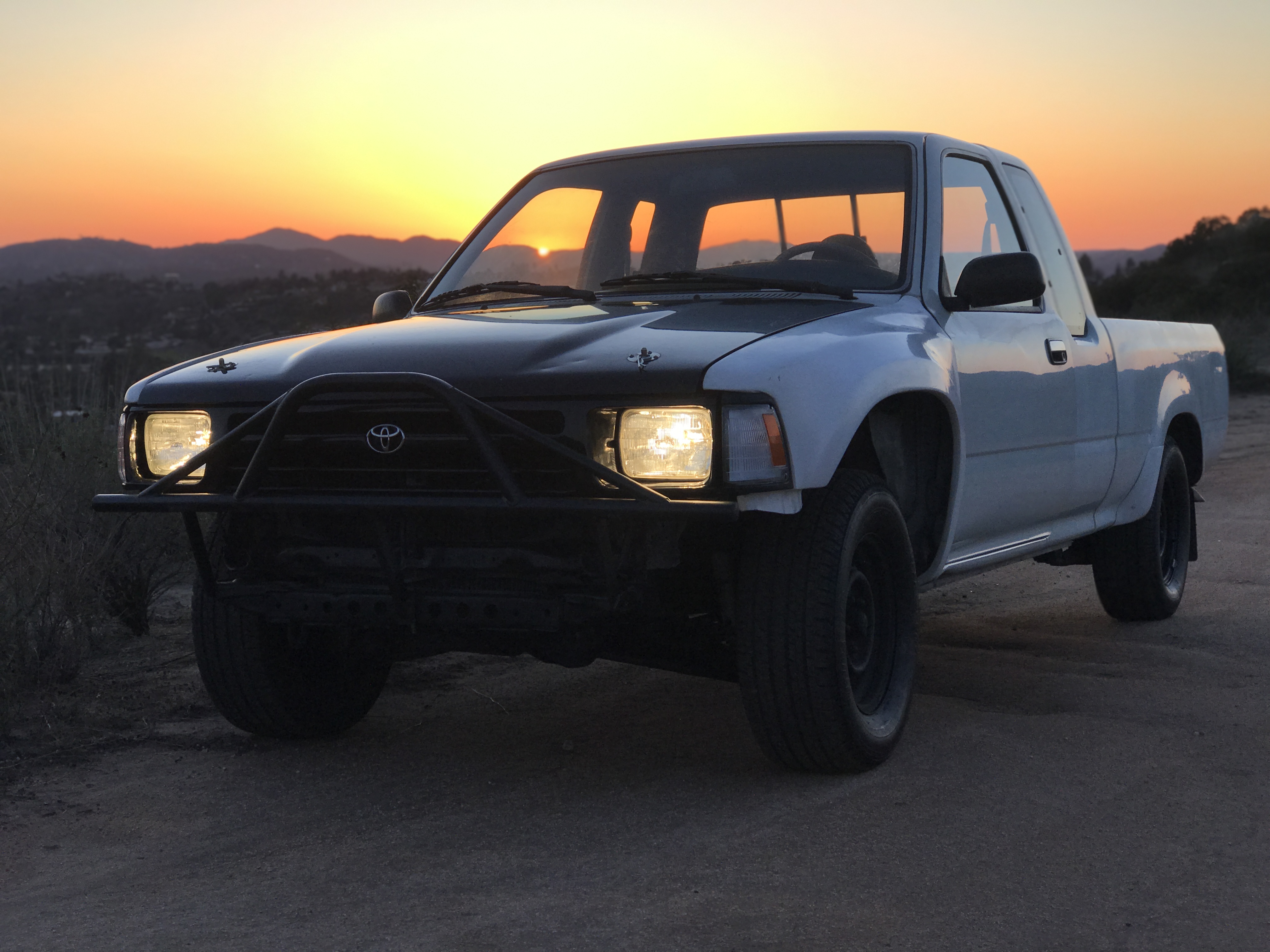

Just about ready to start putting some miles on this thing. I was able to use the core support and stock headlights/mounts, so that saved a ton of effort. Almost time to tear it down for the suspension!

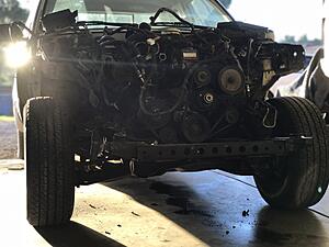

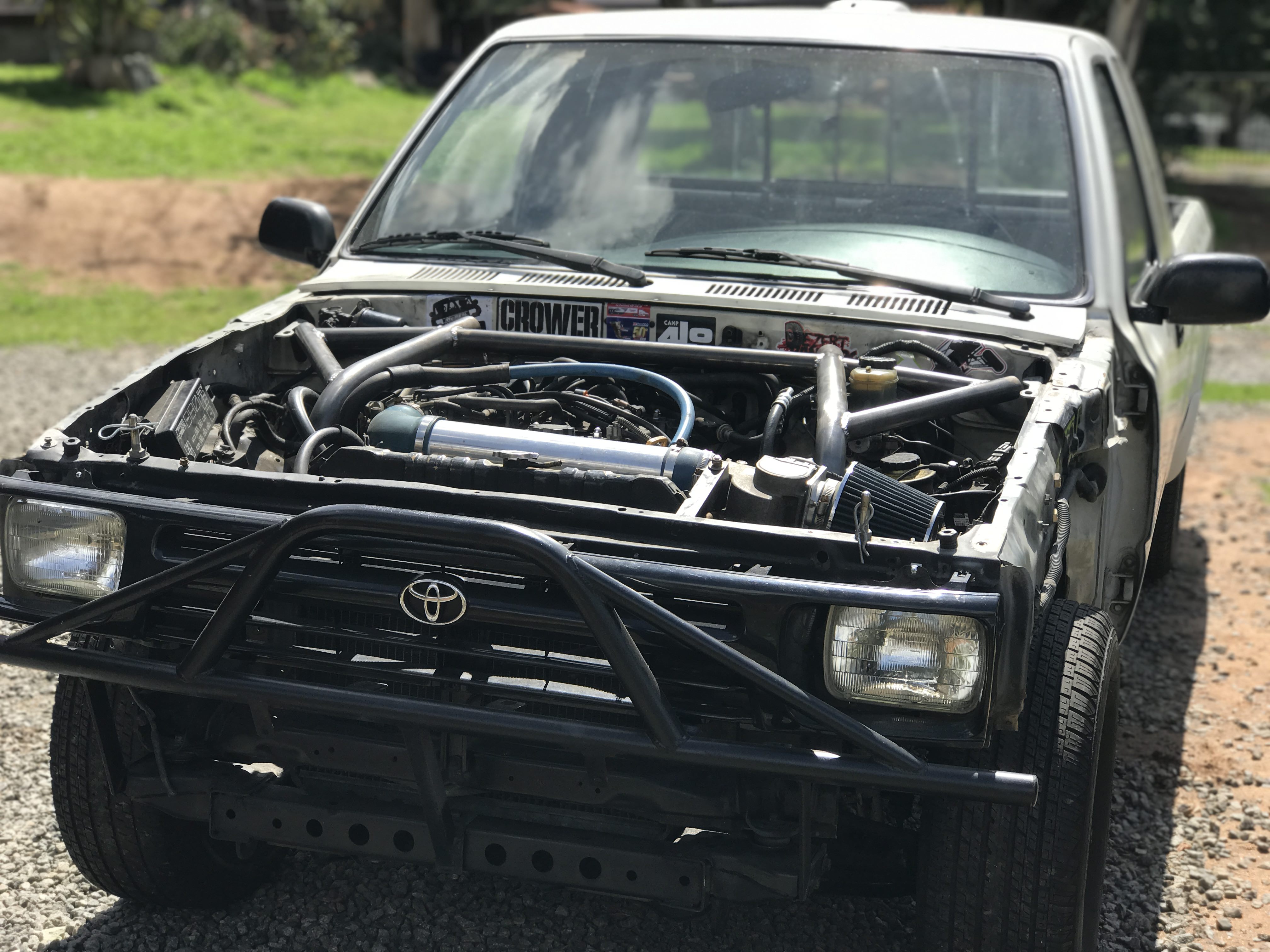

Some progress. Gotta love an engine cage on a stock 94 Prerunner Build-izifgps.jpg

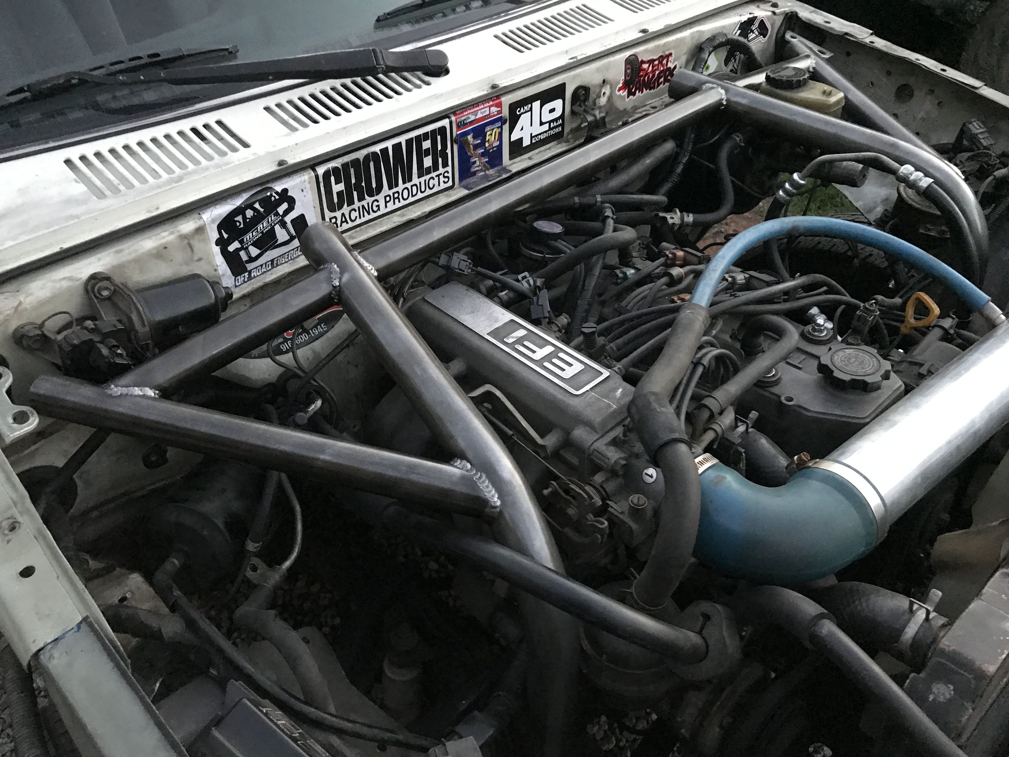

Here's a few more pics. What you're seeing is all that's done right now. I still need to do the vertical, & diagonal tubes in the rear. The two pieces with bends are 1.75, & the rest is 1.5. I only have a 1.75 die, so everything that needs a bend on this build will be 1.75. Other than the main cage structure, I want to do as much 1.5 and smaller tube as possible.
Kicking around these ideas
- A bolt in X over the motor with 1.25 tube
- Core support delete with a bumper/radiator structure that bolts into where the bends are, and off the top of the front of the frame rails

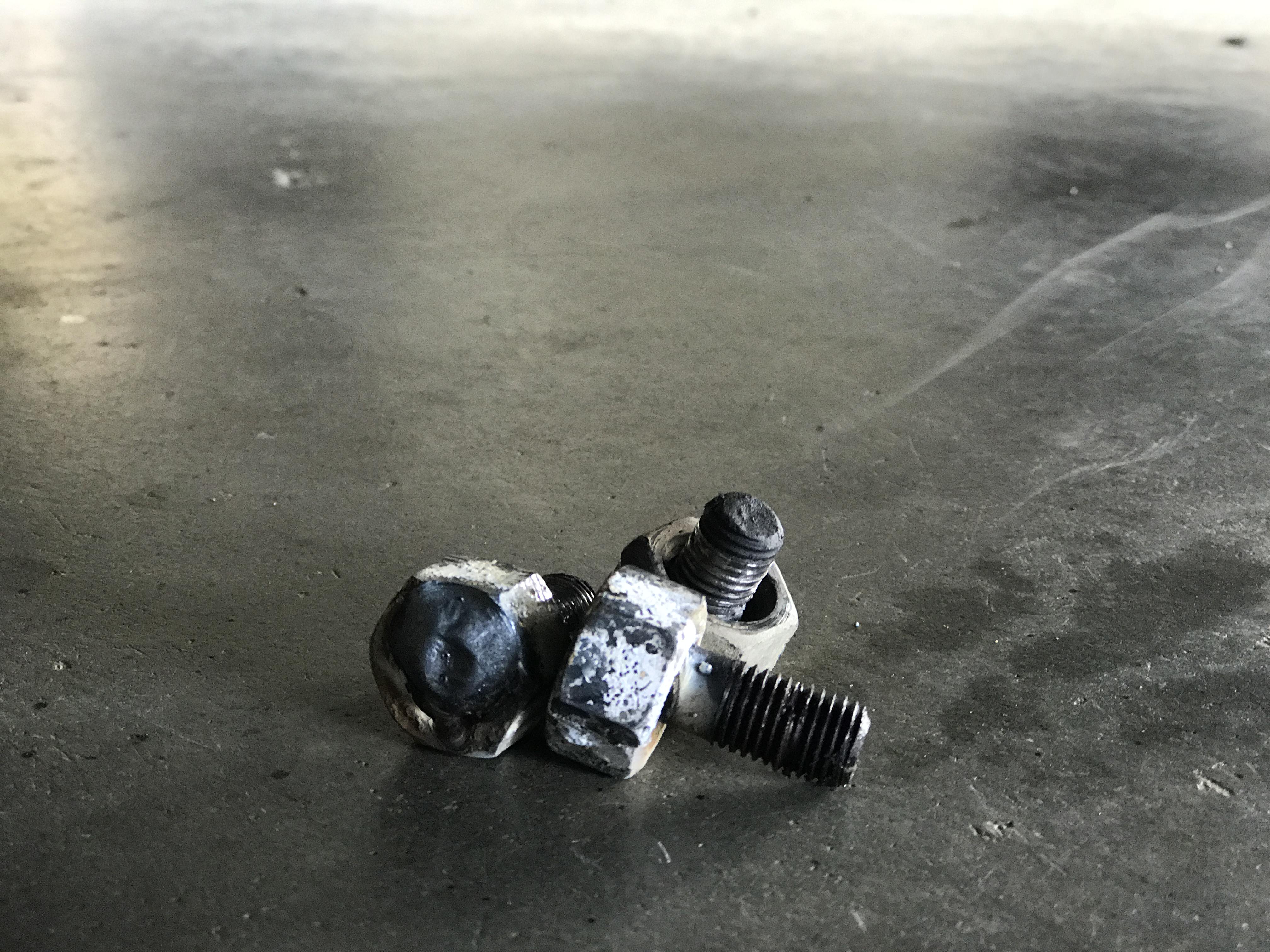

Learn something new everyday. Apparently you can fail smog with a high NOX reading because of an exhaust leak upstream of the cat. Even a very small leak can cause this, and my leak was huge. The exhaust manifold to collector flange was the culprit. All 3 studs were pissed off, and in hindsight, some heat and wd40 may have helped. I managed to snap all of them. I got extremely lucky and was able to weld a nut to each stud with a hot and heavy weld, and then quickly pull each one while smoking hot. Disaster averted, manifold stayed in place, and a new cat and Flowmaster will go in with the re-assembly.

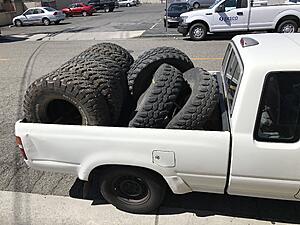

Found a class 10 team moving up to 35's and scored on 9 33x10.50R15 BFG's

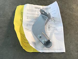

Blast from the past, brand new, never used Downey idler arm gusset!

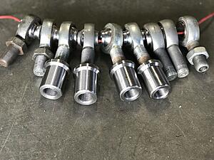

Also picked up some new to me FK heims that are plenty tight and bungs for new tie rods. The kit came with oem style tie rod ends that are seized into the tie rods. The FK's and some 1.5" chromoly will be a nice upgrade.

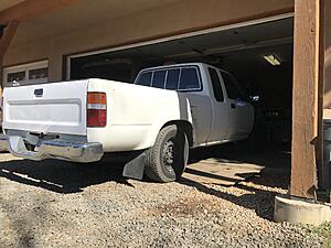

Final news of the weekend is a set of F67's & 12" shackles. The plan is to keep the factory bed/bedsides. I'll need to upgrade to an 8" rear end, & tub the wheel wells for tire clearance at bump. I'm thinking at only 3.5" over up front, the factory rear end with maybe a 1" spacer will look pretty good. I think it will have somewhat of a sleeper feel with 18" of wheel travel in the rear!
