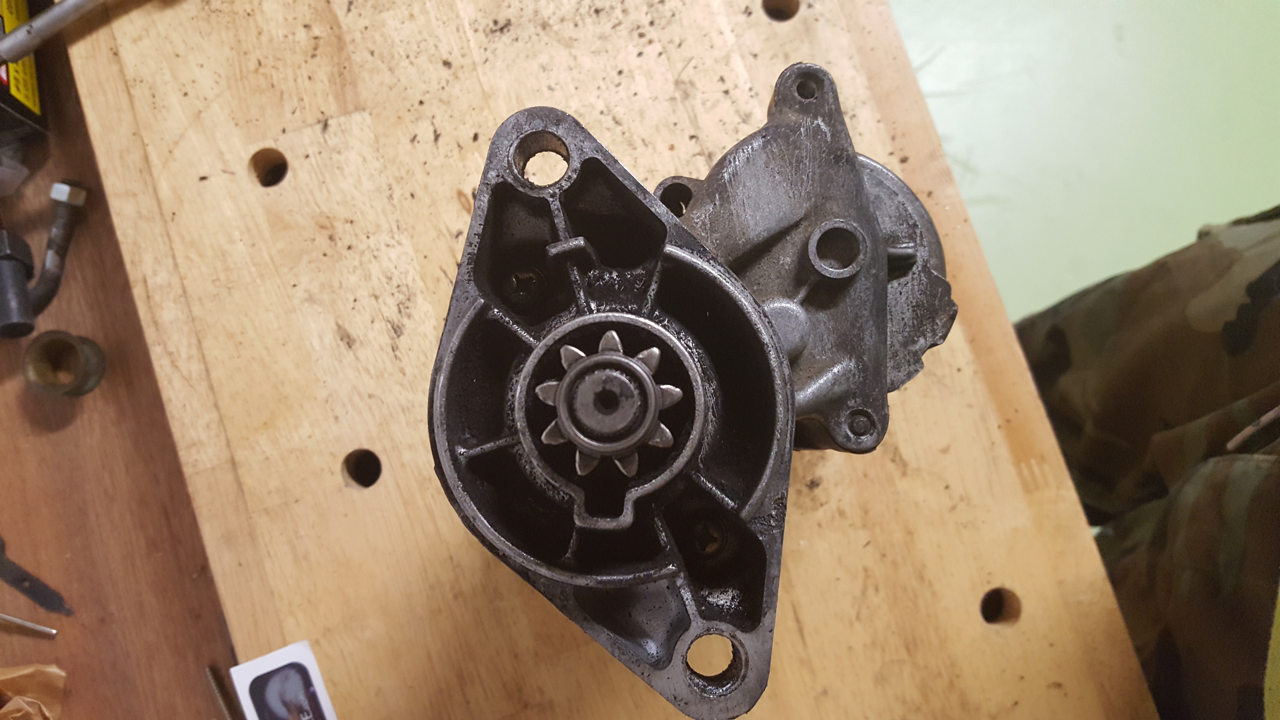

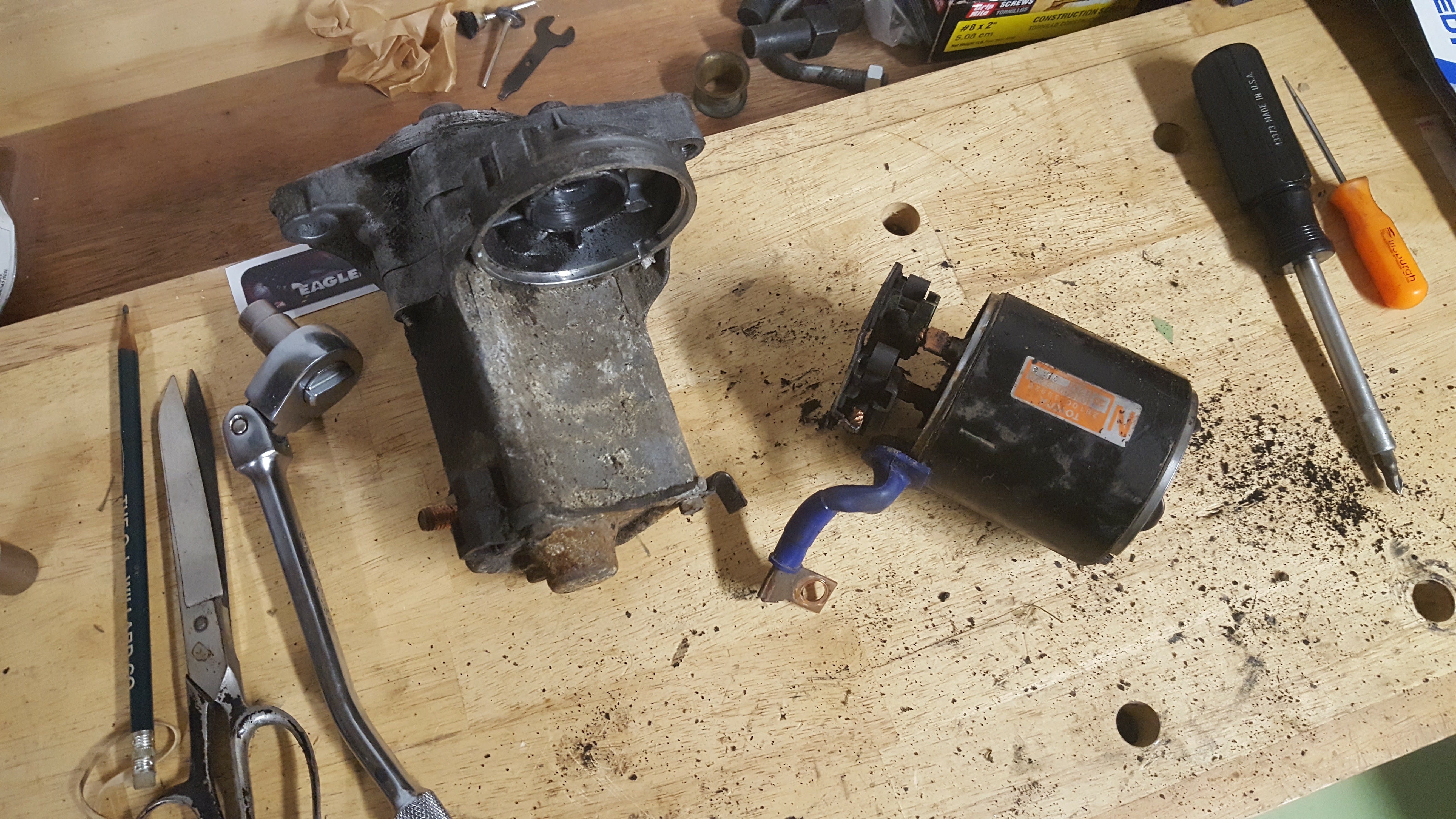

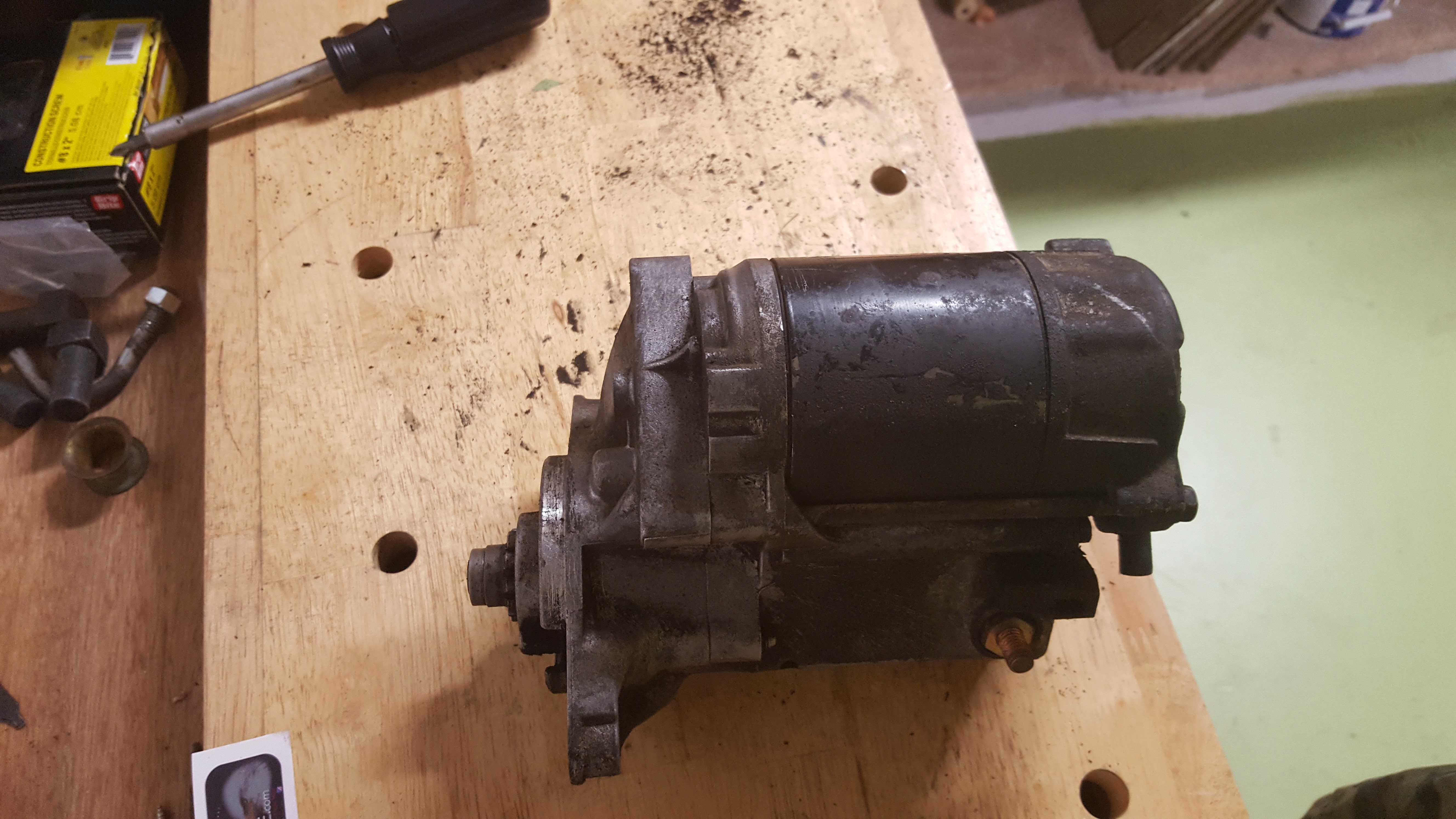

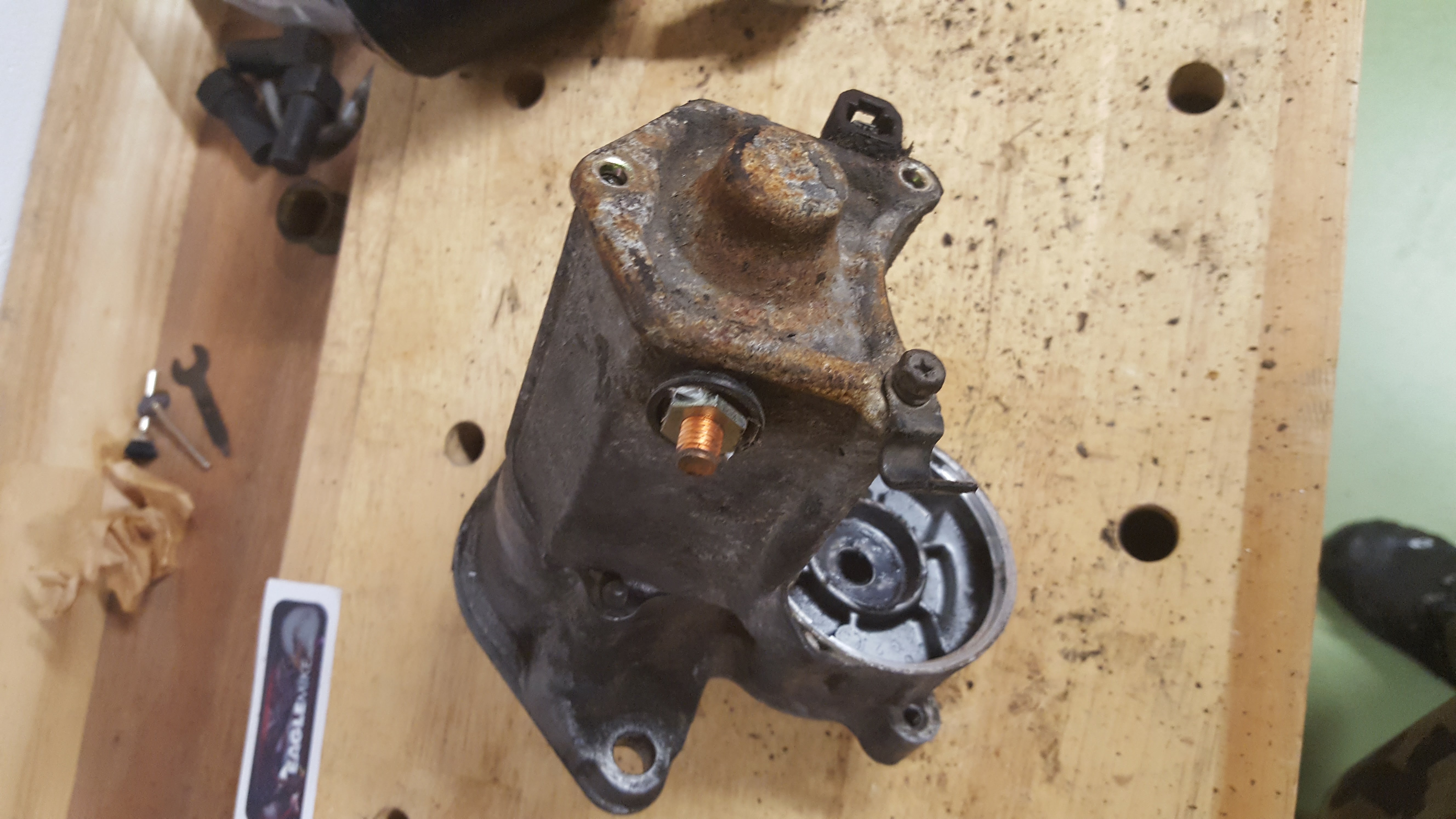

starter off and in my basement
tore it apart, havent taken the gear side apart yet, but I will probably do it just because, why not learn how that works, right?
I cleaned this all up, I will be, of course, painting it
gear looks good

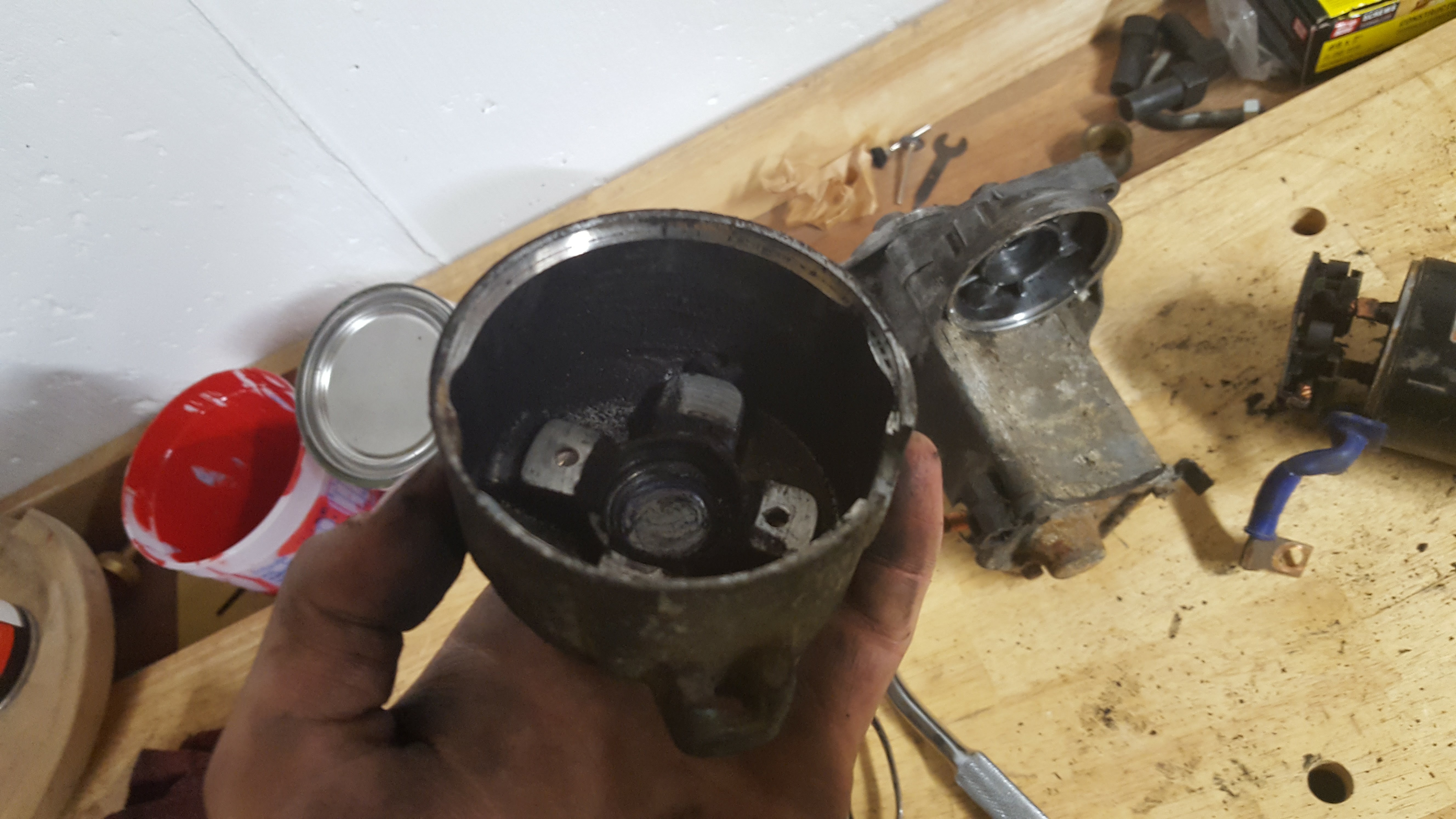

I have since taken this cap off, it looks clean on the inside, but don't really know what to look for

So I bench tested my starter, and it works fine! I installed it back into my truck, and now it just clicks. It's trying, but I think its a wiring problem. The small positive connector from the ignition is kind of dirty, I've tried cleaning with a wire brush and carb cleaner, it was pretty bent open so I bent it closed with some pliers, still just clicks. I will be heading to NAPA today to make an alligator clip jumper and I'll try it direct from the battery. I really hope its just the connector and I can just pull it off and replace or really clean it, I really don't feel like trying to chase a wiring problem.
Anyone experience a similar wiring problem? This truck started perfectly every time until I pulled the starter and transmission, so it really has to be isolated to that system, right?
