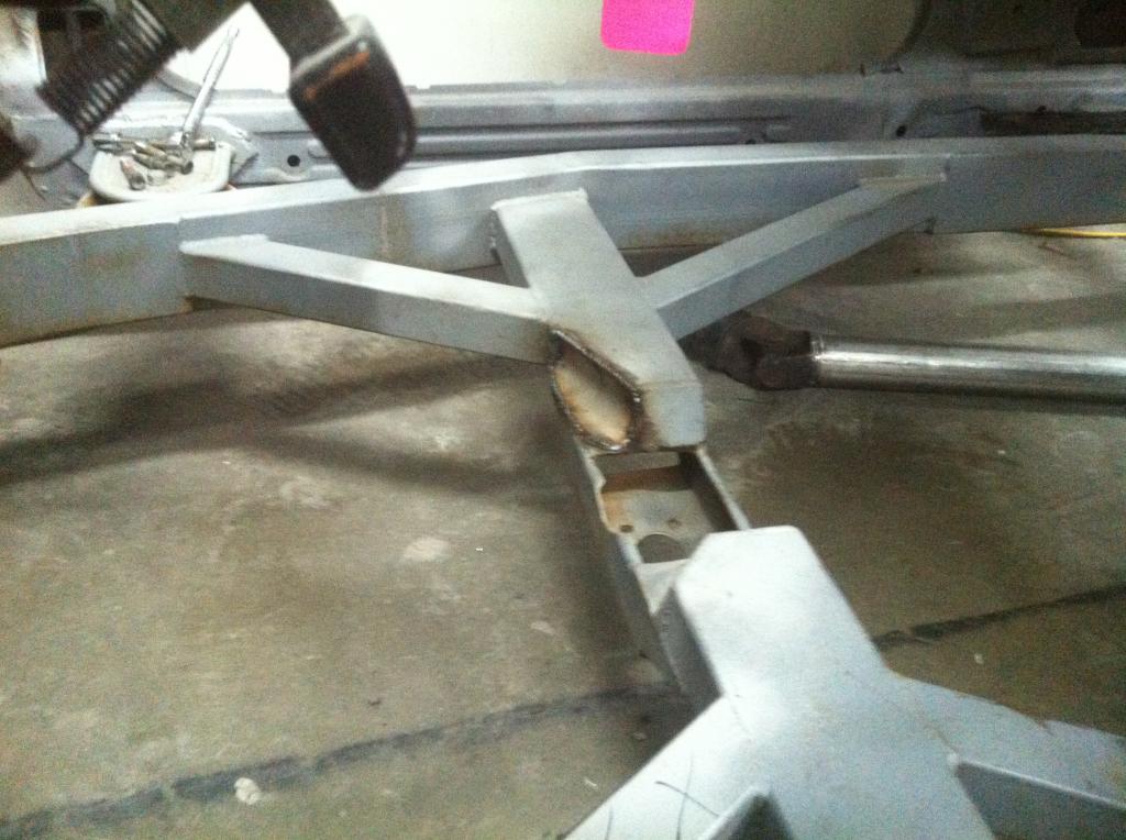

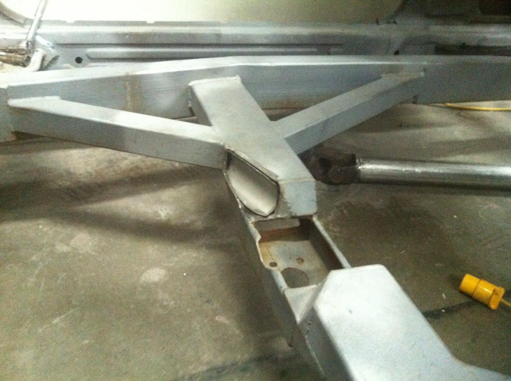

so , with the tranny out again , I needed to make a modification for the speedo cable . plasma cut out the section that was interfering , and used a piece of 2" tube to fit .. should work

I know you've got a lot of work yet to do, but the way that tranny mount section is notched out it looks like it could be a weak point. I can't tell how thick that steel is or if there is any support that I'm not seeing but I though I'd throw it out there just in case - I know you would do the same for me (have done so before).

thanks buddy , as always , I appreciate ANY and ALL input .
This mount is WAY over build , and I plan on cutting even more out , so stay tuned . The actual weigh is the only thing the mount has to support , and as it is a 2WD , I don't need any "rock" protection .... so I'm thinkin' it good
