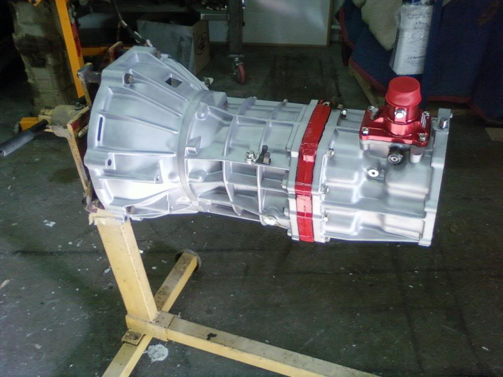

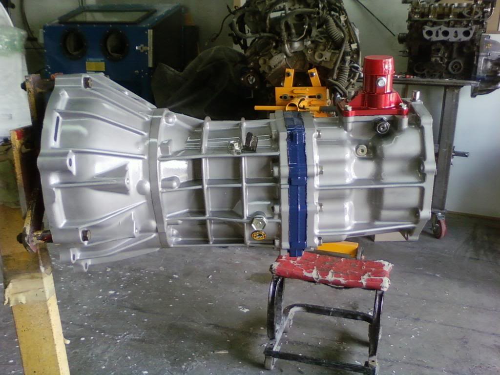

Joel is planning a long Alaska trip this year , so he want his runner in "tip top " shape .. so , we ordered a marlin tranny .

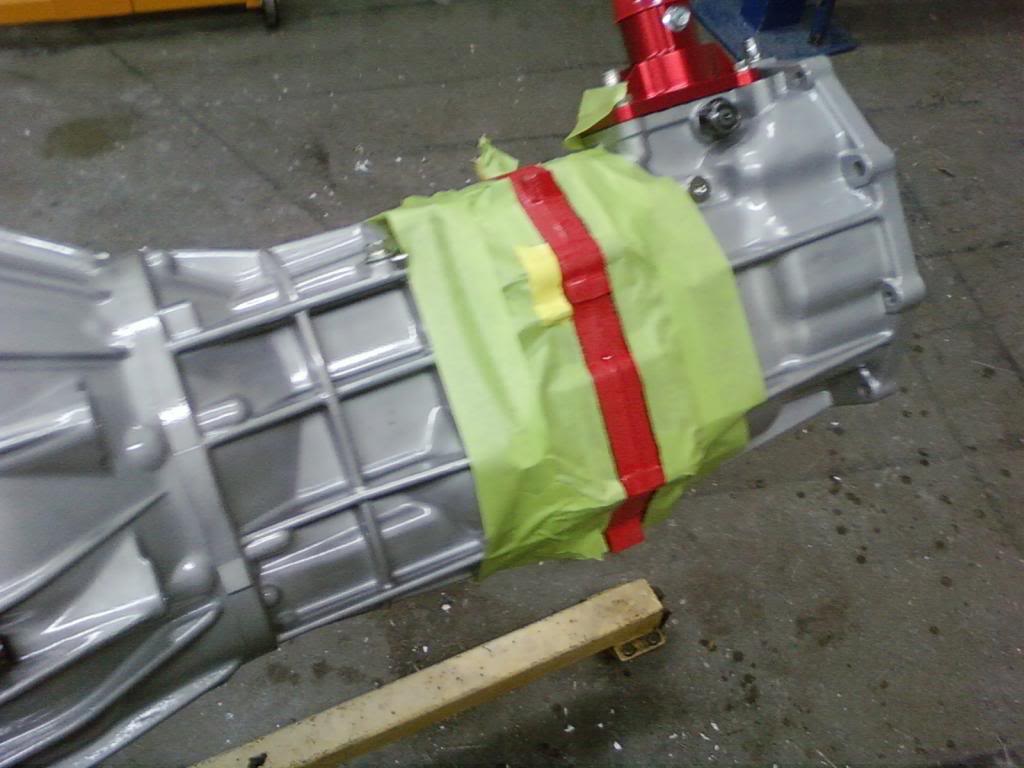

Joel wanted to keep it looking nice , he's saving up for duel transfers , and also 3 link front an rear ? (not positive just yet) as well as full custom hi clearance body . Joel decided he wanted the the cast part of the case blue , so we complied with his wishes ..

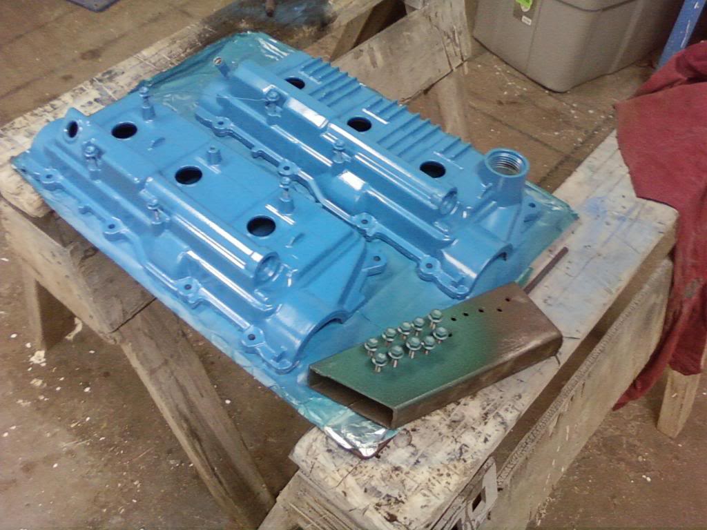

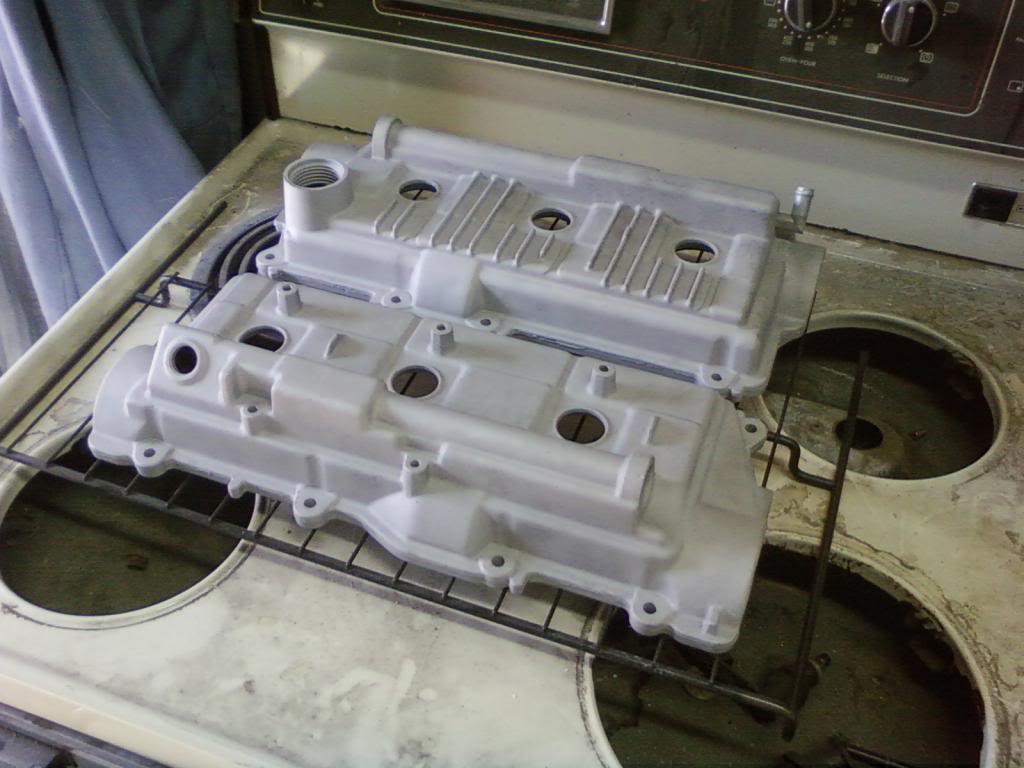

we are also up dating some of the engine colors for him .. he wanted a "wrinkle" coat powder on the valve covers ..
so all torn down , cleaned , sandblasted , back together and now ready for some powder

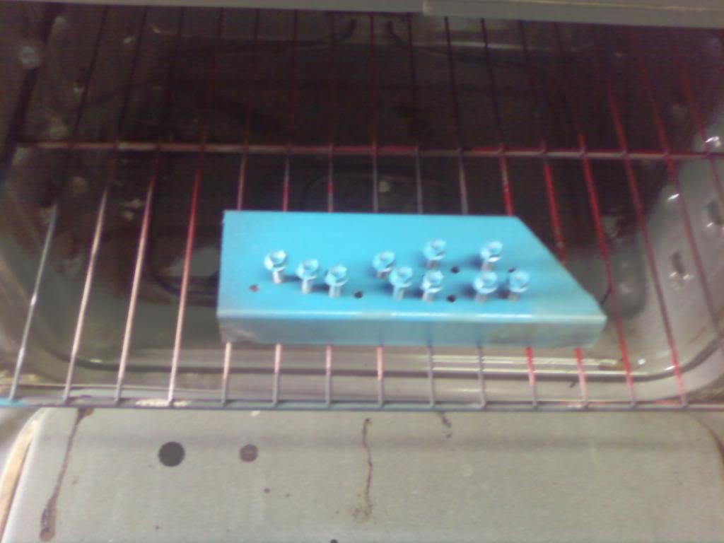

they didn't wrinkle ? don't know why ...
also something I never had happen before !! 2 different colors , same oven , same batch ..
so I ended up blasting the bolts again and re powder coating again , but still no wrinkle
they do have a black "fleck" though , and I think look really good
I guess you'll have to decide though Joel

What probably happened was the valve covers are larger AND aluminum so they take longer to heat up thus increasing flow out time. The bolts will heat up and flow out almost instantly. This heating time differential may have flowed off the powder on the bolts by the end of the bake time. Also, I've noticed that powdercoating goes on much more even and thicker over a sandblasted surface and I think the results are much better. Sometimes if I'm having trouble getting a good coat on a part, I'll heat it up first and put a hot coat of powder on it. This usually helps solve the "polarity" issues you can have in tight corners and holes.
I like your little bolt holder thing-a-ma-jig too! I need to make me one of them
Old Apr 5, 2014 | 08:48 PM
  #47
kawazx636's Avatar
iTrader: (3)
Joined: Jan 2012
Posts: 3,218
Likes: 26
From: Salisbury, MD
Ooo, another problem could have been that the bolts may have had some sort of coating on them before you sandblasted them that reacted with the powder when baked.
I think this was it ... bolts were also on the mid rack under the v/c's ..
also , I was thinking the smoke could have had a reaction to the bolts ? as much as I cleaned and even sandblasted the inside , you cant get all the oil off , so there was some smoking
ohh , and the bolts were sandblasted the first time as well , so there was no contaminants.
any way , sandblasted them again .. man that powder coat is tough had to turn up the compressor to 140PSI , and re-coat , bake , and done

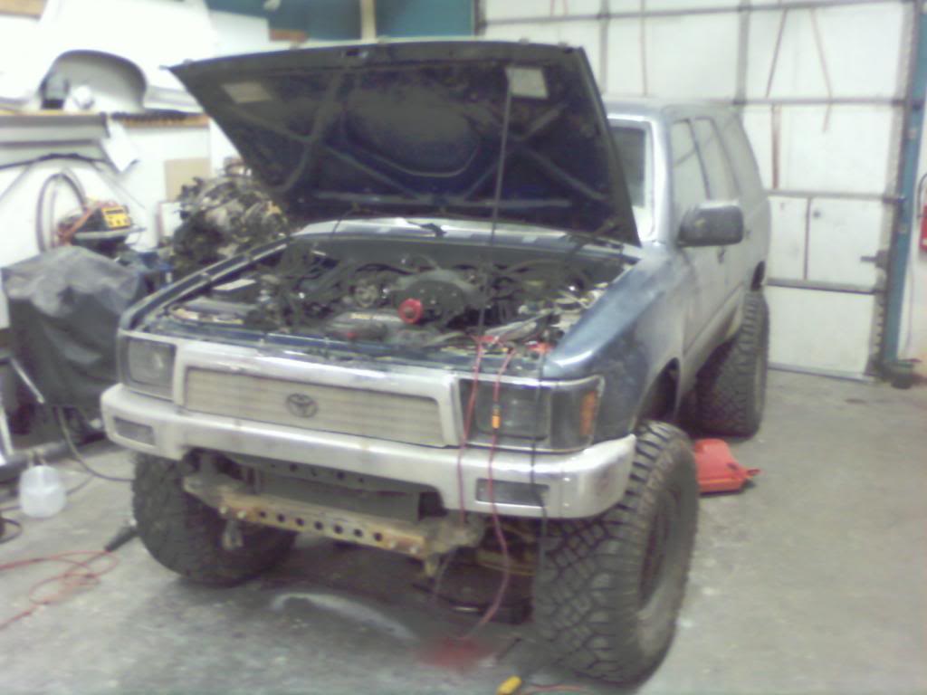

rolled Joels rig in , and got to work ..

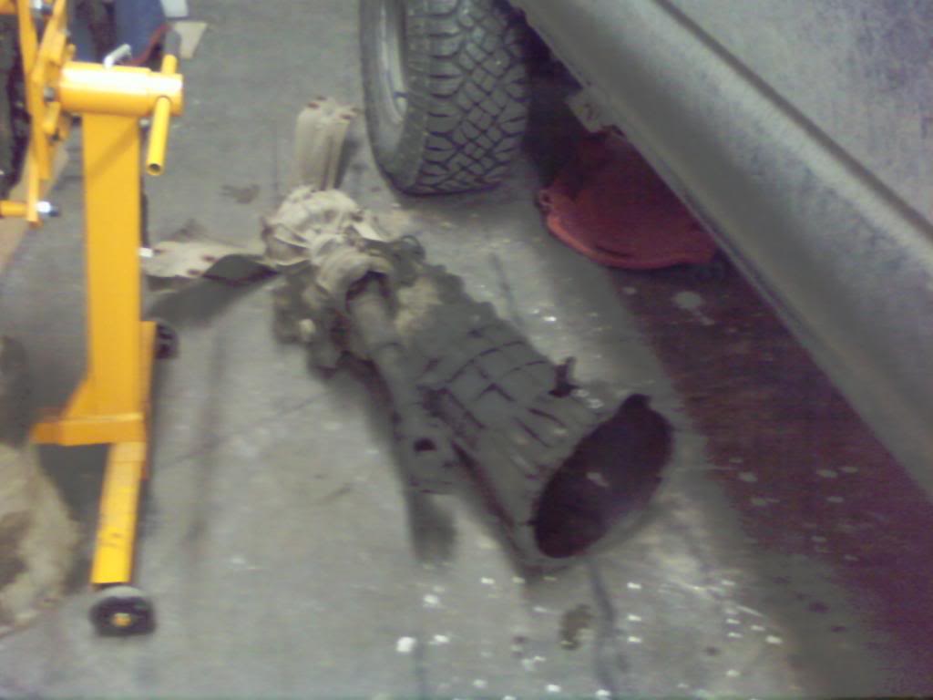

Joel has decided to get some anodizing done , and a little more powder coating ..
also , old tranny out
