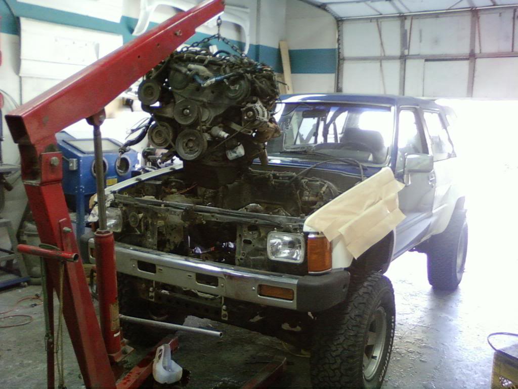

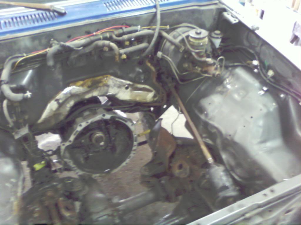

well Erik has made it to the shop ..
we got started removing the old engine
and a little cleaning

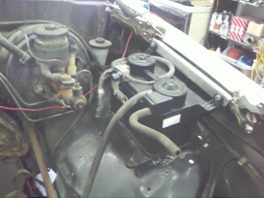

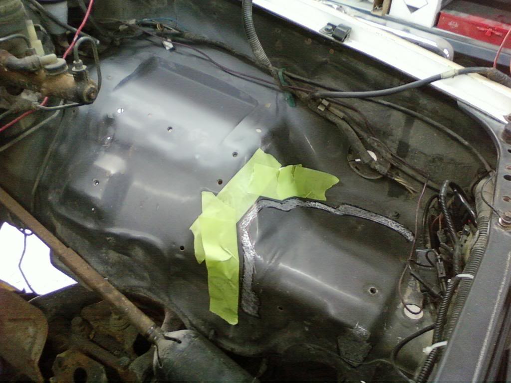

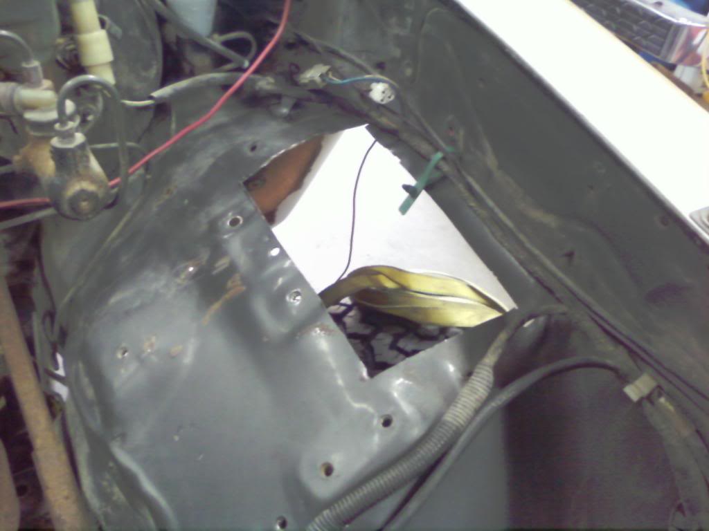

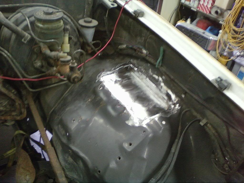

cut the drivers fender

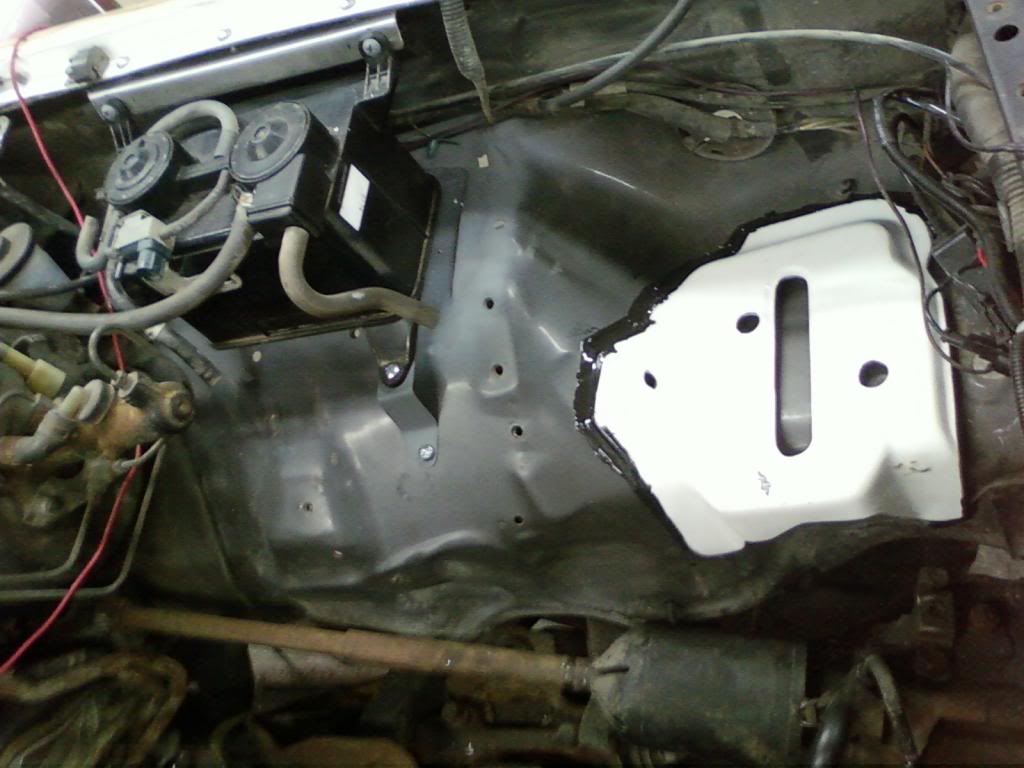

built a trey
and welded it in . And now I have enough room for the correct evap can

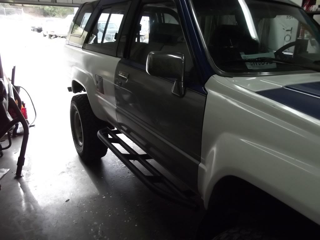

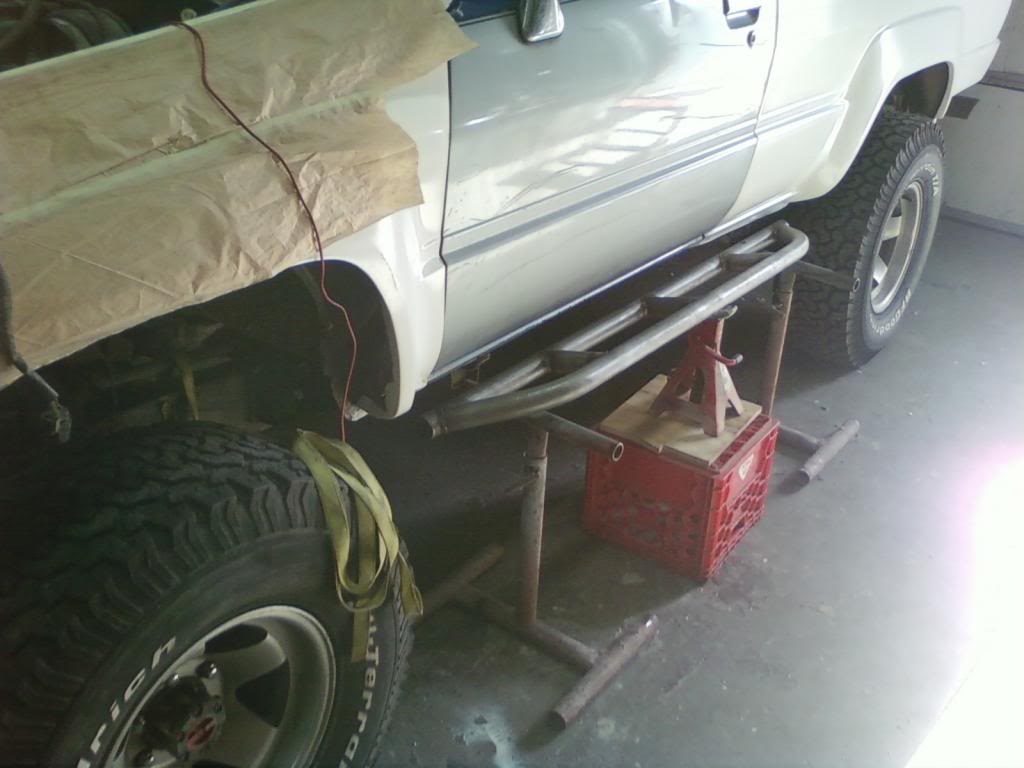

and also got the sliders ready for powder coat

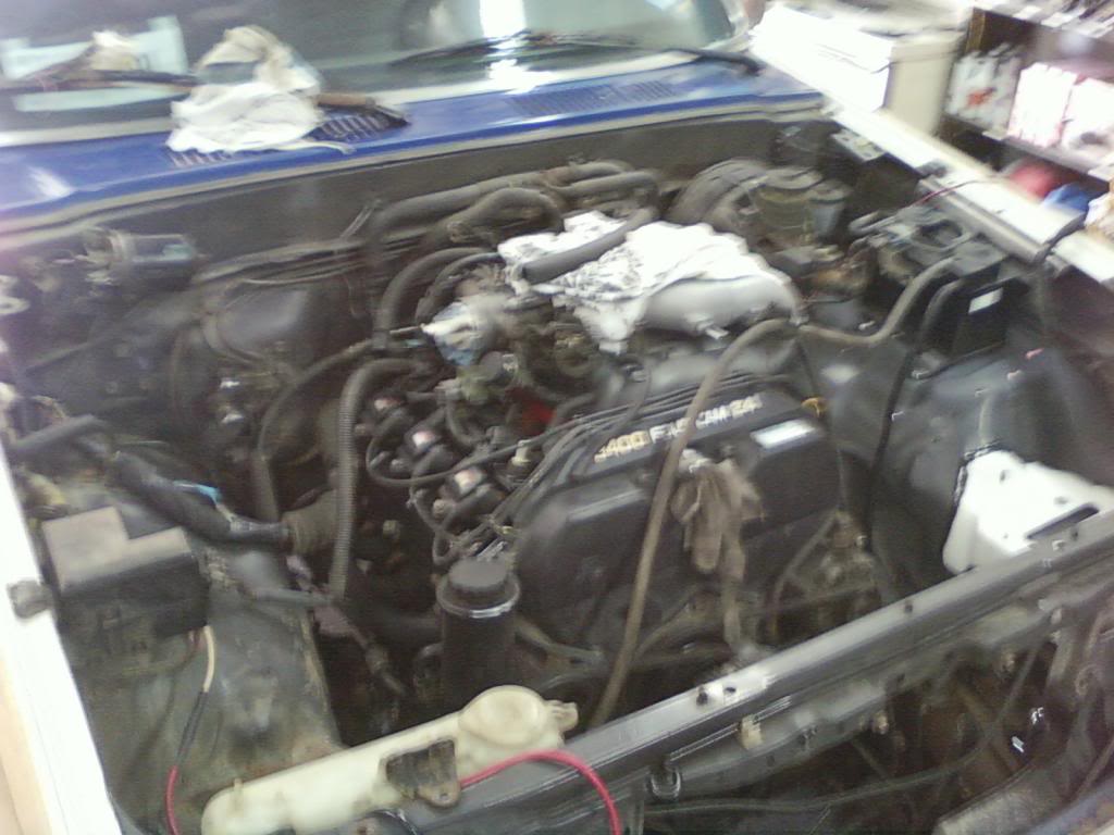

3.4L sittin' in it's new home

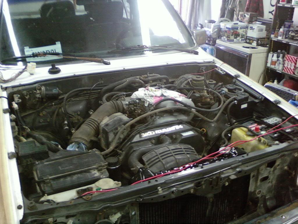

all done the engine install and time for some wiring
installed a smoothie cowl today as well

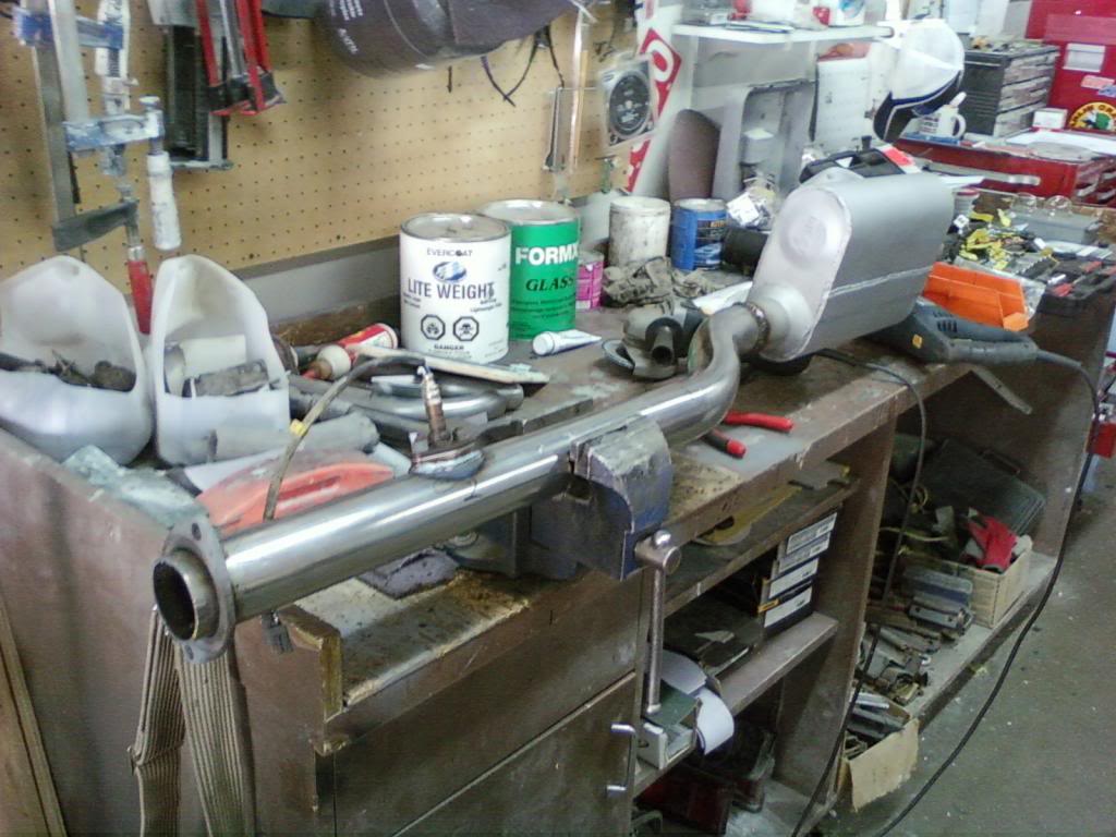

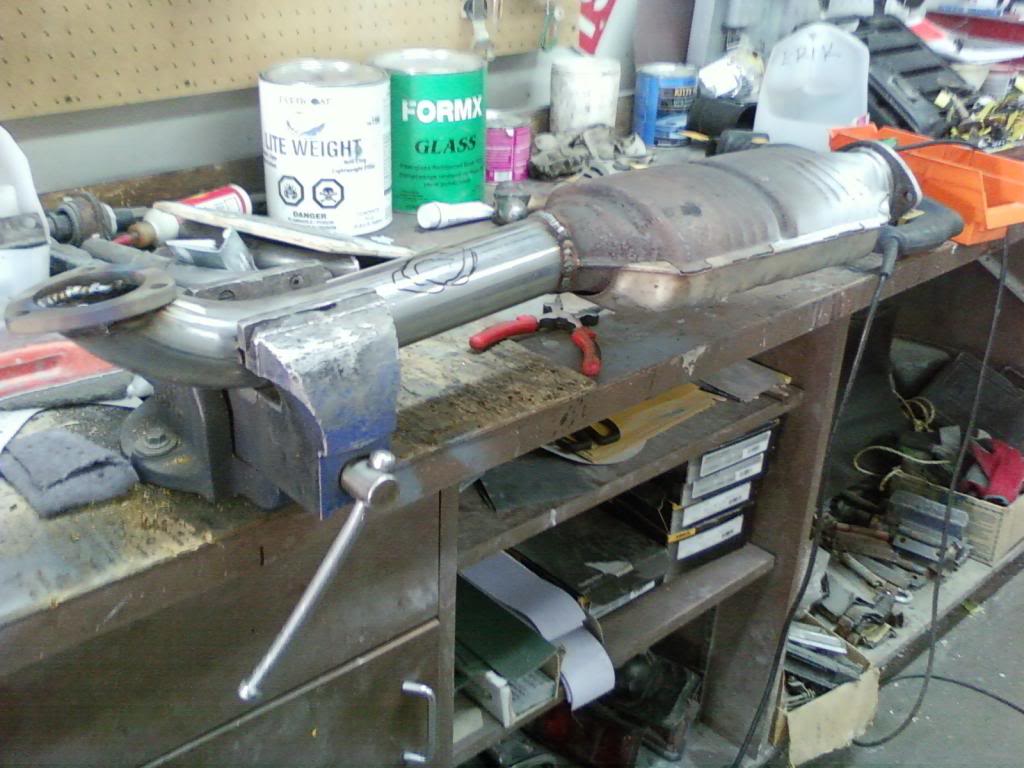

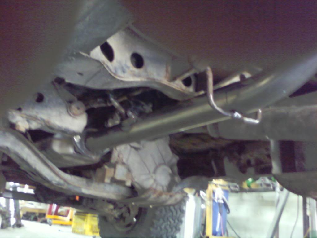

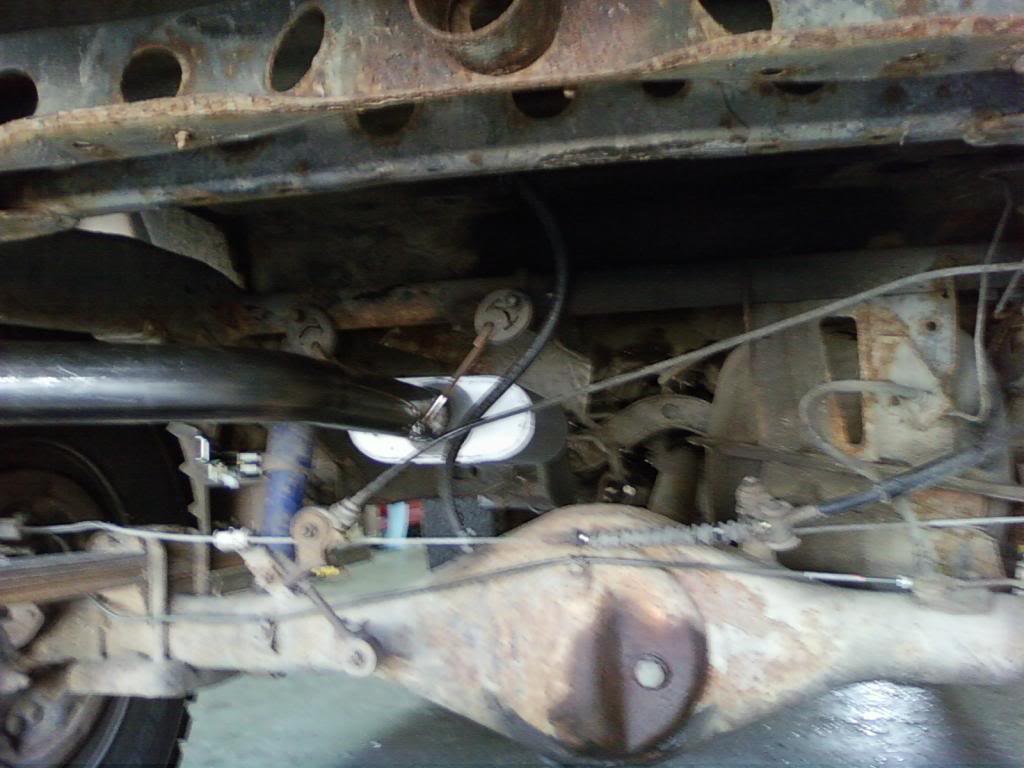

got the full "custom " exhaust built , ALL in house
2.5" mandrel bent .
header pipe being built
and muffler
and all installed
cant wait to hear it

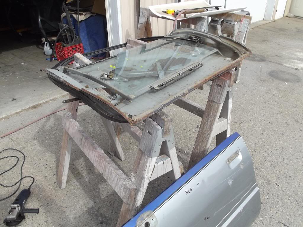

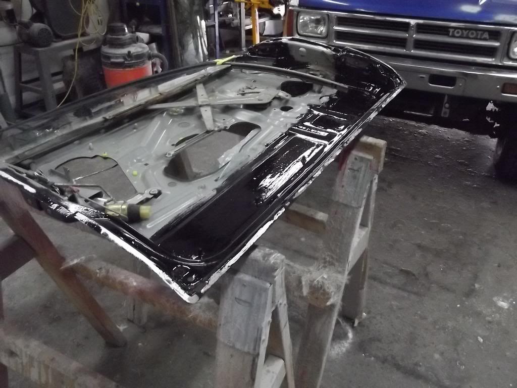

engine swapped and now running like a champ .. Erik has decided he wanted us to do the door skins as well , before paint
off with the original skin !!
looks like we got to it just in time ! (both doors were about the same condition)
cleaned up the inside and laid down some POR15 ..
POR should be ready for me to proceed tomorrow AM ... and so I got the skin all prepped and ready to EPOXY tomorrow as well

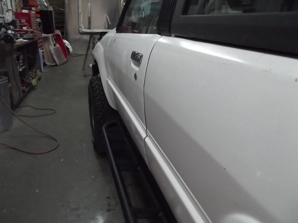

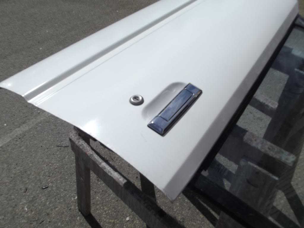

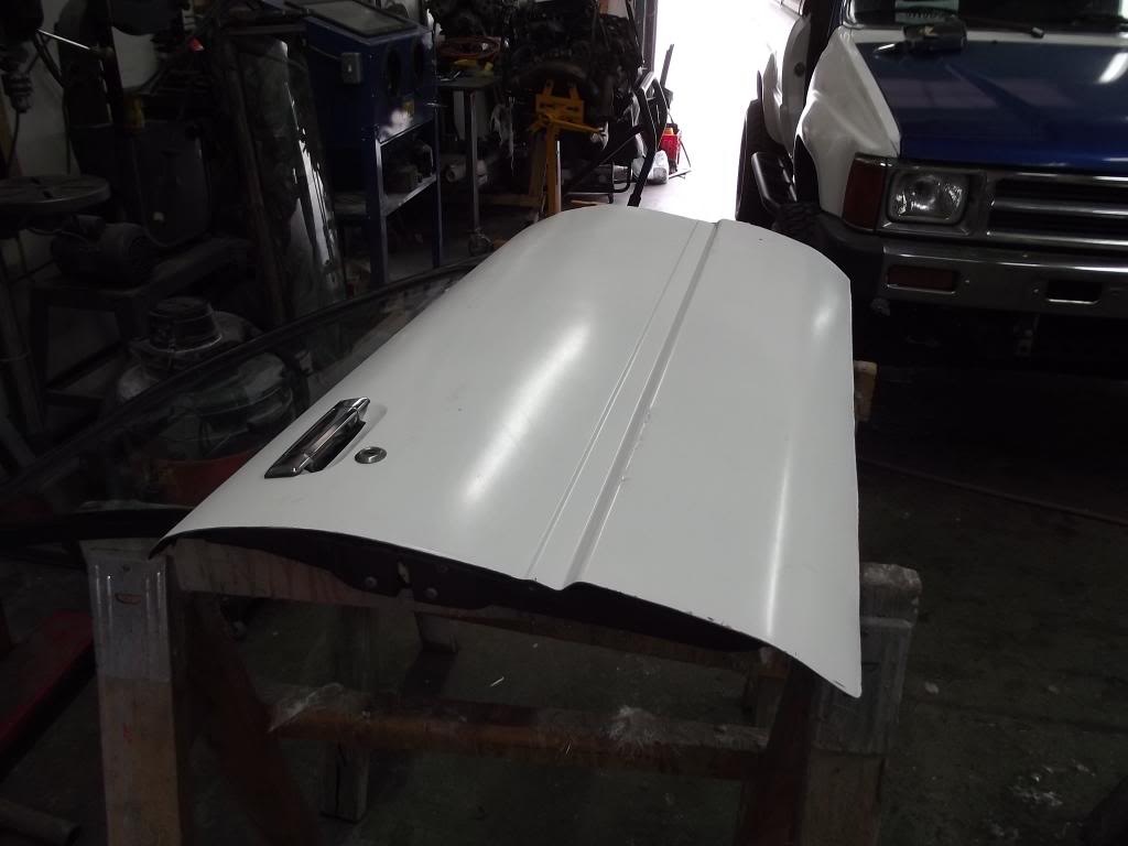

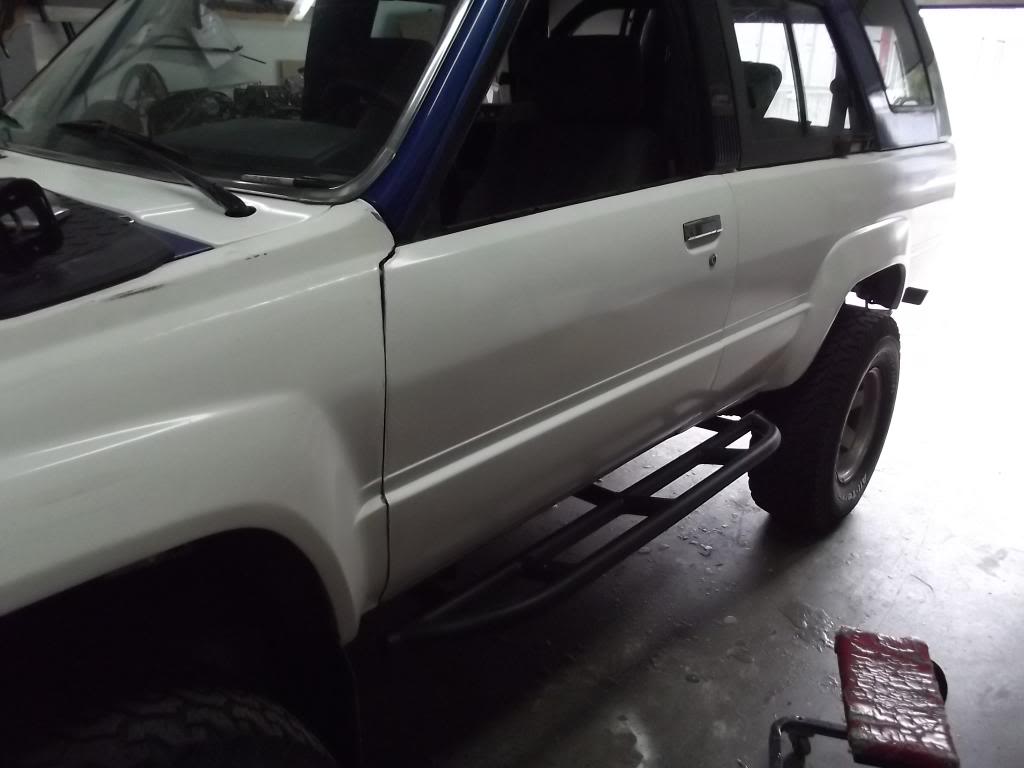

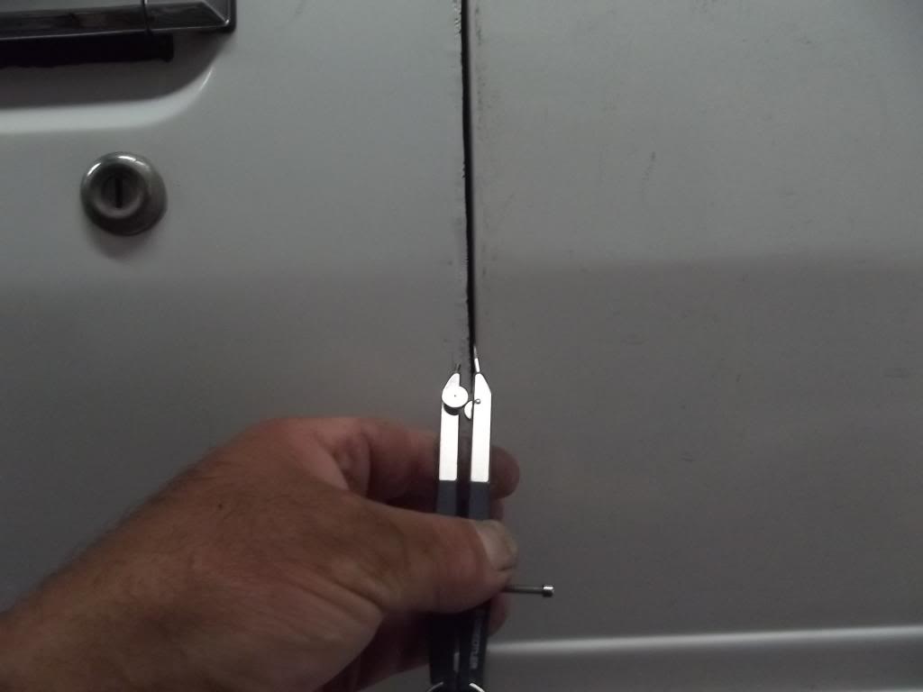

epoxy all cured , so time to mount them
test fit , and now I can "adjust" the body lines
So with a compass , I can draw the perfect gap
job all done and ready for paint
