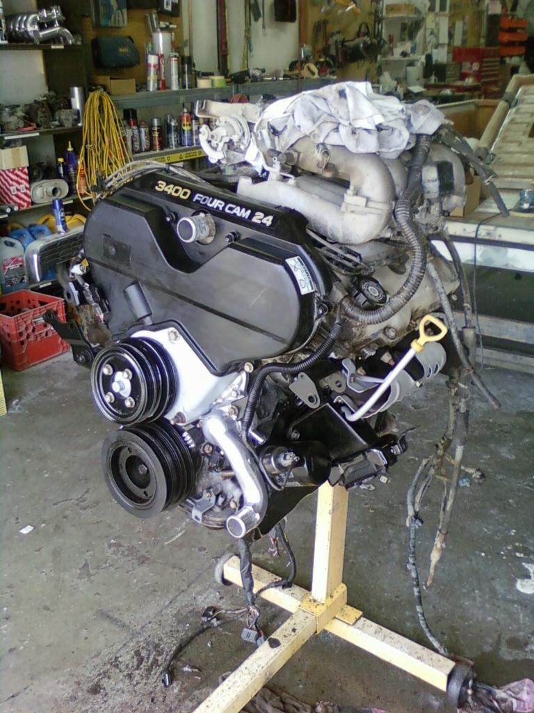

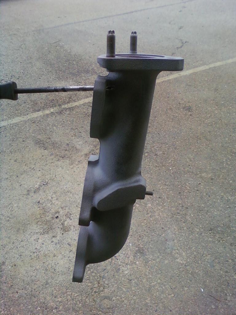

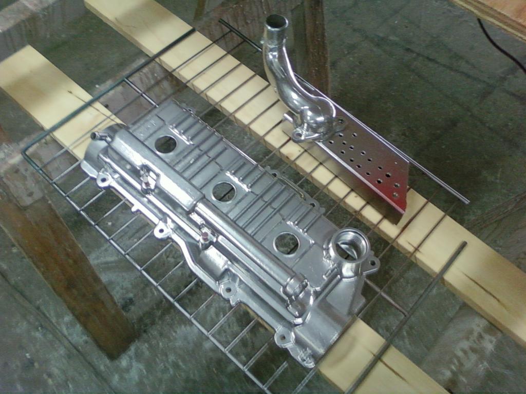

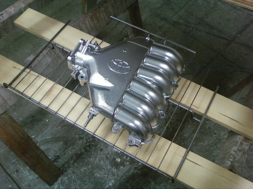

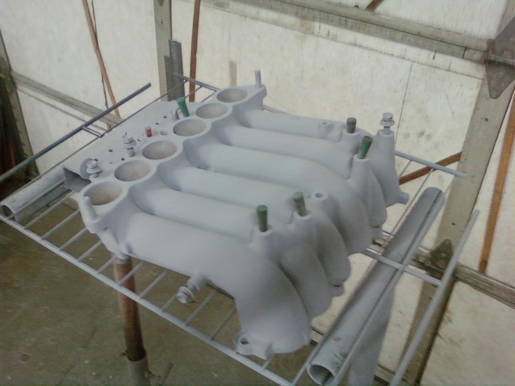

as always , started working on cleaning up the engine a bit
a little powder coating first ..
this is how it looks with the RAW powder
and a few pieces baked

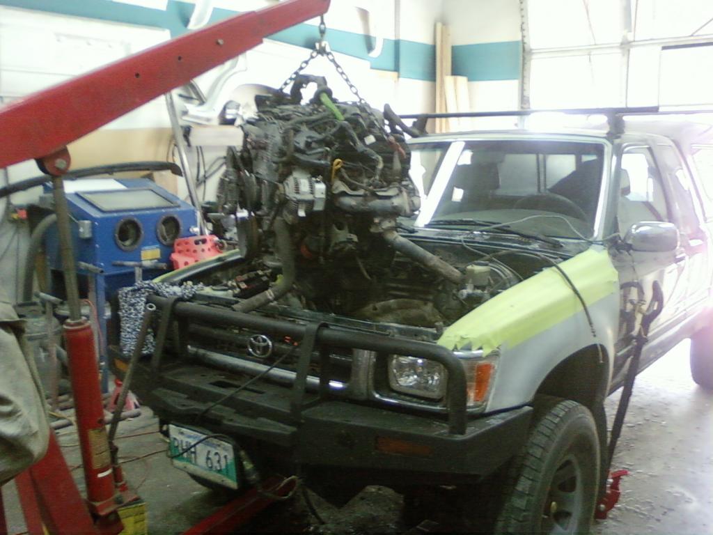

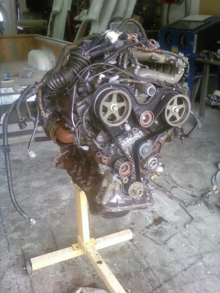

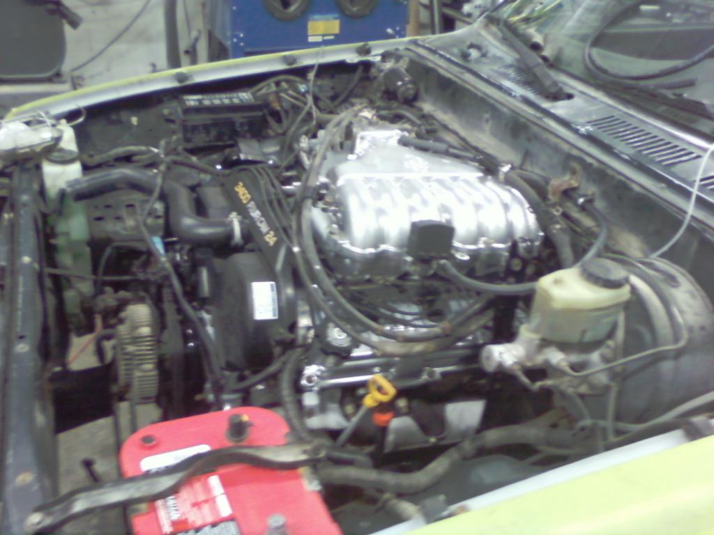

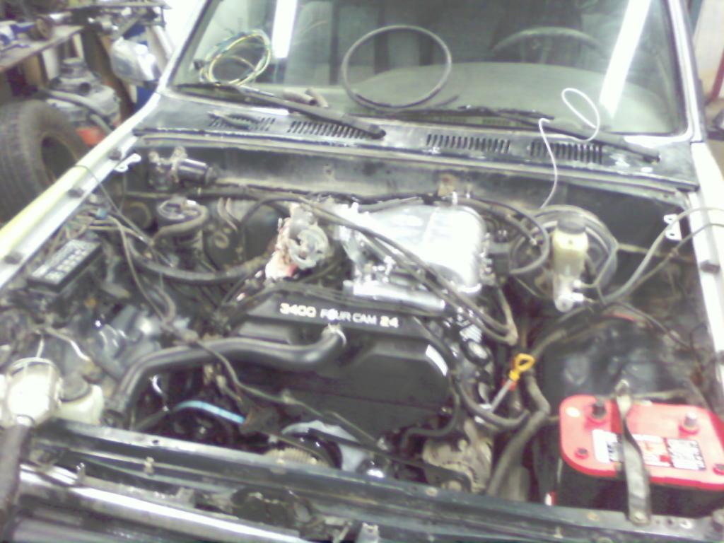

working on Rons engine ...
started to tear down the exterior and clean it up ...
off with some old stuff
lots of sandblasting and cleaning .. sure take a lot of time !!
VHT coated the manifolds and heat shields .. + lots of washing and painting
and we're getting close

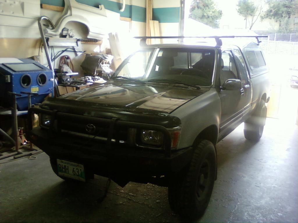

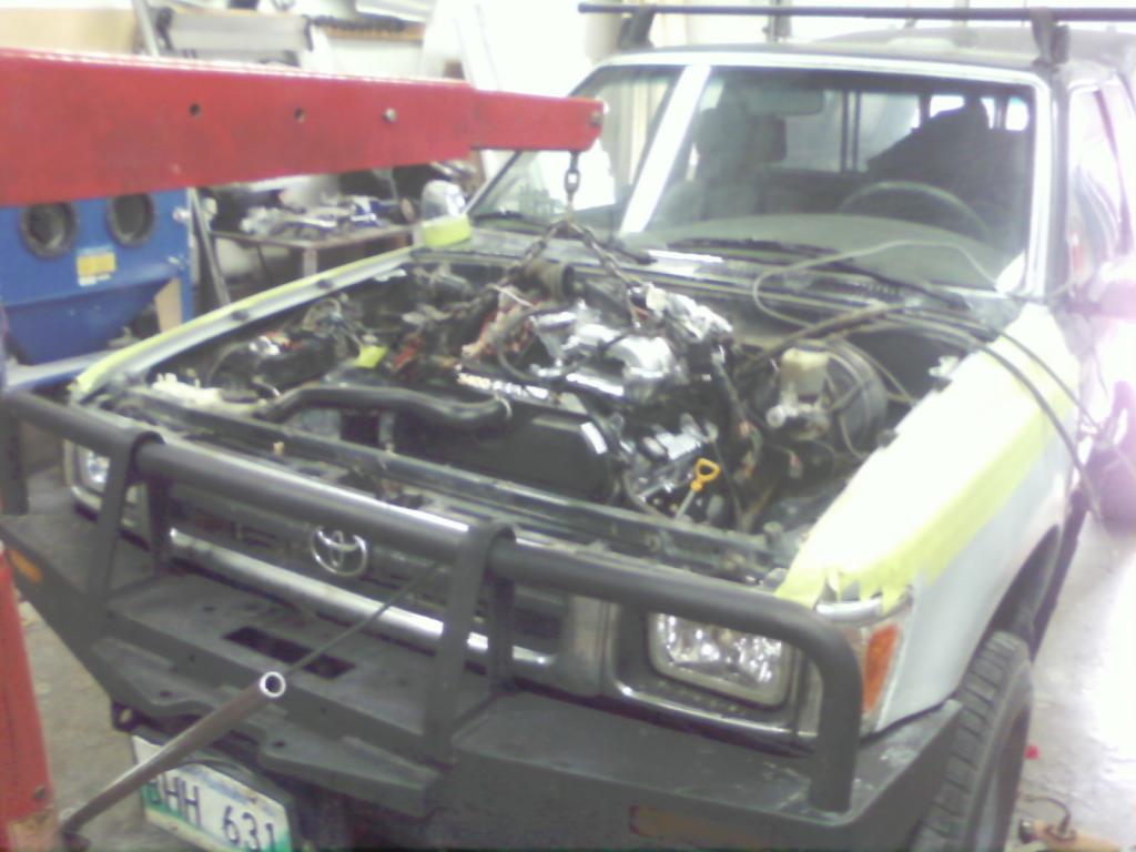

well Ron showed up a day early ...
and well .. I got right on it ..
Old Sep 18, 2014 | 05:32 PM

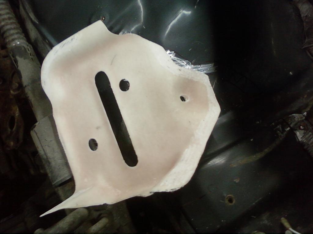

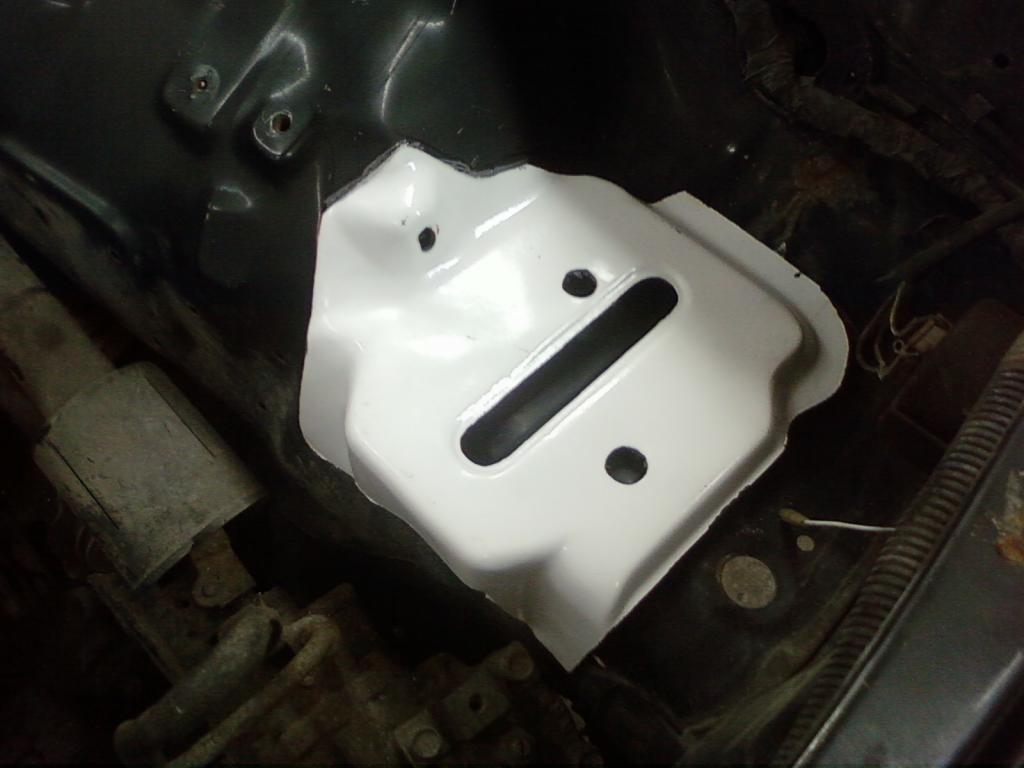

NEW battery trey today , and Yes , we used our FRP piece .
it is chemical resistant , so even battery acid wont send it into early decay like a steel piece would !!
install is easy
depending on the "epoxy" glue you decide on , and we use the 3M #08115 in our shop , first you need to bare some metal ..
rough up the FRP trey a bit
and squeeze on some panel bonder , and wait for it to cure ...
easy peasy

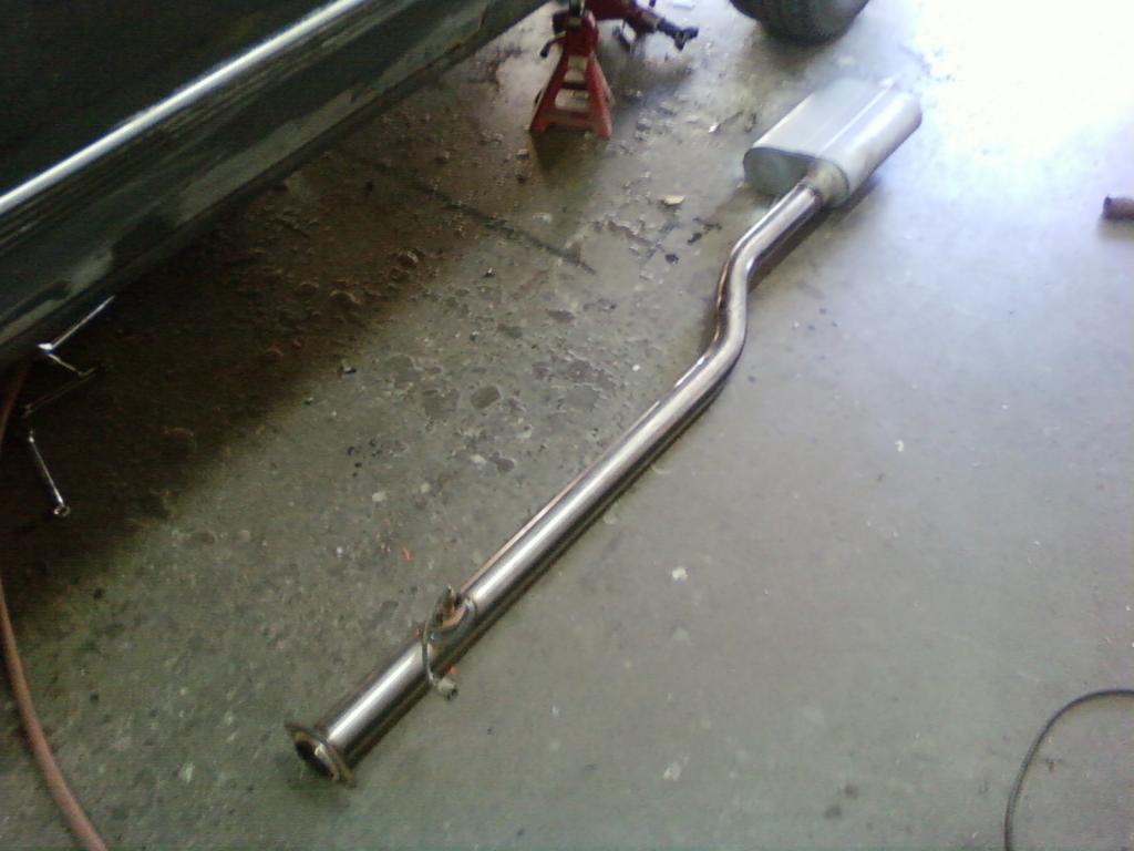

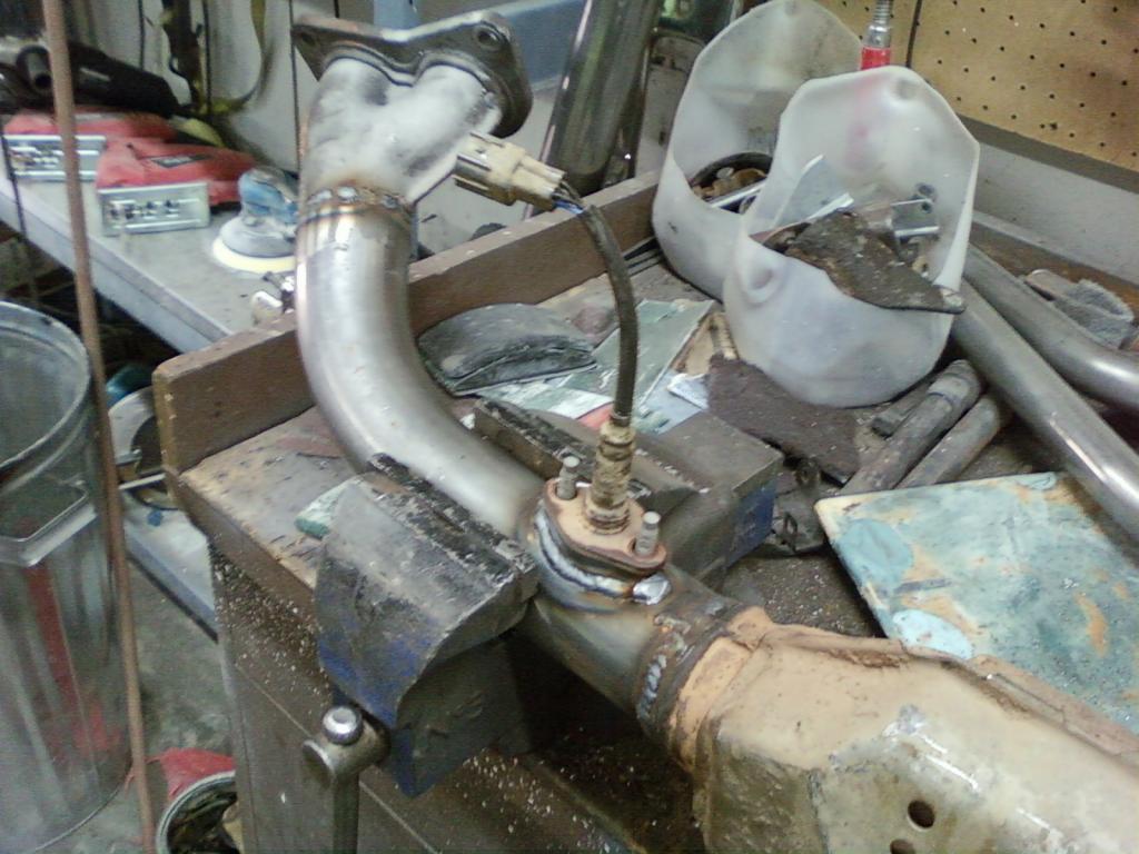

working on exhaust .. all "custom" 2.5" .120 wall ERW . heavy , but should last long time .

and mid pipe
