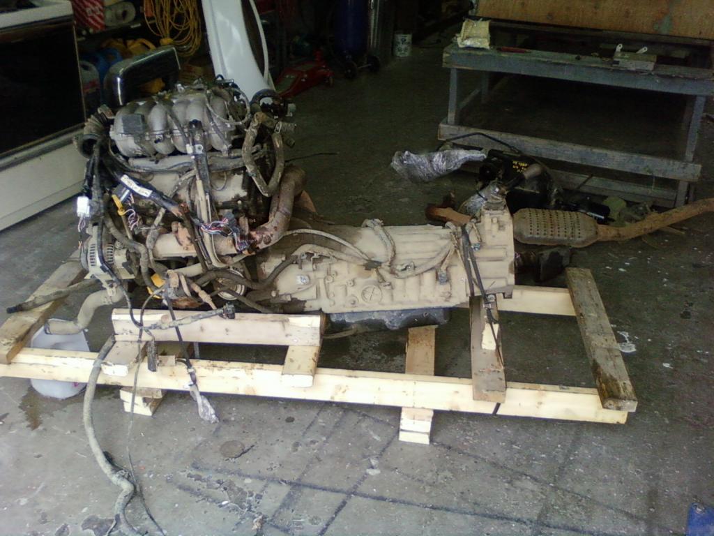

Old Aug 26, 2014 | 04:47 PM
slacker's Avatar
Joined: Jan 2006
Posts: 6,382
Likes: 302
From: BC Canada
Rons swap engine has arrived ..
this is a automatic swap .. so best choice for this swap is the T100 .
I was able to find a 96 with 200K kilometres
delivered today
