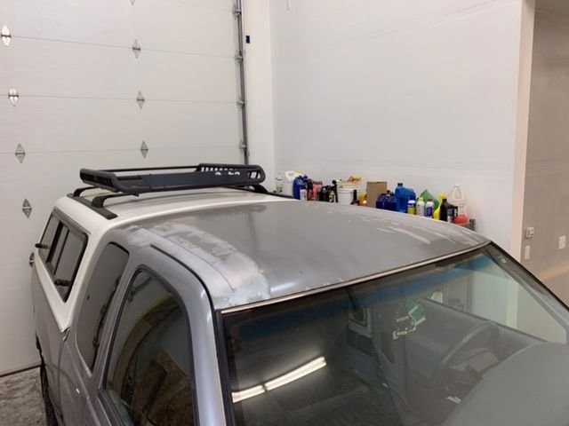

The main reasons that prompted me to start this whole thing are the peeling clear coat all over the cab and drivers door, actually down to bate, rusting metal on drivers door and carpet that wouldn’t come clean even after having it steamed by a pro.
The canvass:

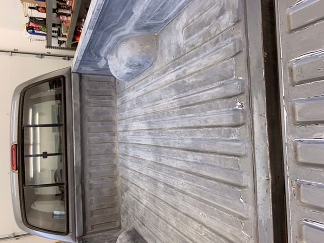

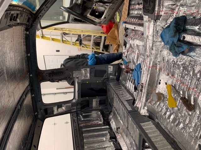

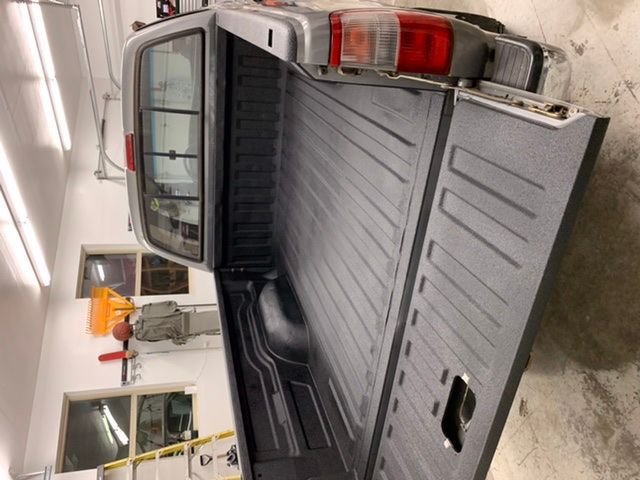

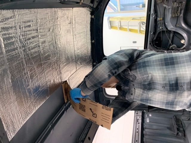

I had already removed the grille and front bumper in these photos. You can see the rust on the drivers door and all the clear coat peeling off the cab. The bed looked like garbage and I intended to put new carpet in so the boy and I started stripping it down. Decided to quiet the interior down with some Noico and need to change out the aftermarket deck so the kid has Bluetooth hands free calling. The following are my first experience with spray-in bed liner and us working on the Noico.
And now I’m frustrated because my pics are loading sideways so I might just give up on the build thread documentation........

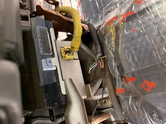

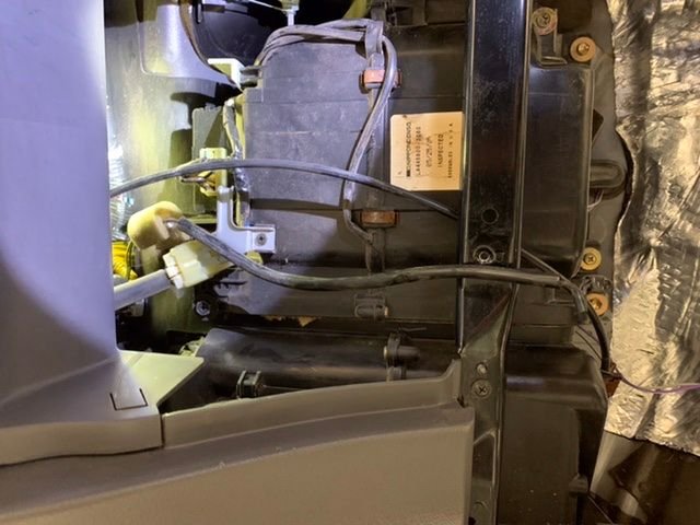

we didn’t have enough Noico to cover every surface but I read that it doesn’t need 100% coverage anyways. This weekend’s project was a self-install of a Ready Remote remote starter and keyless entry that I picked up at O’Reilly’s. Took me 2 pretty solid days to figure the whole thing out when I probably could have paid an installer $150 to do it, but at least I know where everything is, now. It works awesome and I never could understand why there were power locks on this truck but no option for keyless entry. I did run into some head scratchers though. This harness with the plug obviously cut off in this pic:
I assume this had something to do with the factory sound system but not sure. And then I found this lamp dangling behind the glove box when I removed the box. It’s the black wire hanging straight down on the left with a tiny bulb plugged into the socket. It’s an insert and twist type base and I can’t for the life of me find the socket that it fits into. Nothing on glove box area. Thinking maybe ash tray but haven’t checked that yet.

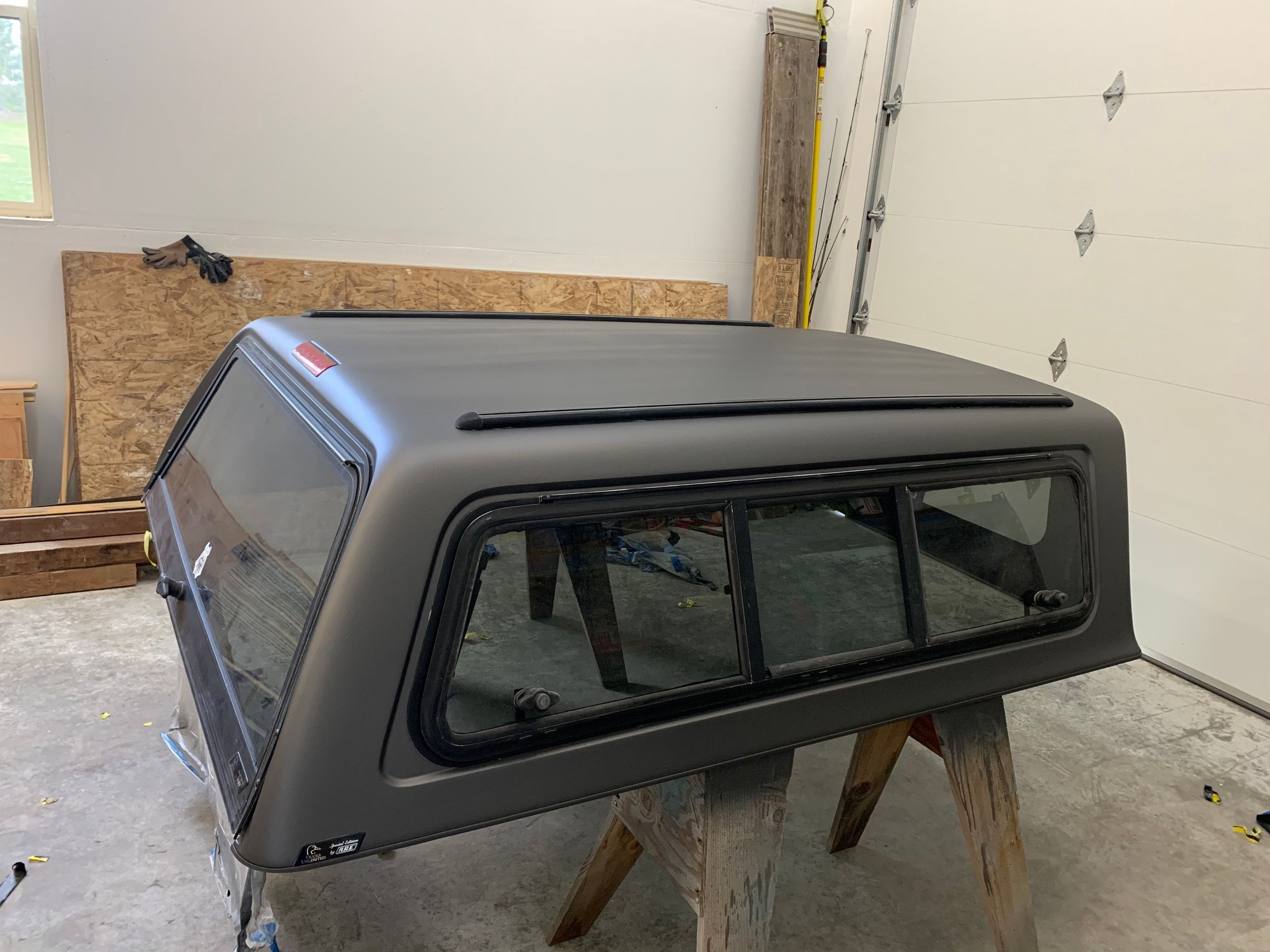

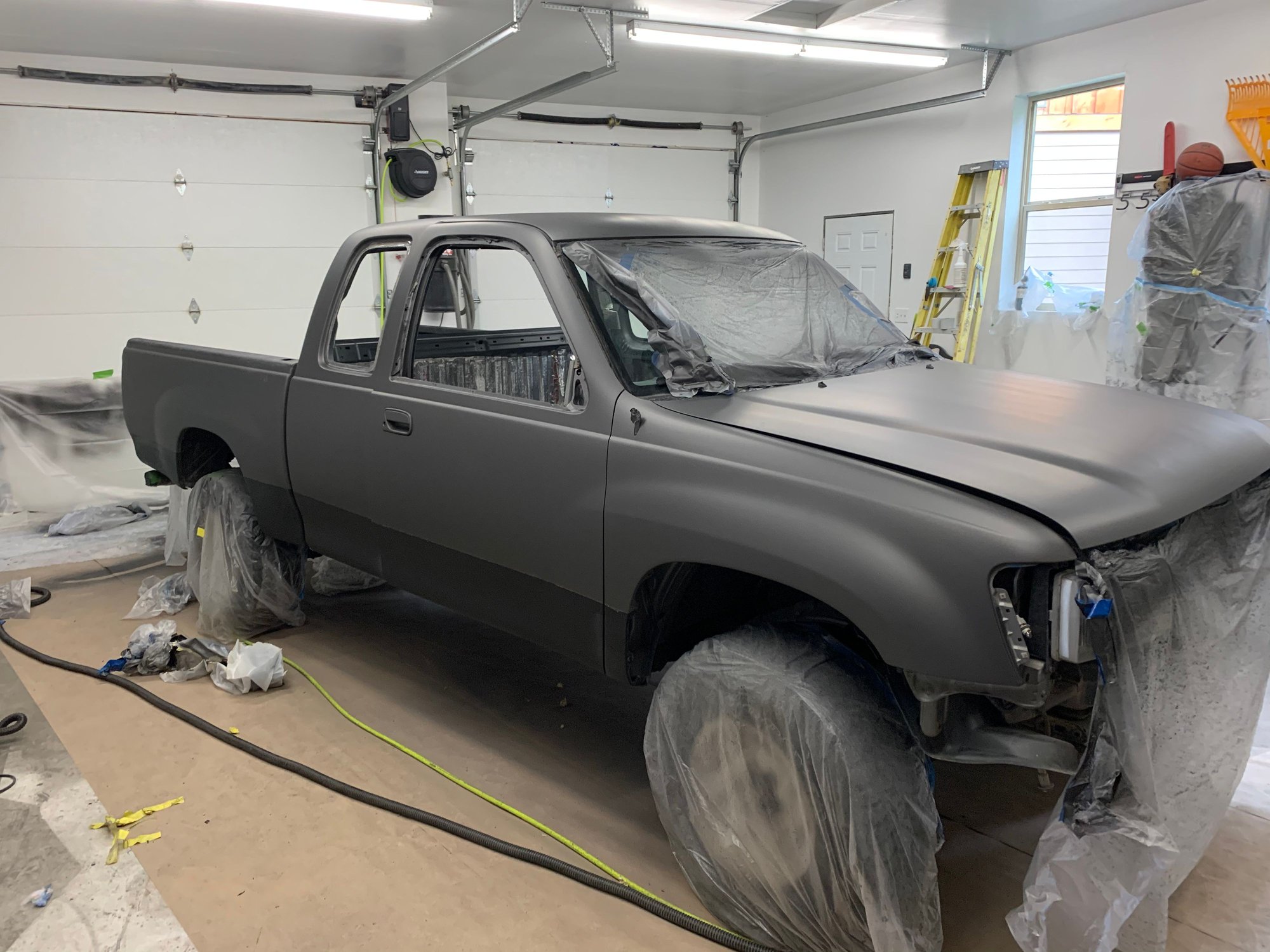

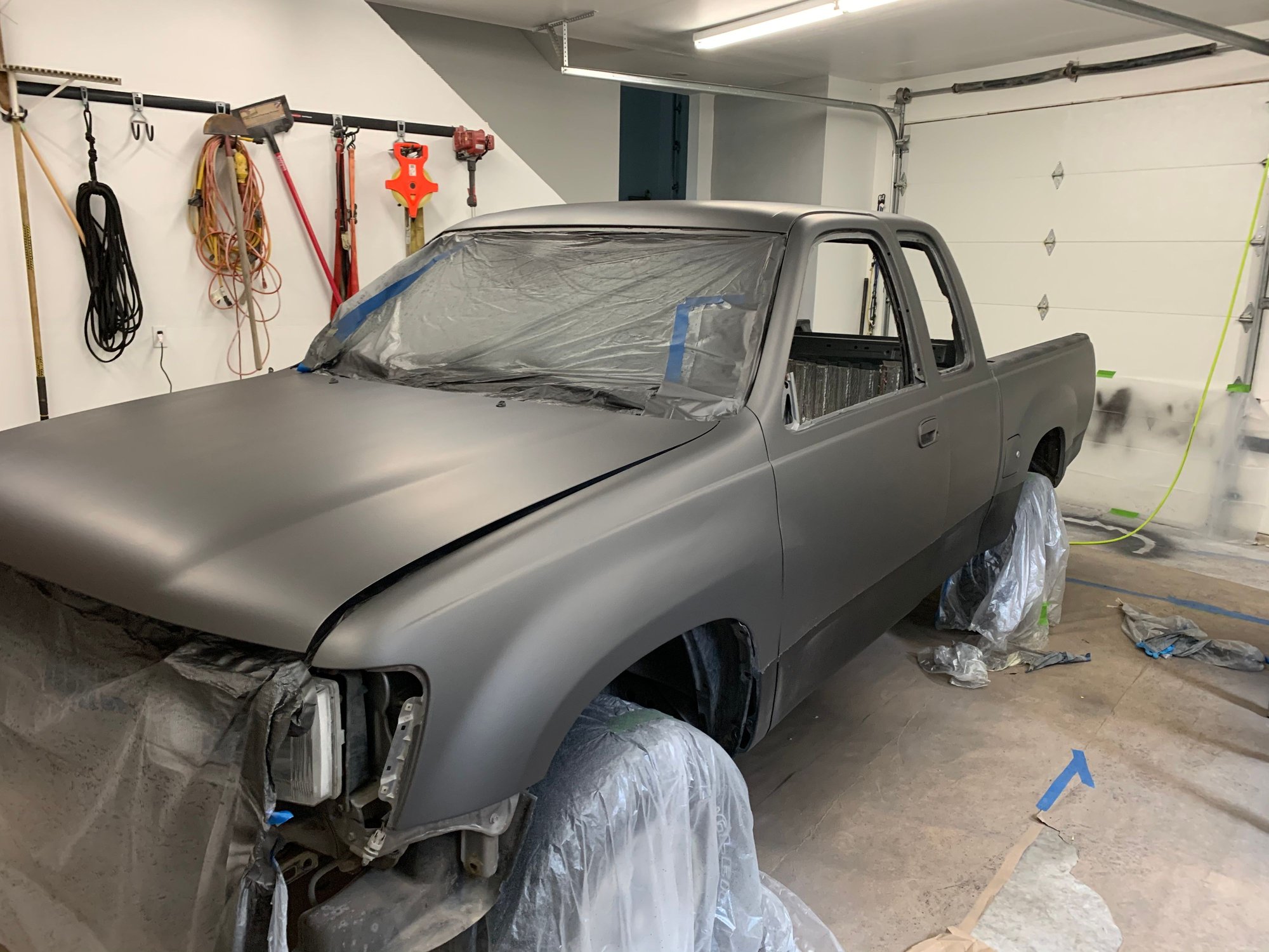

I guess it’s time for an update. I’ve done quite a bit of work on the truck since the last post. Not sure if anyone is finding this valuable at al, but I’m going to keep plugging away. I Plasti-Dipped the truck several weeks ago. I was a little concerned that the body work wasn’t up to par and I even had pinholes develop in the bondo after it had dried out. But the kid was pushing me to move on and I was sick of doing body work so I gave in. Boy did the paint expose a lot that I couldn’t feel, and although dip is really thick it didn’t fill the pinholes like I had hoped it would. I learned after the fact that I should have used what’s called a glazing putty to finish off the body work and fill the pinholes. The other mistake I made was my bright idea to Raptor line the rockers. Came out really nice I think, but the seam between the liner and paint didn’t work out so well. I’m debating putting the side molding back on to cover that seam. Got some Bushwacker flares attached and Raptor lined those too. Here’s some pics of the progress:
This last pic was after everything was pretty much back together. As you can see, I Raptor lined the chrome bumpers, too. I really like the stuff and it’s super easy to use. Have my flares on in the last pic, too. You’ll notice the hood is off. Well, that’s because I learned that horizontal surfaces are the hardest to paint with Plasti-Dip. I watched the instructional videos, but I just couldn’t seem to get through a coat without leaving tiger stripes. I finally gave up, removed the hood, hung it from straps and painted it vertical. That worked really well, although the hood now has about 20 coats on it from me trying to fix all my mistakes.
Side note, the Plasti-Dip color is Anthracite grey. I really like the color. Here’s an example of my frustration with the seam between Raptor and dip:
