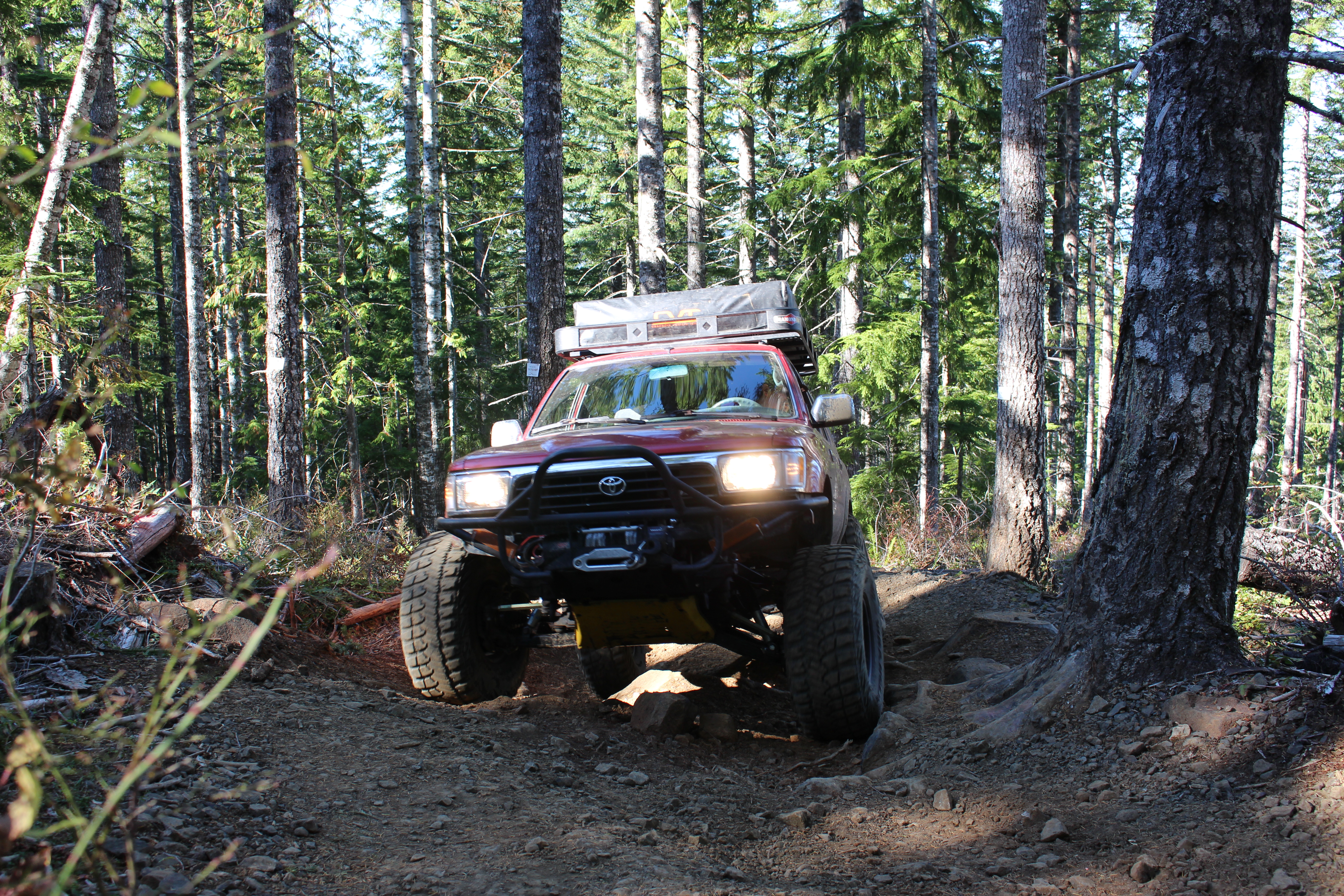

I'll put a picture up for you.

Red Wagon - nice truck. How do you like the Long Travel IFS set up? I'm a little distracted from my truck right now...in the process of taking delivery of a Audi TT 3.2 Quattro with a manual transmission.
Old 01-08-2014, 05:00 PM
Red Wagon's Avatar
Join Date: Aug 2011
Location: Fraser Valley, British Columbia
Posts: 1,507
Received 2 Likes on 2 Posts
I really like it. I think it would perform at it's best with a slightly smaller tire though.
