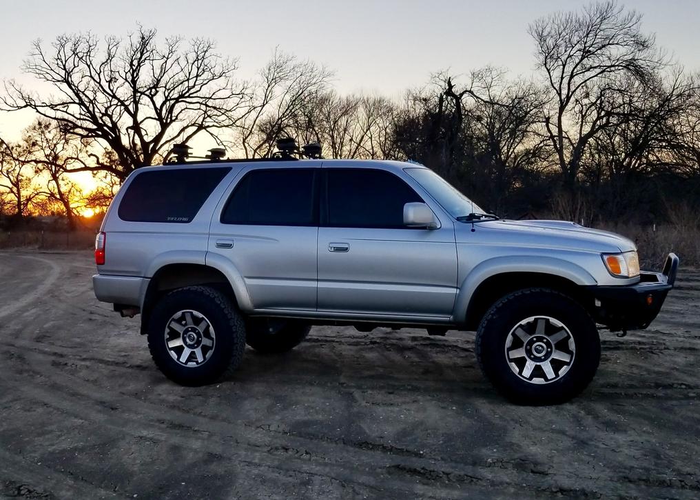

2001 Sport Edition 4x4.
Sorry for the lack of information right now but will try my best to get his thing up to date.
I originally purchased the T4R as a second vehicle in 2013 to keep miles off my truck I owned at the time due to an hour long drive into work. After several months I realized this was the only thing I drove, sold my truck, and paid this off. I joined the forum to get information on how to perform my own maintenance but have since modified & benefited from so many great write ups and builds and feel the need to give a little back.
As of Feb. 2018 @ 218k miles

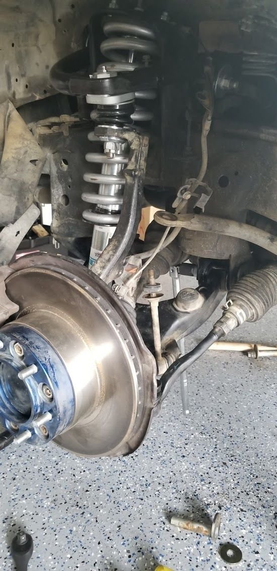

New front suspension
I for sure underestimated the effort needed for this project, but if you don't get easily distracted and drink consistently with the neighbor instead of work, I would say this would be easily a two day job. I had installed my own lift and rebooted CVs previously so only used a couple of write ups in which I referenced below.
Key Points to take away:
1) LCA bushings were all pretty rough & spending another $70 in quality Whiteline bushings is worth it.
2) Don't use Energy LCA bushing because they require you to use the old sleeves. As you can see, mine were completed rusted
3) Besides the required sized sockets that are pretty large, I purchased a pitman puller from Harbor Freight & rented a 3 arm, 5 ton puller from Autozone and needed no other specialty tool to remove or install anything.
4) The Cam or Eccentric bolts and sleeves, whichever you prefer to call them, are hard to find and cheap to replace. Go ahead and buy replacements for all 4 from Toyota as they are cheapest there (Toyota Parts of Dallas) and you get OEM. My vehicle has only been in California and Texas and one was seized that Alignment shop has worked around and never bother to tell me and two of the bolts had damaged threads removing them to replace the LCA bushings. I have added the parts numbers below.
Parts List:
Upper Control arms - SPC 25460
Shocks - Toytec 112620
Springs - Bilstein D558
Upper Strut Mount - KYB SM5184
Strut Stem Kit - Wheelers
LBJs - Toyota 43340-39465 & 43330-39585
LCA bushings - Nolathane Rev034.0060
Steering rack bushings - Energy 8.10103G
Eccentric kit - 48452-35020 x4 / 48409-35050 x4 / 90080-11283 x4
