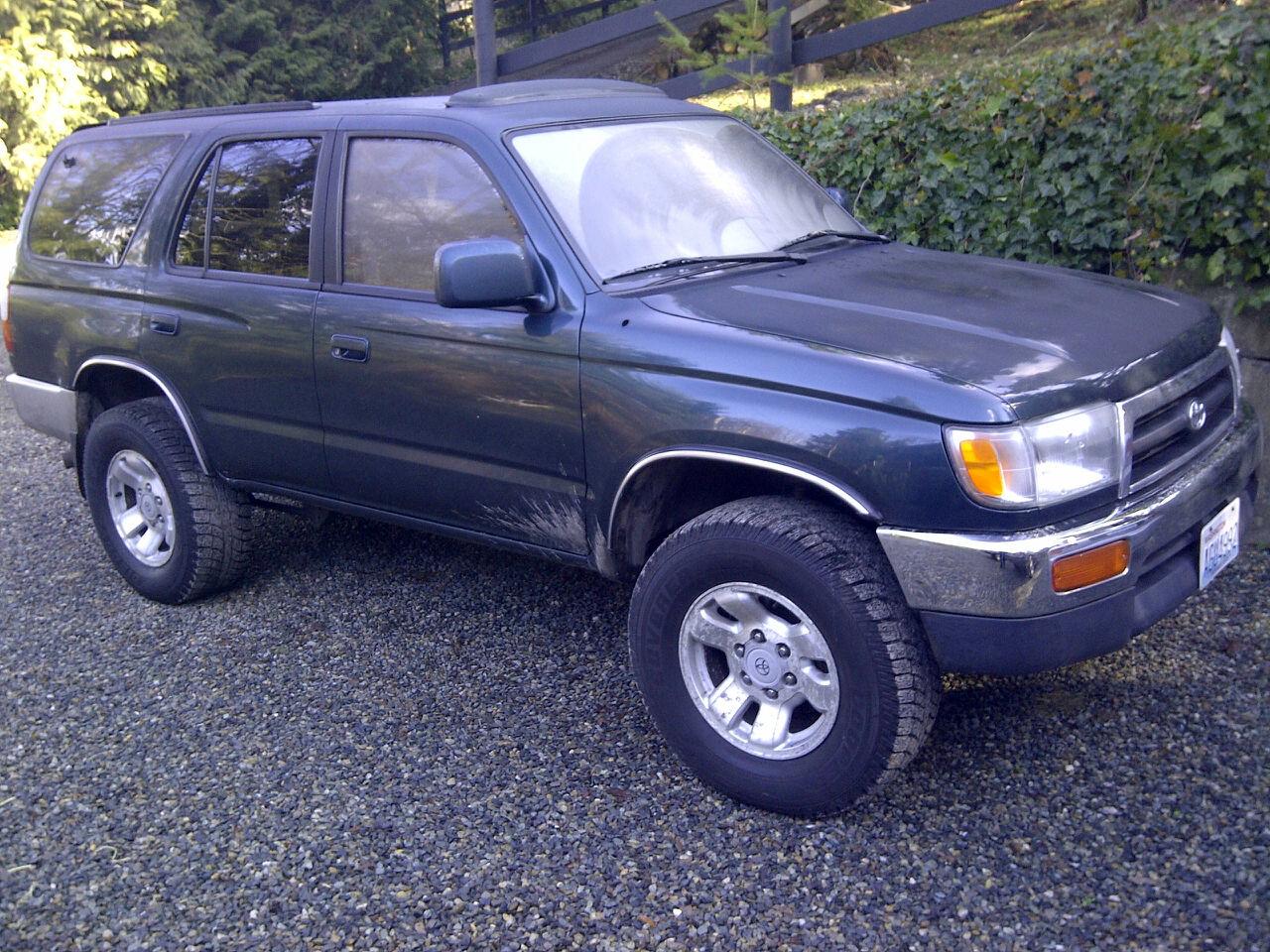

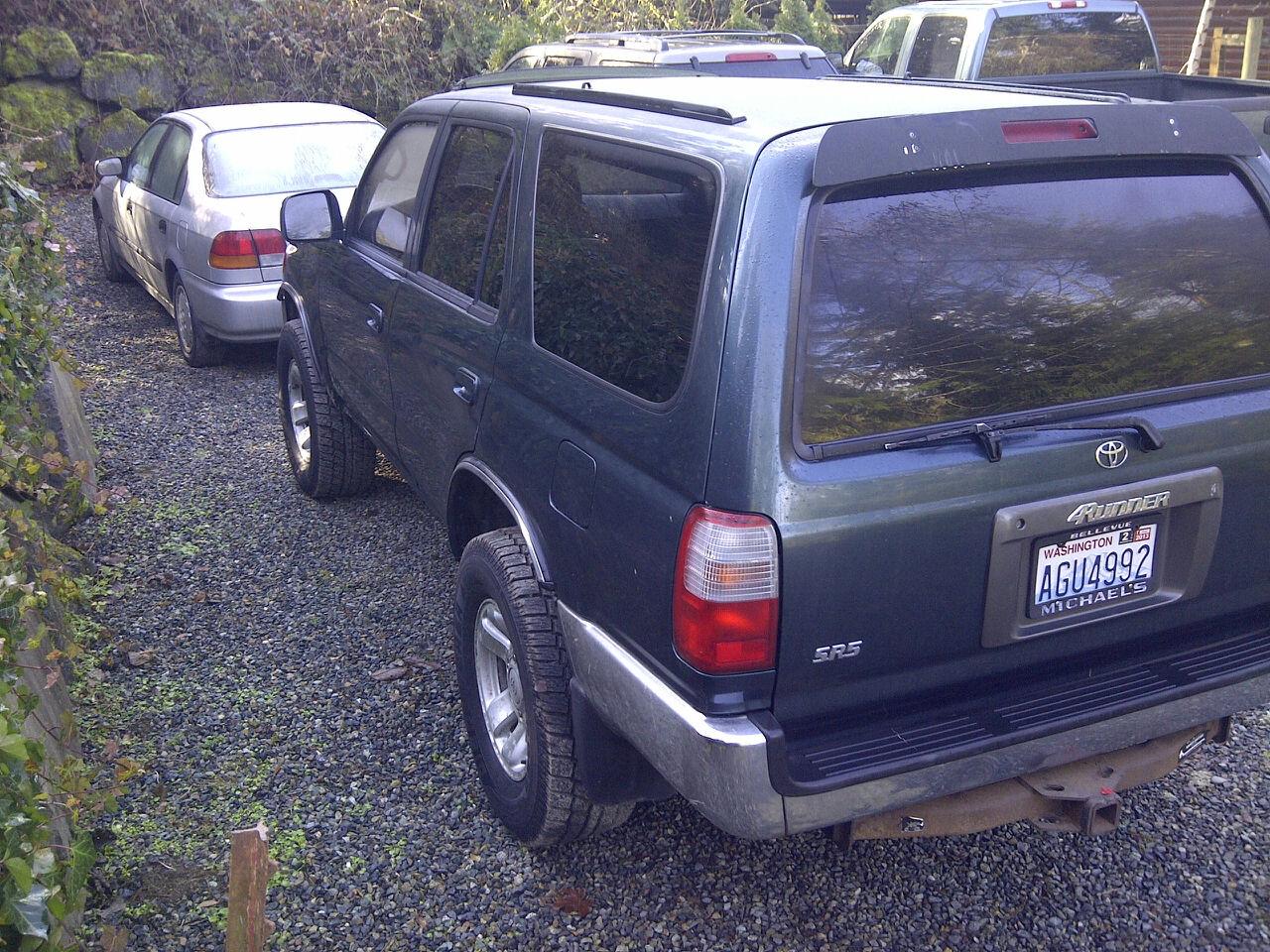

I recently purchased this 1996 4Runner 5-Speed with only 150,000 miles on it. It is completely stock and was used by a mountaineering guide so it does have a little bit of rust on the hitch from salt on the roads, but overall, the body/frame is a fairly clean and rust-free. From a mechanical standpoint, it wasn't abused, but at the same time, it wasn't babied and taken care of. It still has the original timing belt in it. Oil however was always changed as were the rest of the components.
My first course of action is to change all of the fluids, timing belt and waterpump. From then on, I am probably going to take some time to clean it up and make it look all nice again before I get it dirty.
Attached Thumbnails xcfunrunner's 1996 4Runner Build-Up Thread-018.jpg   xcfunrunner's 1996 4Runner Build-Up Thread-021.jpg   xcfunrunner's 1996 4Runner Build-Up Thread-022.jpg

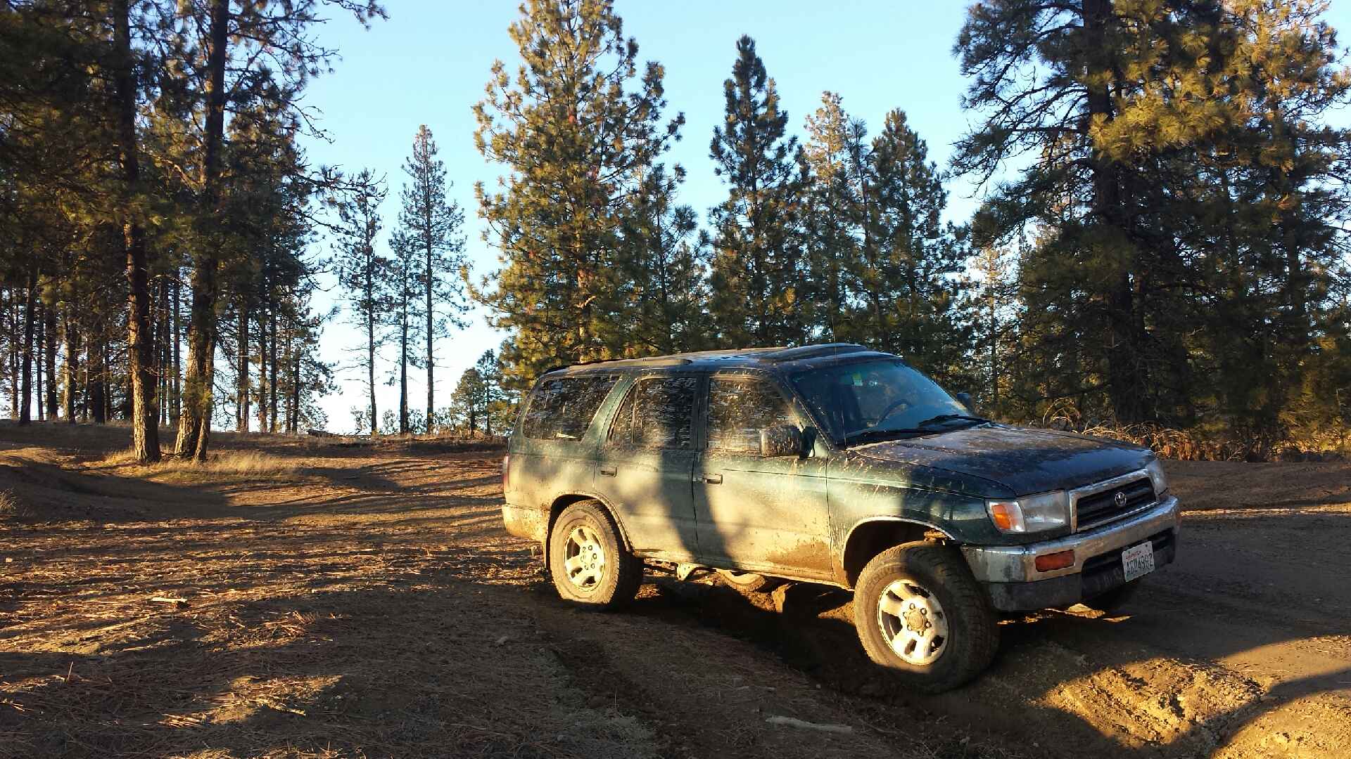

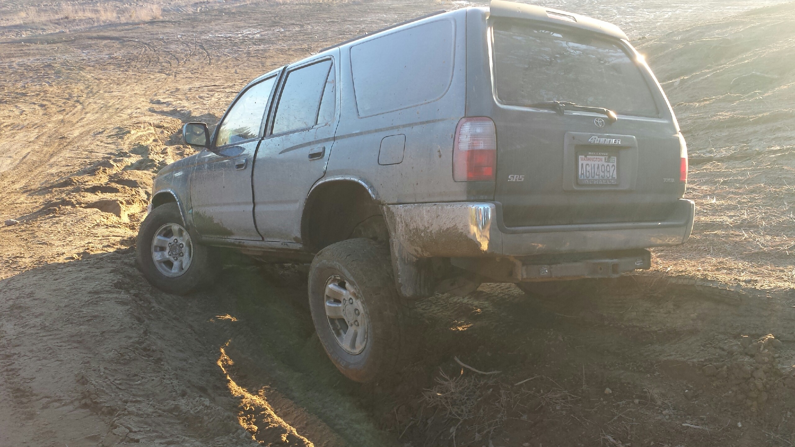

I recently got my spartan locker installed. It is AWESOME! The pictures I am posting are with the 4runner all flexed out. Like everyone else says, I can go everywhere I could go before in 2x4 now. When it is wet outside, I can go even more places than I could before when it was dry! The total install took me about 6 hours with a buddy. However, neither of us had ever done gears before. It probably would only take us half the time if we knew what we were doing.
WARNING! If you use the Chilton Shop Manual, do not use the 54 ft*lbs recommendation for attaching the rear 3rd member to the axle housing. I was torquing down the rear diff in increments and at about 30 ft*lbs, I snapped off one of the studs. Instead, I just torqued down the 3rd to 18 ft*lbs as if my 3rd had the e-locker. So far, no issues with leaking or things rattling around.
As far as wheeling goes, the 4runner is great! Apart from the really big ruts and hill climbs with large boulders, it goes everywhere I want it to go. The traction on snow tires right now is still great!
