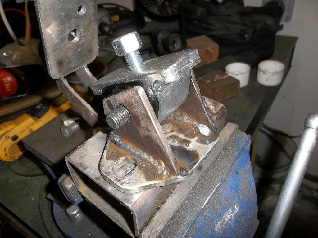

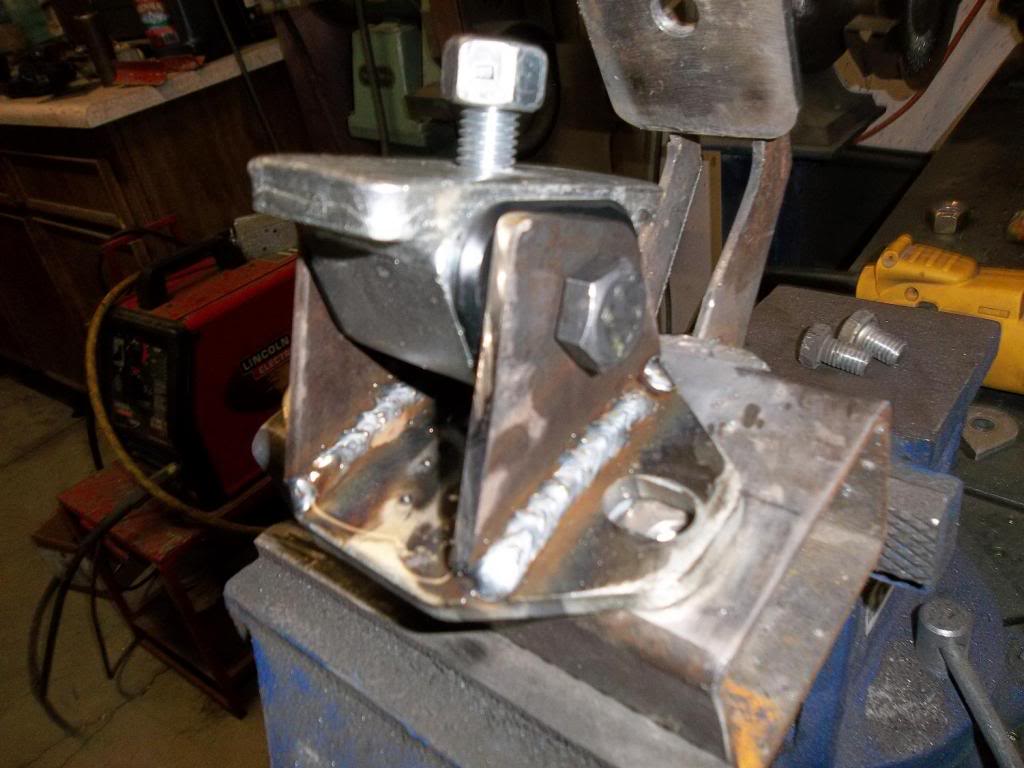

Well, the fix trail gear came up with showed up at the door step yesterday and ended up not working. So I built myself a hybrid motor mount combined with their parts and some of my own.
IF ANYONE IS THINKING TO RUN THE TRAIL GEAR MOTOR MOUNTS AND SEES THIS, BEFORE YOU DO MAKE SURE YOU HAVE CLEARANCE TO DROP YOUR MOTOR ABOUT 1/2"-3/4" WITHOUT INTERFERENCE!
So anyways, I built these last night and got them bolted up in place. My goal is to button up the whole front end tonight and get it to the point where I just need to go buy fluids tomorrow morning and top everything off and possibly longer oil lines depending where I end up mounting the remote filter.

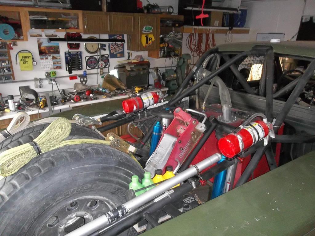

I cut out a ton of tubes and mounts for stuff in the spare tire area last night. I'm redoing all of that.

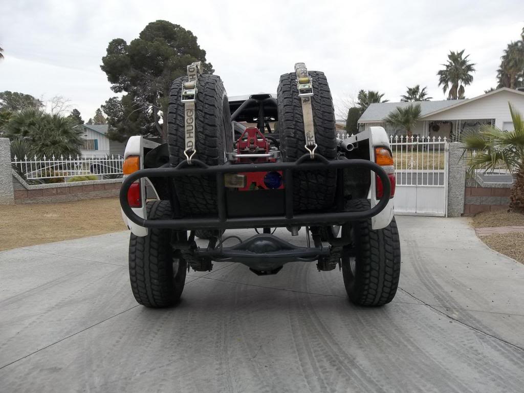

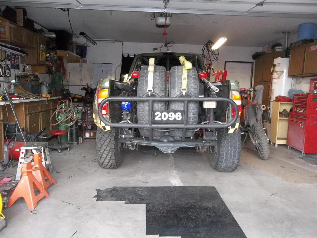

Not sure if we'll physically notice anything or not truth be told. Reason for it though... I messed up and set up the spare tire mounts for the nitto spares that used to be on the truck. They're a 35x12.5x15... I knew all same sized tires weren't physically the same size in reality but forgot that fact along the way. Well turns out the nittos are about the narrowest tire in that size we could've got so virtually any other tire was too wide to drop into the spare tire holders. So that forced us to have to address it no matter what. On top of that, Jason cosmetically didn't like how high up the tires sat so I figured if I was having to make changes, might as well suck it up and do it all at once. Above is the results... As far as COG and top heavy and will we notice it... No clue but it really can't hurt that's for sure!
