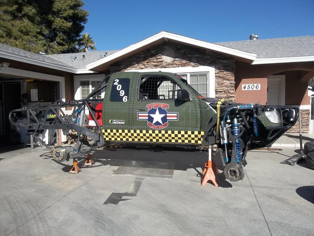

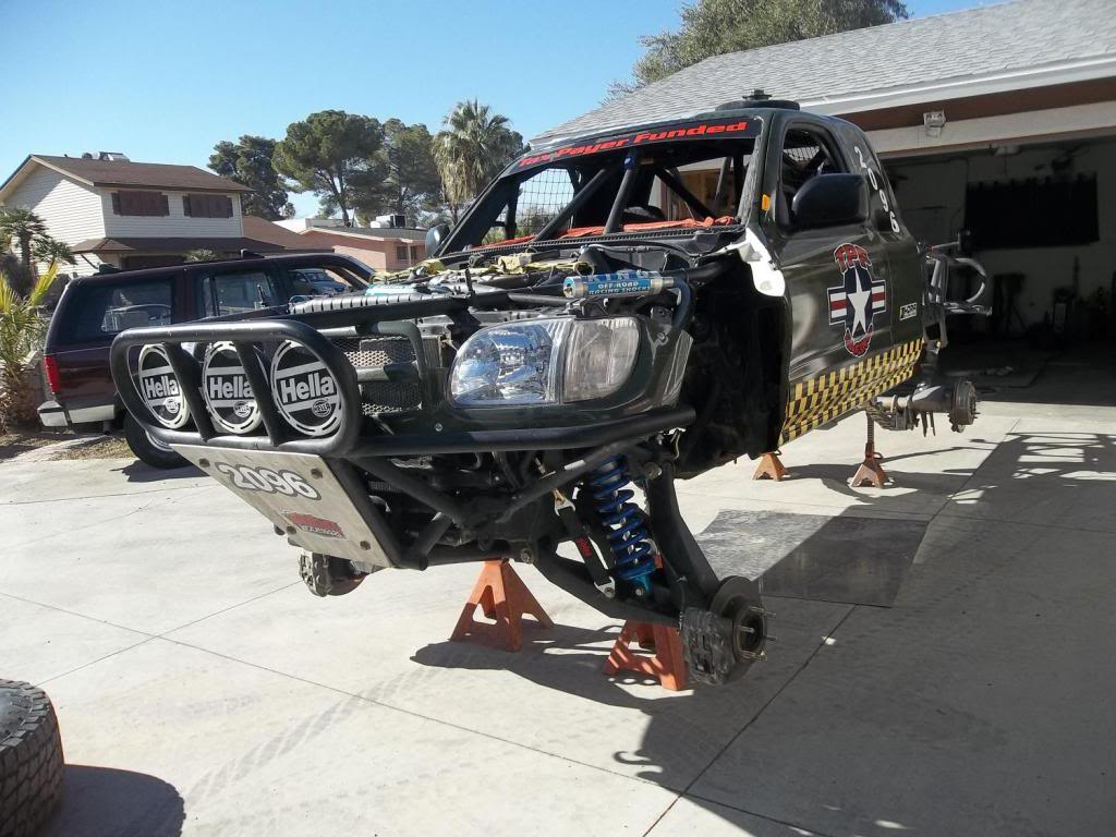

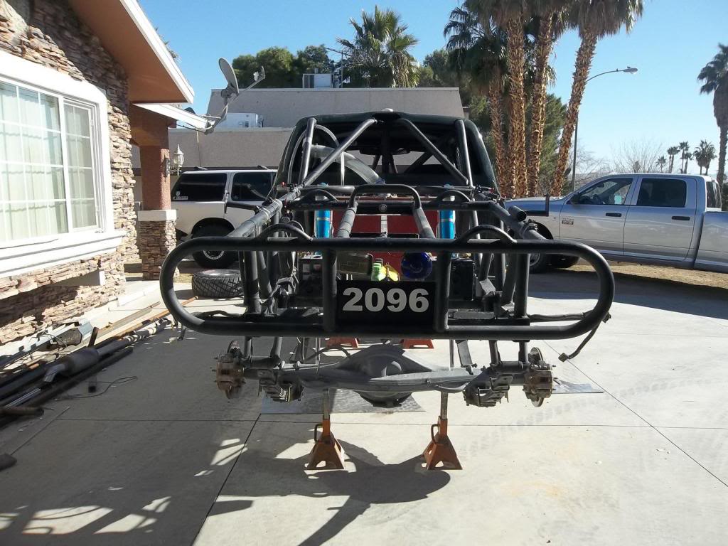

Well starting tear down for fixing and full prep. At first glance it looks like virtually the only piece I didn't do any work to is what failed. The frame horns for the motor mount area, I plated those and put some extra strength in them. I built my own motor mounts which I wasn't 100% happy with but those looked to have held up too. The stock metal bracket that bolts directly to the block and the motor mount itself though looks to be what failed. If that's the case I guess I'll be putting some extra metal in that.

Motor should be out of the truck tomorrow and hopefully down to just bare chassis by end of the week. The interior is already 100% out of the truck and I will be making some minor wiring changes in there and also be working on some storage areas for tools and spare parts.

I guess you need linger jack stands lol the front looks like they are extended all the way and the rears are supporting axel not frame!! I love this truck!! Glad yall had a good race and go figure theone part you didnt modify is what broke!! Oh well.. honestly though this truck looks almost as good stripped as it does put together nice job!!

I actually have taller ones and another set that's in between what you see there. These just happen to be what I'd grabbed to use...
