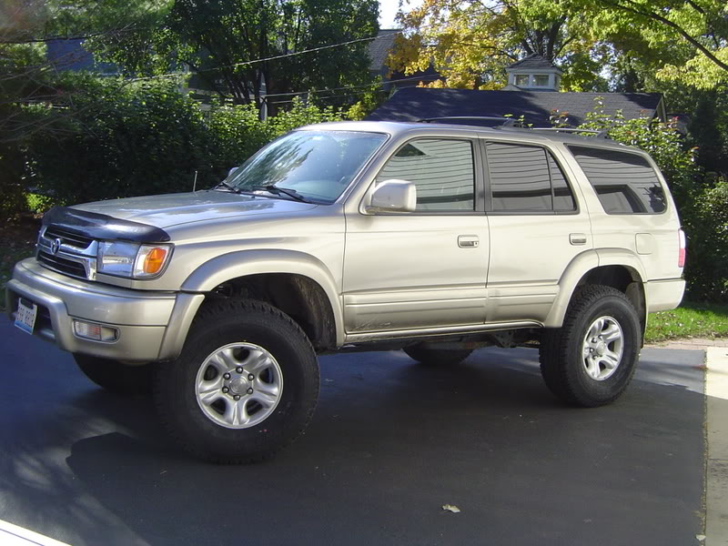

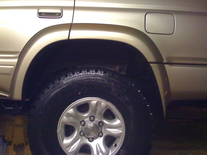

Then came the Sonoran Steel System 1.2 suspension lift and Yokahama Geolander AT-S 285/75/16s.
[IMG]http://i36.photobucket.com/albums/e21/EricJLindholm/dirtyrims1.jpg[IMG/]
I did need to run 1/4 wheel spacers with this set up to keep it from rubbing on the UCA. Then i had to trim about 1/4 in off the fender flare on the inside front of the front wheel wells. no rubbing after that.

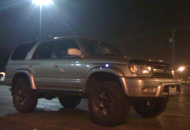

Shortly after came the Budbuilt Skid and Belly Plate. There is no way to describe how tough this product is.
I then added a 1 inch 4crawler body lift. This is another high quality product. It makes things a million times easier to work on and run lines. there was no safe was to run my transcooler lines before the body lift. it gives my wheels a little more room to flex. see this post for a list of things made easier by a body lift. I also did polyurethane body mount bushings from 4crawler at this time. I would recommend this when doing a BL to help keep a solid feeling ride.

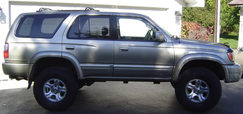

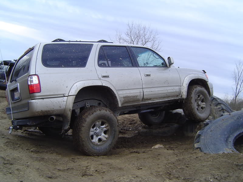

Here is a pic with the sliders welded on. The body lift allowed them to go on nice and high on the frame. These are the Stubbs Welding HD with no Kick out and the 15 degree bend. another great company to work with.
the only thing different from the pic above is i now have 1" wheel spacers. love em.
