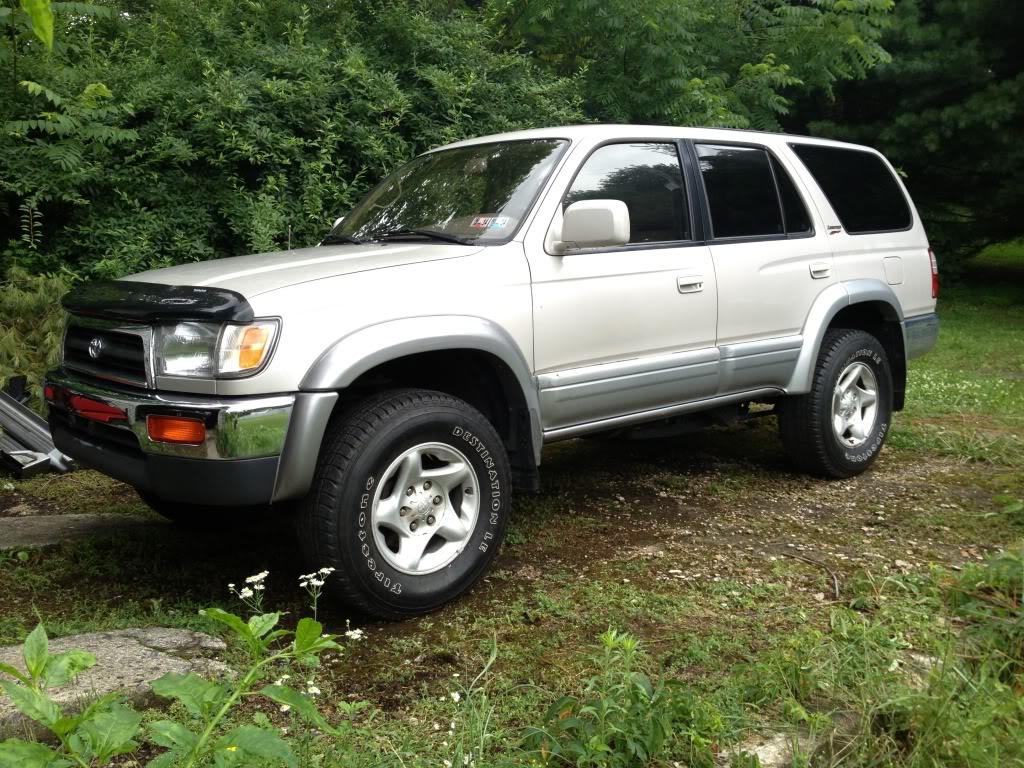

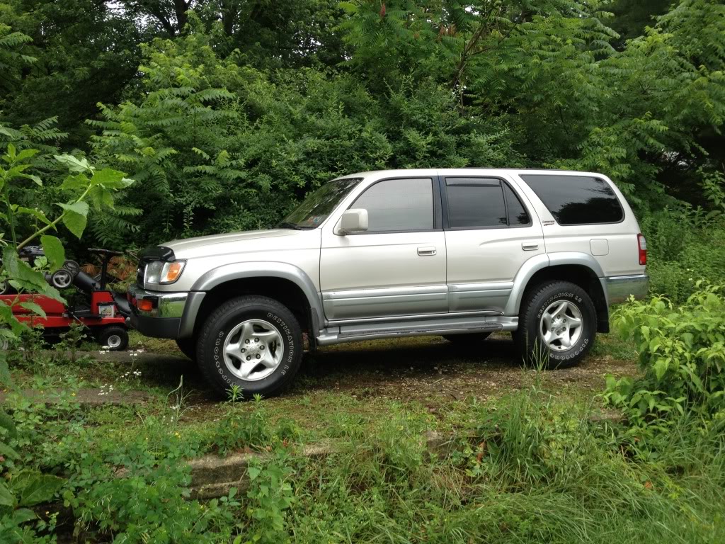

Put on some better wheels, next step, removing the running boards.

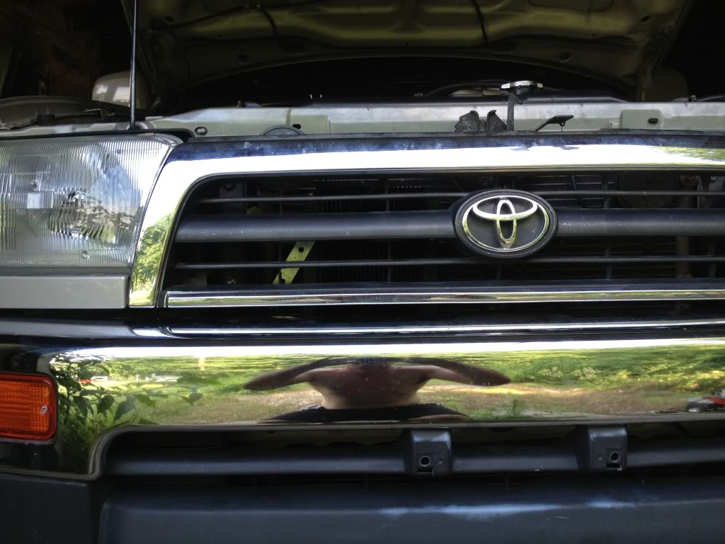

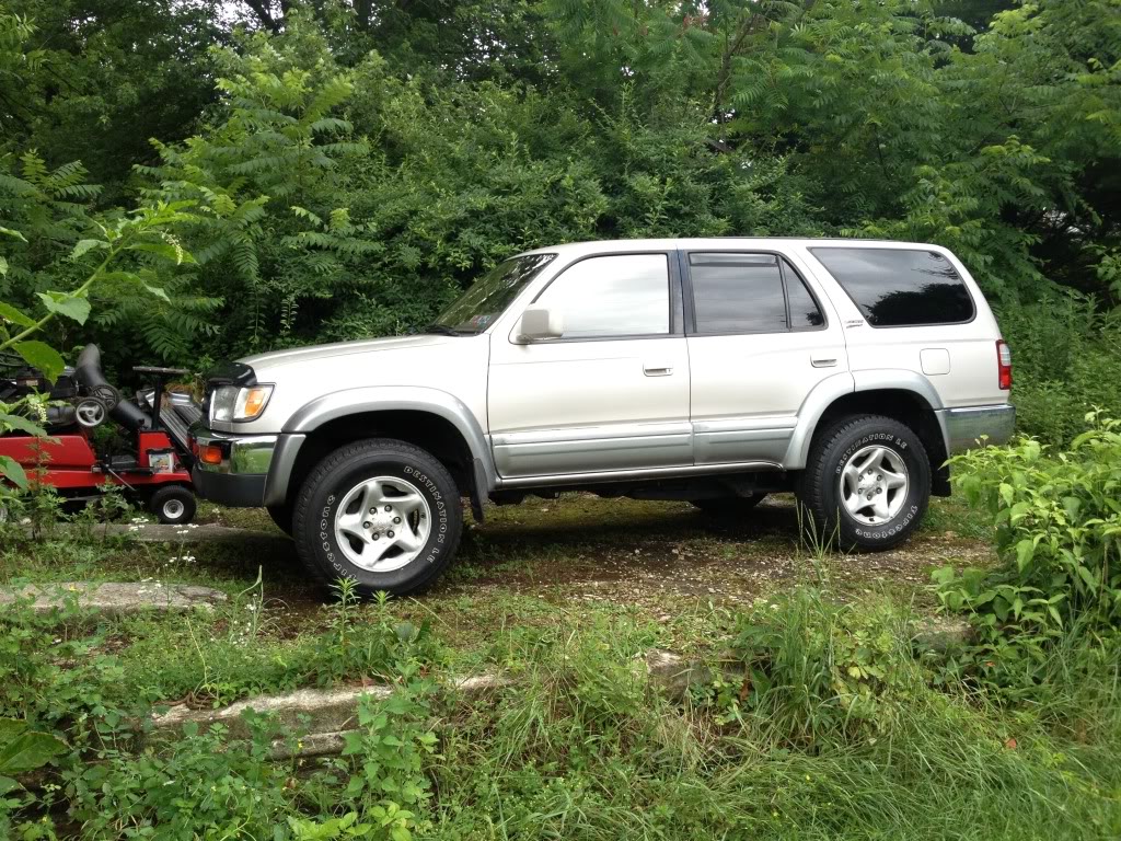

Ordered my B&M 70264 external trans cooler today, avoiding the pink milkshake at all costs!
Also removed the running boards, looks a lot better!

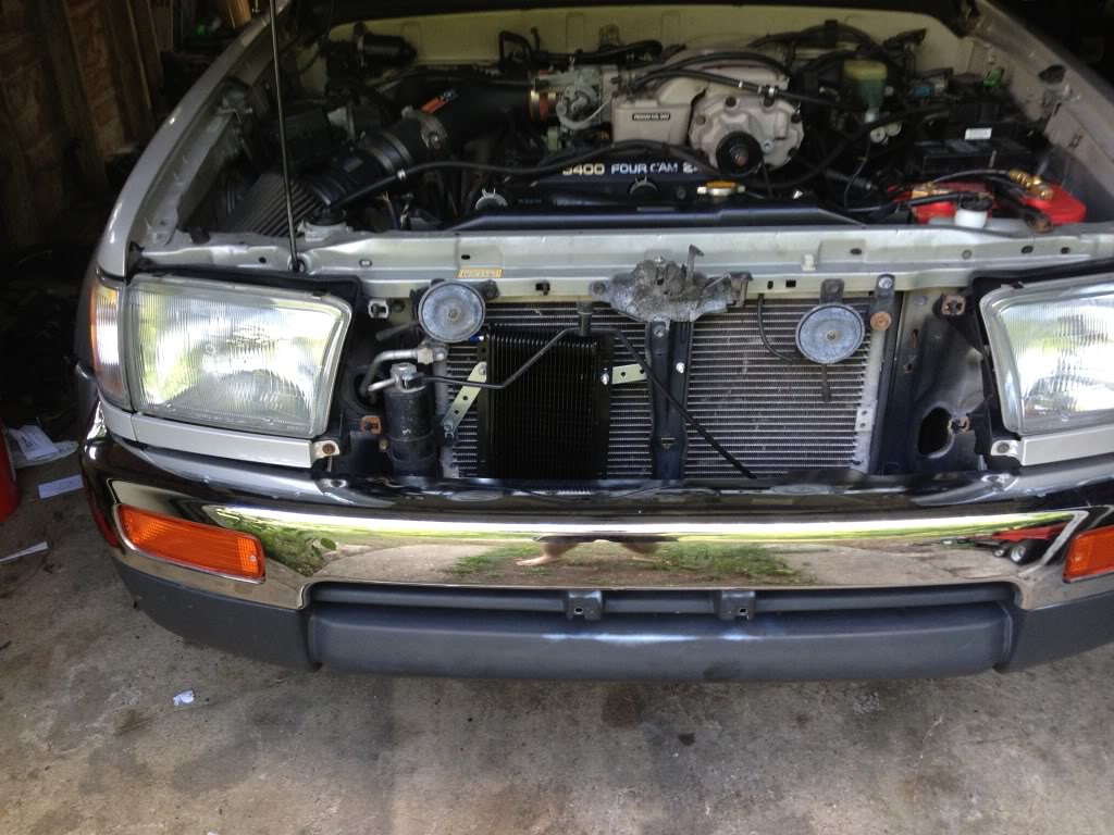

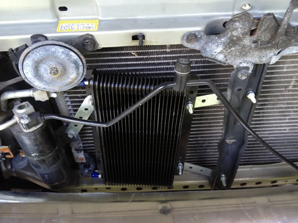

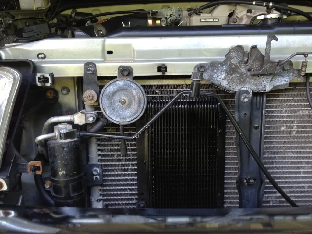

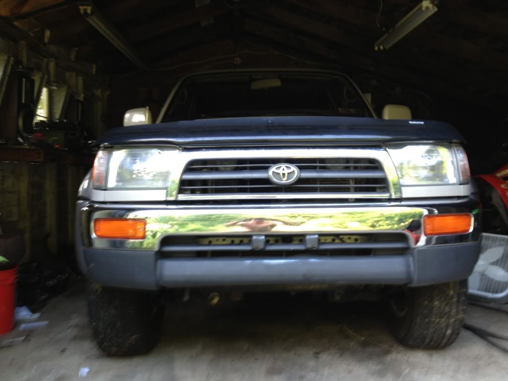

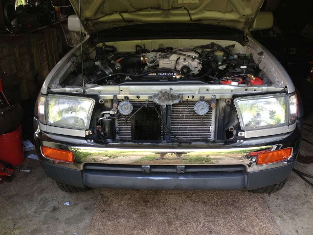

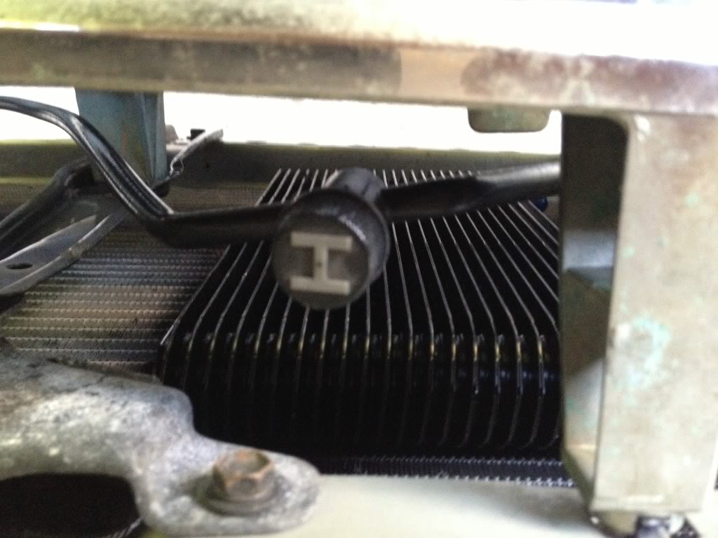

Got my B&M 70264 aux trans cooler today! Installed it and I will be plumbing the lines tomorrow as well as doing a trans drain and fill.

Here's how I originally had mounted it, but I decided I didn't like it that way. It looked bad and was noticeable.
I then used the special zip ties they had included which push through the fins of both the radiator and condensor to mount the trans cooler. Much easier and much cleaner, the install is very solid.

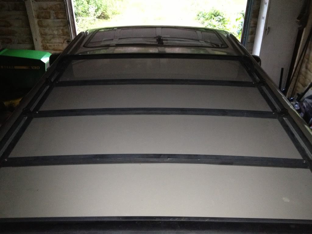

Went to the junkyard and found 2 3rd gen 4Runners, both were stripped pretty good (no engine, trans, diffs, most interior parts gone, etc) BUT I did find a roof rack! $12 and it was mine.
