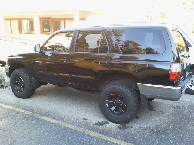

New Tires

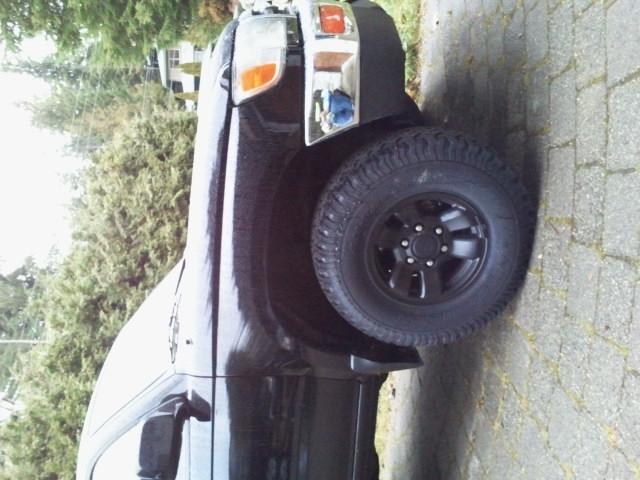

Alright got my new BFG A/Ts 31x10.5R15. Gotta fix up my rims now because of the weights but I think it turned out good and it fixed my steering wobble at speed. The black out begins. Next rear plastic with license plate and grill.

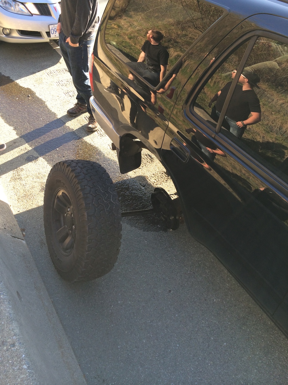

So I haven't been on in a while but recently my rear diff grenaded, tried H4 to get back to town and my axel slid out. Luckily I pulled over quick and stopped in time, but the housing was resting on the pavement. Was at the shop for 2 weeks, they found another housing and assy nearby and rebuilt the backend, can finally drive again! Feels so good.

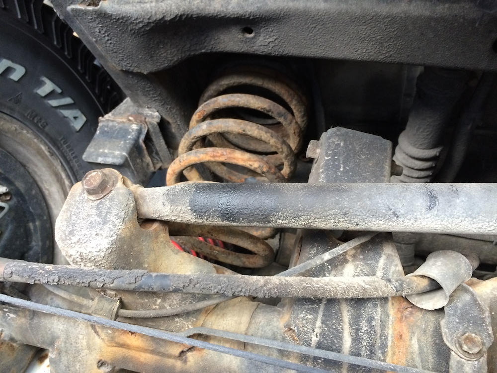

There has been a knocking when I hit small bumps and I found that my rear trac / panhard bar was loose at the bottom end because the bushing was worn down. So I ordered a Sonoran Steel adjustable one, just waiting for it to arrive. Hopefully that fixes up my slight wobbles/shimmy and makes everything feel solid.

Old May 6, 2014 | 01:45 PM
specialblend's Avatar
Joined: Sep 2013
Posts: 42
From: Whistler, Canada

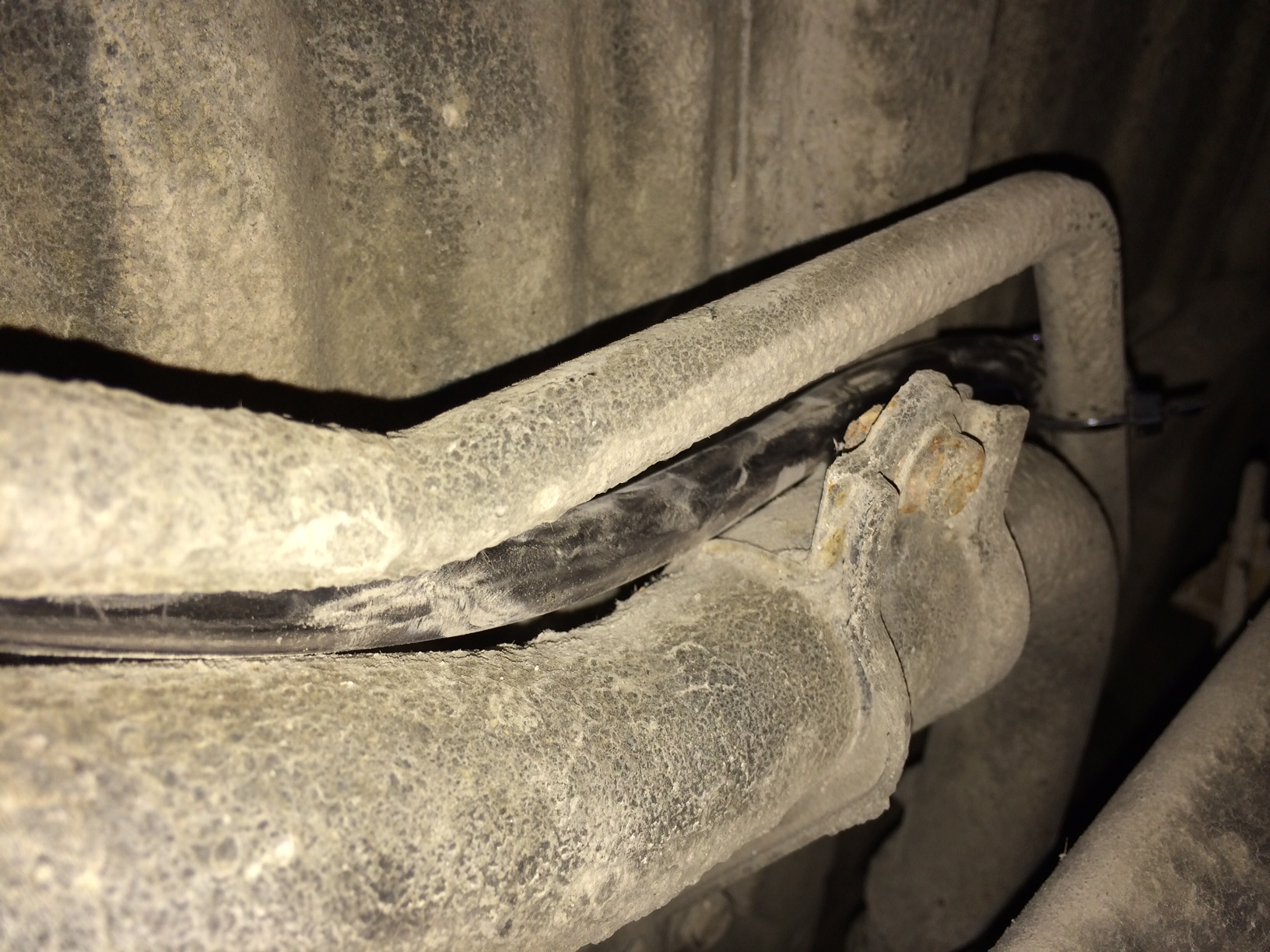

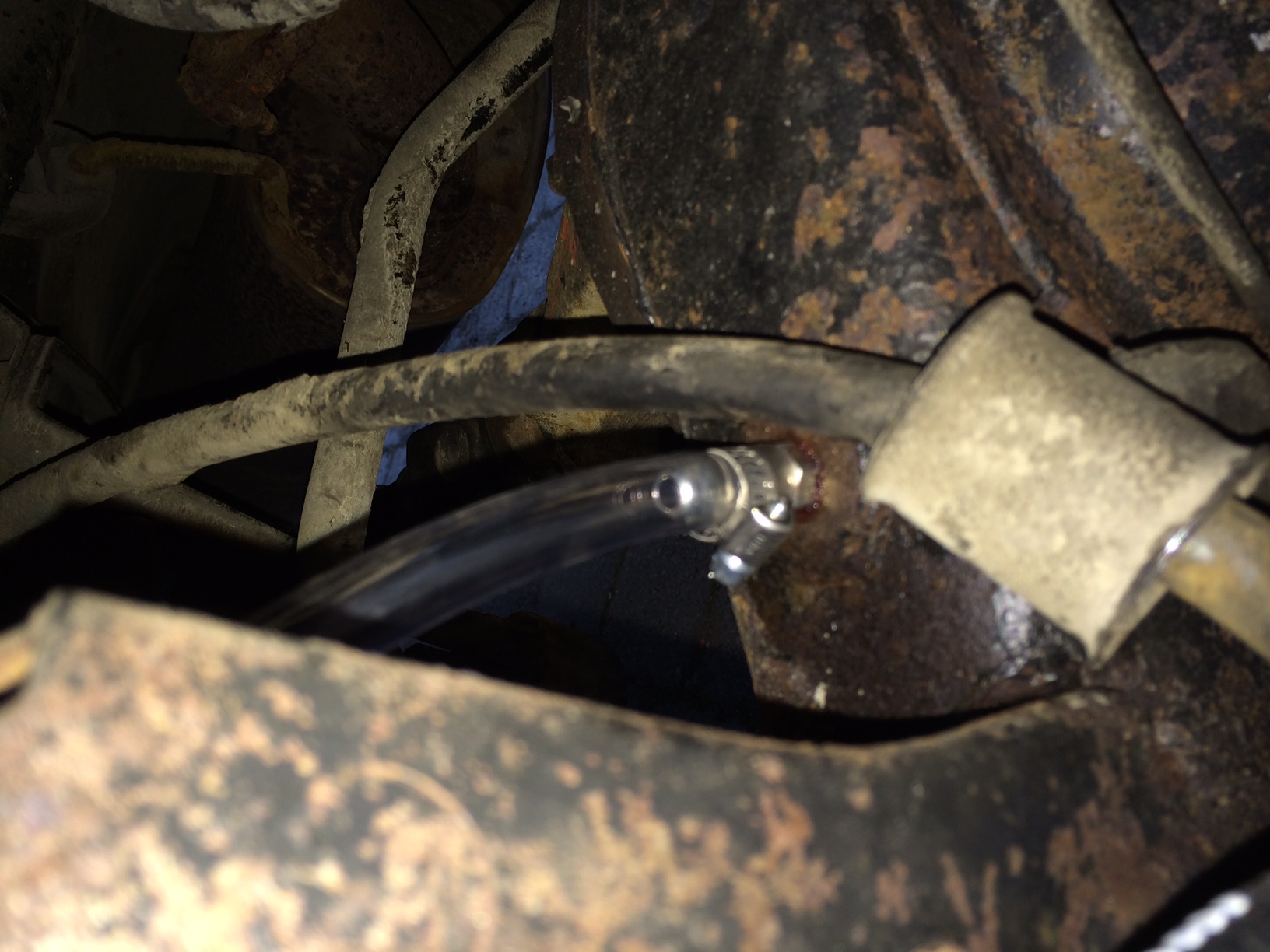

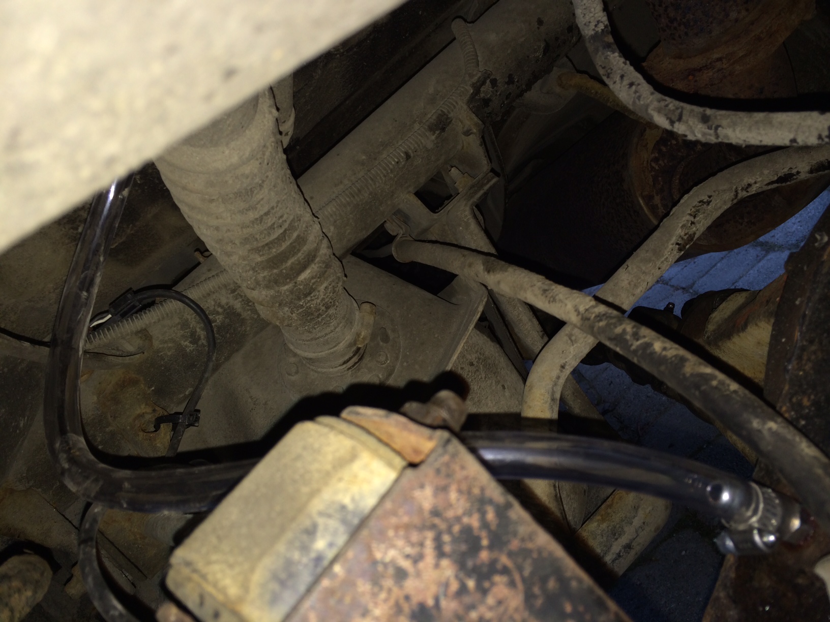

So got the rear diff breather mod done today. Here are some pics of how it turned out.
Union attached to diff, clamped on hose.
Gave it quite a bit of slack for movement. Wasn't sure exactly how much but I can always tighten it up a bit if it hits anything.
Zip tied up along fuel filler tube.
I managed pull out most of the rubber wall around the fuel fill tube and mount the breather to the tube just behind the rubber so it's not pressed against anything and is pretty secure and out of the way.

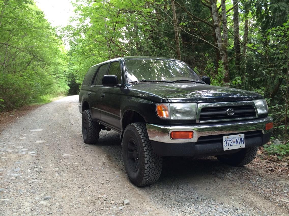

Finally got to do some off roading now that the runner is solid again. Took a few pics
